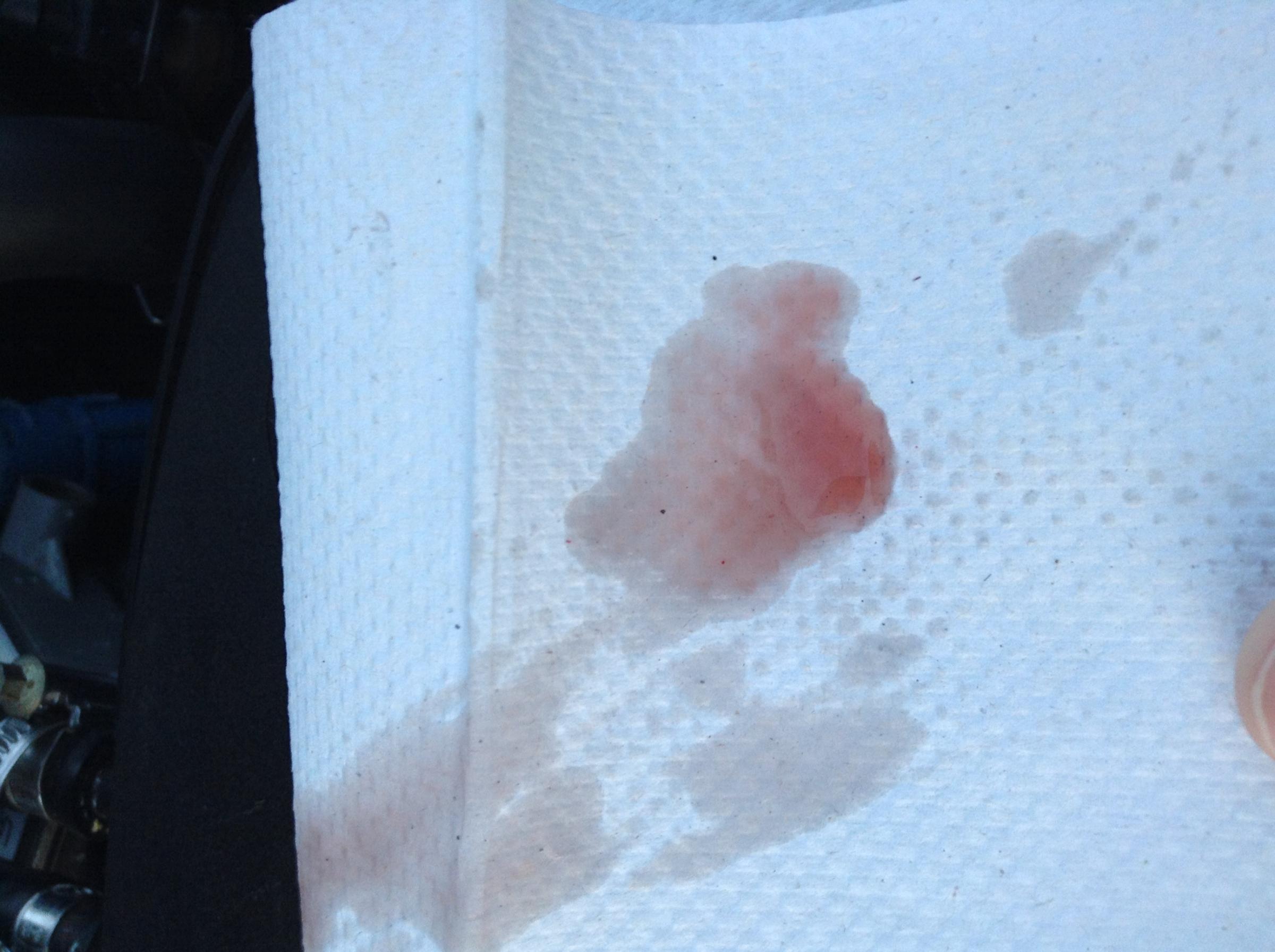

I've noticed (mostly when the car is cold) that I'm getting some pretty firm, harsh gear shifts, both upshifts and downshifts when braking to a stop.
The car has 60,000 miles and the transmission fluid and filter was changed at 54,900 miles. The oil is nice clear red, and smells brand new.
The only issue I see is that the fluid level looks too high, after driving the car on a long trip (250 miles) I checked the fluid on level ground in park with the engine running.
The fluid was practically covering the entire white plastic end of the dipstick, which is about an inch higher than the HOT MAX line on the dipstick, and about 2 inches higher than the HOT MIN line.
It was a small shop that did the job, and I have a feeling they just drained and refilled the transmission instead of flushing it to get all 10.8 quarts replaced?
Would too much fluid cause harsh shifts? The oil isn't foaming from it, but I don't want to cause any hard part failures with such hard jerking shifts.

Nick,
I seriously doubt that fluid level is your issue, as these old style transmissions are significantly more forgiving that the newer so called sealed units.
If the harshness has developed since the intervention of this guy, I would suspect the specification of the fluid used is causing the problem. If it was harsh prior to his fiddling, then NO.
I run Synthetic ATF (Multi vehicle ATF) in all mine, and have done so for about 15 years now, with no ill effects. My X300, same trans as yours without the electronics, has benefitted significantly from this Synthetic fluid. Nice and smooth, up and down.
My suggestion, therefore, is to drain this unit, either via the drain plug (if fitted), or simply undoing the dipstick tube nut, and refill with fresh fluid of your choosing. If this sorts it out, great, if not, maybe an electrical connector issue, but that is something I have NO idea about.

Thanks. I purchased the car with about 57k on it, and that transmission change was done about 3k miles before I bought it, which was July 2011.
I was interested in finding out if synthetic fluid could be used in these transmissions.
My Oldsmobile (which originally was spec'd for Dexron III) and all other GM vehicles of the time, had a TSB which recommended the use of Dexron VI which is fully-synthetic.
In the TSB it listed the improvements (Over Dexron III) as:
-Clutch Friction Stability: Improved 100%
-Clutch Durability Due to Fluid: Improved 120%
-Oil Film Thickness: Increased 20%
-Fluid Oxidation: Improved 100%
-Foam/Aeration: Improved 120%
-Shear Stability: Improved 200%
I was just wondering if the synthetic would have a detrimental effect on the seals.
I was also thinking about buying a cheap used Transmission Control Computer to see if maybe it was a computer issue.
I did suction out about 3/4 of a quart of fluid from the dipstick tube last night. I drove the car and it shifted the same. Once I got back, I double-checked the level and it was right between Min and Max on the dipstick.
