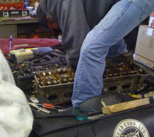

Just pulled the head off mine this afternoon.
It was fun! Except for the bloody knuckles etc...
If you confirm that the hg is the problem have at it, especially if the rest of the car is in good shape.

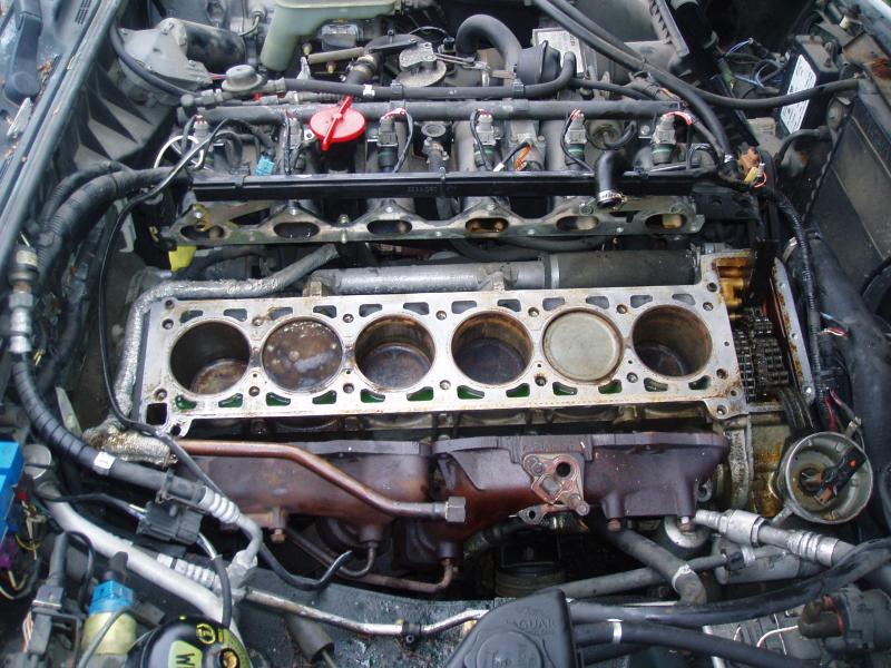

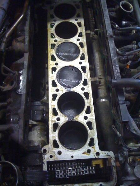

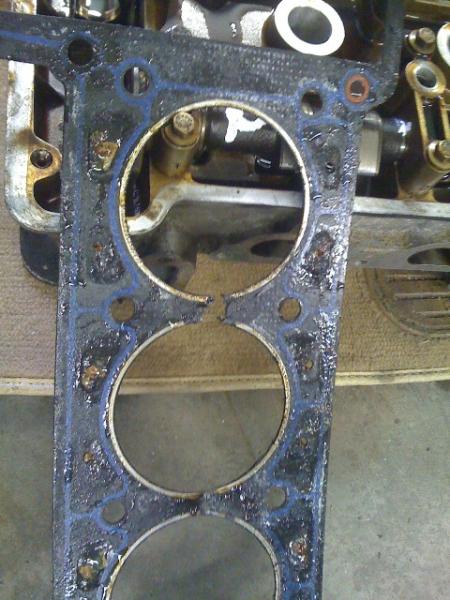

For those of you who said, "head gasket," you win!
There it is plain as day. All the things that can run through your mind about what the problem could be..etc. the only way too find out is to take that head off.

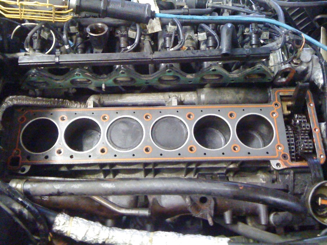

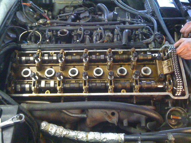

As you can see, when you don't have a hoist you do what you have too.
Pics: New gasket on, putting the head back on.
Job is complete. It runs great. Gasket $58, beer for friends assistance $100
