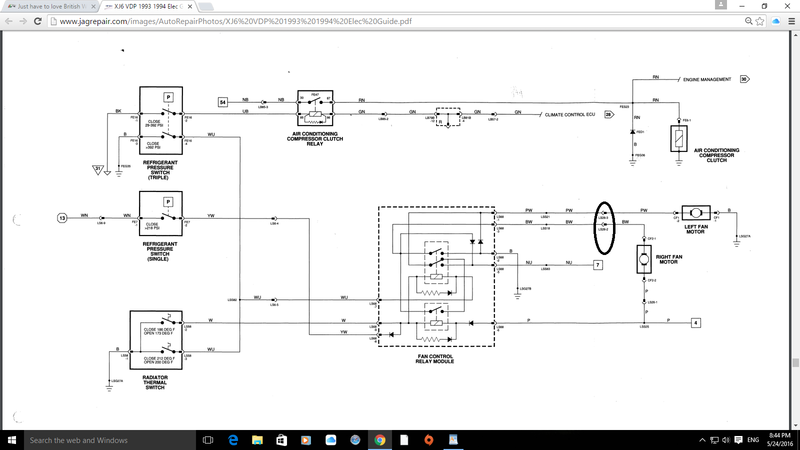

Even without A/C the fan should come on. With the A/C on the fan will come on sooner to pull air over the condenser to help with the operation of the A/C not so much with cooling the engine.
There is a thermal switch that will turn on the fans via the fan controller and the pressure swithces will do the same thing seperatly
