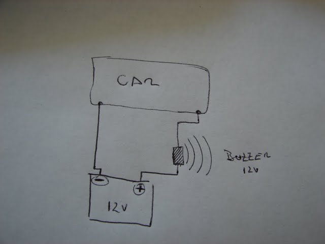

i have a battery/electricity leak. The car runs fine, but as soon as I turn it off, within a couple of hours my battery is drained. For that reason, now a days in order to use it, everytime I park my car, i have to disconnect the battery.
here is what i have done:
1-I have replaced the battery for a new one ( totally charged) so battery is not the problem.
2-I have connected a Buzzer -in line- to "hear" the battery leak in order to narrow down the problem (see picture attached). After that I have removed all fuses (ALL fuses) from the 3 fuse boxes i know my car has: passenger side, driver side, center (below the central arm rest), even though the Buzz sound is still there, meaning the leaking is still there.
.........no progress so far, any idea how to follow ?
what circuit in the car is NOT having a fuse in it ?
where could the energy drain could be ?

You have an ampermeter on your gauge cluster . So, what's reading when stationery and departure ?
I think you need a new alternator

you were ABSOLUTELY RIGHT !!!!!! , as soon as i disconnected the Alternator, the "Buzz" went off as long as the electricity leak....
so.. now i know i have to change the alternator.

ok, i have changed the Alternator, everything works perfect now, there is NO energy leak !!!
Thank you Ken and Cadillac, you guys are GREAT !!!
