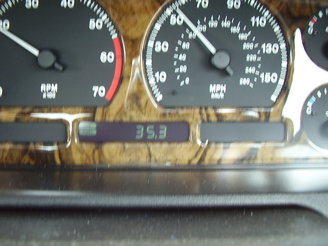

around town driving (U.K) i get around 20-23mpg, dependant on how i drive, but on motorway/highway driving, i get around 30-35mpg. i even took a photo once to prove it
Wow! I guess you don't have an emission control system on that rig?
i would imagine there are many factors though, that dictate the figures. regular servicing, tyre pressures, boot/trunks, full of tools and junk or not, driving style etc etc.
i think the cars with poor mpg are in the minority on these cars from what i`ve read over the years. i`ve actually been surprised by just how many obtain 30+ mpg on highway driving. i have to say though, mine is maintained, engine wise, to an almost `anorak` standard!
i even managed to find the photo i took;
