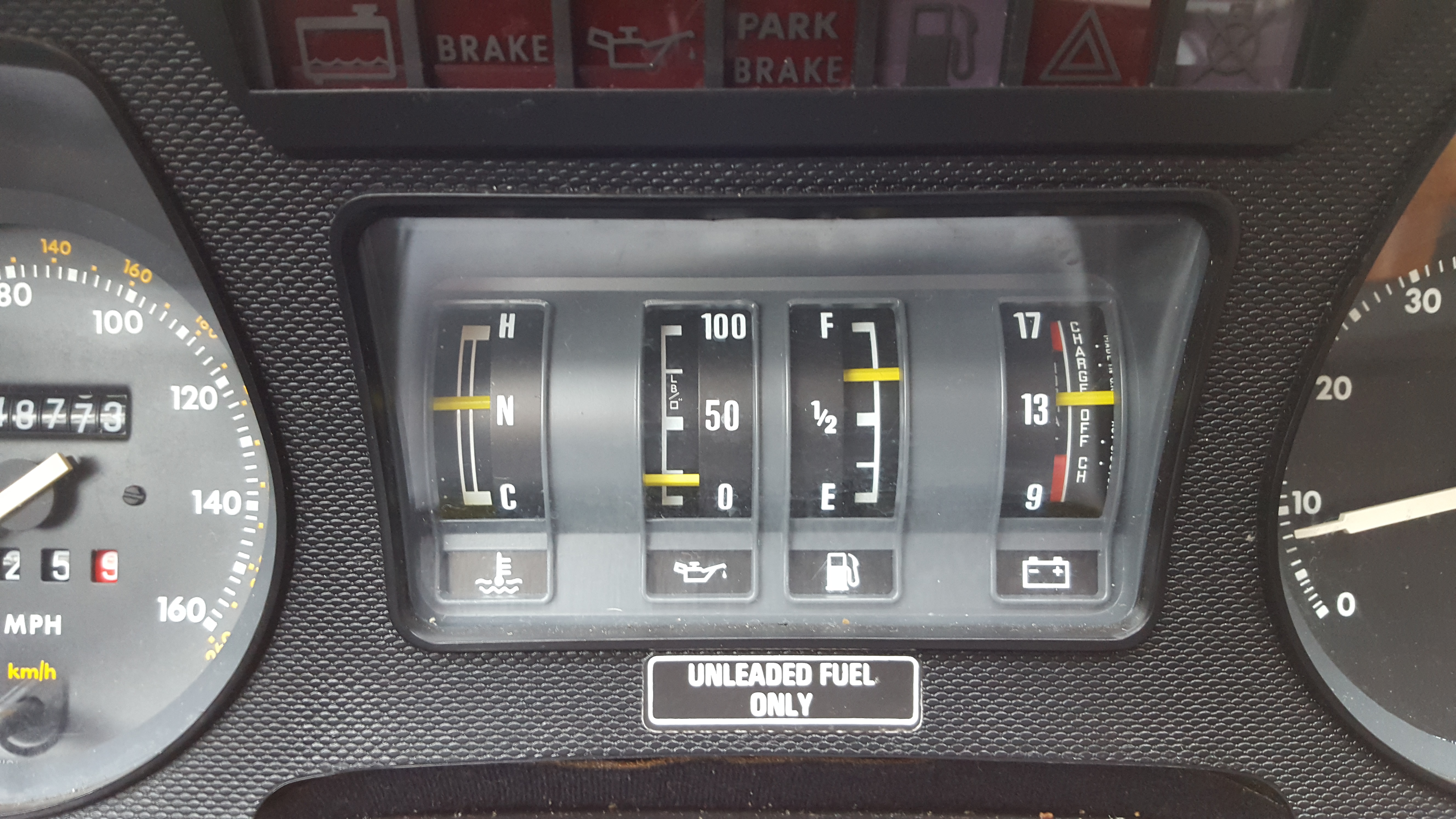

I took my new XJS for a 30 minute drive today. After 30 minutes of driving I went onto some streets with stop lights after a few stop lights the temp climbed a little. Not really knowing this car yet I am not sure what is normal and what I should be concerned about. These are the things I was noticing:
1) The temp climbed above the N but did not get to the H. Is that normal after driving it on the highway then waiting at some stop lights? Pictures included
2) I filled the tank and found the gas gauge only went to 3/4 of a tank. Is that normal behavior for these? I am thinking probably not.
3) I noticed while idling at lights or just idling the oil pressure looks pretty low. Picture included. Is this pressure normal or is this a concern?
Thanks in advance for advice from experienced owners.

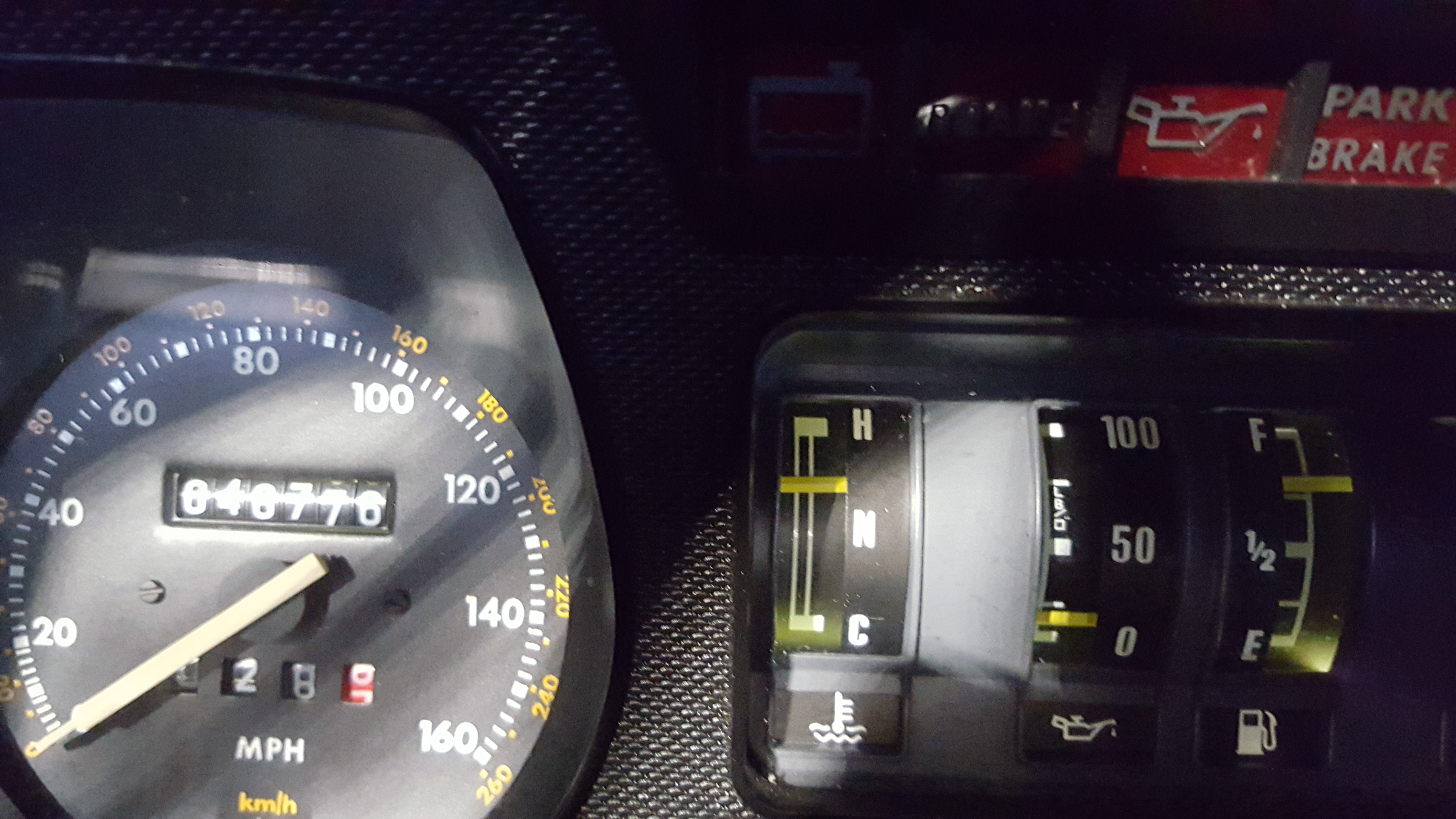

A couple more pictures
Not normal and should be attended to right away. First suspects would be a fan clutch or radiator needing attention.
Unsure. Never been an issue for me, but you may have to fill up a few times and see what is normal. On the convertible with the Lemans type cap, the auto-shutoff on some gas pumps will go off before the tank is full.
That's typical, I believe there is a section in Kirby's book about that.

Oil pressure looks ok for idle, it should go up with revs.
Fuel gauge - mine does this most likely the sender in the tank is bent.
Temperature - I would attend to this. ALL V12 jaguars that have not been maintained will overheat. I agree with Mac that first suspect would be fan clutch. You can test this with a warm engine FULL UP TO TEMP, lift the bonnet and have someone turn the engine off the fan should stop almost immediately, if it spins its bad.

The fuel gauge is reading low probably for one of two reasons:
The sender in the tank (behind the spare wheel) is getting lazy, or
The actual gauge is getting very slightly corroded. The Palm book is very good on the gauge and how it worked. MY gauge never was really Ok until I took it all apart and did the Palm cleaning procedure.
BUT I do not recommend doing this until you have done everything else the others have recommended, as the dash stuff is very delicate and you can create more problems than you solve. Particularly pulling out the rad and renewing it or cleaning and checking it anyway, renewing the fan clutch, renewing the hoses. Overheating is about the only thing that will destroy a V12 mechanically. If you do need a new rad, the easiest thing is to get your original recored.

Based on my limited experience and reading only - my oil pressure goes real low at idle also, not as low since I started using 20w-50 oil but still looks low - from what I've read that's pretty normal. (my Harley was like that too).
That temp is higher than mine ever went but as others have said these gauges can't be assumed to be accurate. I wouldn't panic but do agree getting the cooling system to a known good condition isis a priority. Maybe even more so with these jaguars but I've been through that with other cars too and its time well spent too get it right.
