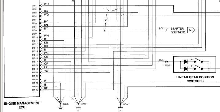

The following schematic is the wiring between the ECU and the ignition amplifier for your car. In order to make it legible, I had to split it in half.
Color codes for wires can be found on my thread, Jaɡ‧u‧ər Electrical Wiring Color Codes.
Some pointers:
  • Diamond shapes 8 and 9 are ignition switched power, so with key on you should "read" +12 VDC to ground with your voltmeter. If not you have a broken wire or connection problem somewhere.
  • There appears to be a capacitor connected to ground at point LI26 on the Ignition Coil. If this cap "shorts", you will have NO voltage to the coil because it will be "shunted" to ground. If it is shorted you will probably see smoke as the wire insulation melts with the key on. If the cap is burnt open, it should be replaced.
  • a WB (white with black tracer) wire connects the Amplifier (LI25-C) to the Coil (LI27). Ensure connections are tight.
  • The Amplifier wire (LI28), which is colored B for Black, is connected to ground. Ensure it is a good ground.
  • The wires, WR (white/red tracer) and WG (white/green tracer), connect from the Amplifier to the ECU at pins LI2-1 and LI2-4.
ECU to Amplifier test:
Code:
  Pin  in/out     Circuit                 Active                InActive
LI2-1 out ignition drive    pulsed signal         0V
                           approx 0.6V@idle
LI2-4 out ign amplifier      key on: 5V        key off: 0V
explanation:
  1. With your voltmeter set to AC volts, you should get a 0.6V AC pulse with your probes placed on LI2-1 and ground while someone cranks the engine. No crank, 0V.
  2. With your voltmeter set to DC volts, the voltage measured at LI2-4 is 5V with the key on and 0V with the key off.
o

Hi Trick,
The reply you sent to me was really impresive and I was wondering if you could offer any further experise to help me solve the matter.
I have posted the results of the tests I have run.
Can I also say thank you soo much for the visual aides, they helped greatly when I was working on the car.
