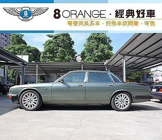

Now, is there anything you guys can add to the following:
1) The rims, I have never seen them before on a XJ family. Were they exclusive to a model, or aftermarket (perhaps even with an other bolting pattern)?
2) The vents in the bonnet: same issue. I have searched the net all over, but never stumbled on any vents in the bonnet other then after-market, and never seen this configuration. Anyone can shed a light on it?

Those hood vents aren't stock. My XJ12 didn't have them. Otherwise the car look in good condition for 1994 (20+yrs old car)

I agree that the hood vents are not original - I've seen quite a few XJ12s but never one with those vents. A quick google image search will probably confirm this.
Regarding the wheels, the originals were only 15 inch diameter, possibly 16 inchers were optional. The X300 wheels were 16 inch, and at least some X308 wheels were 17 inch. The ones on that XJ12 appear to be at least 17 inches or possibly even 18. They kind of look like one of the S-Type wheels, but I don't think S-Type or X-Type wheels will fit an XJ40. I suspect those wheels are aftermarket.
Otherwise that looks like a nice clean car in a very interesting color, and the hood scoops are kind of cool.

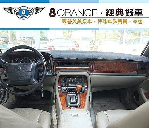

I particularly like the rug on the dash, wish my car had that.
btw 94's came with 16" wheels and those are as Don says, probably aftermarket ..can't say they drip elegance, look pretty brash to me, but on the other hand maybe match the hood louver schtick well.
Kidding aside, not a fan of aftermarket mods in any shape or form. Stock is king in my book.

Well, if I buy the car, then I will donate that dash-rug to this forum as a thank-you.
By the way, it is very popular here, and can be bought for almost every make and model, including present Jaguars ... I hate them though.

For the rest, I am also a sucker for originality, but rims (and other stuff where needed) can be replaced, and should be available here on the island. Just re-conditioned some 18" XKR rims for my XJ8, and they are like new.

The hood vents are suspect to me. To be sure they are not stock and may point to a problem with the engine running hot. If that car does run hot or has overheated you are best advised to walk away.
The dash rugs used to be quite popular in the States too - back in the 80's there was a guy at the Marin flea market in Sausalito that would make one while you waited!
I had one made for my Saab and have to say, hate them or not, if you were driving 2000 miles every 2 weeks as I was at the time, the increased visibility brought on by the lack of reflection was well worth it.
Overhead light reflecting glare from the dash to the windshield (especially at night) is totally eliminated with a carpeted dash - a big plus from a driving standpoint ...cosmetically, well, that may be a different matter!

I am curious about those vents. I like the idea IF they are functional. They look to be well done, and I agree that they could point to a problem, but maybe they are a precaution. Overheating is no secret for those......
