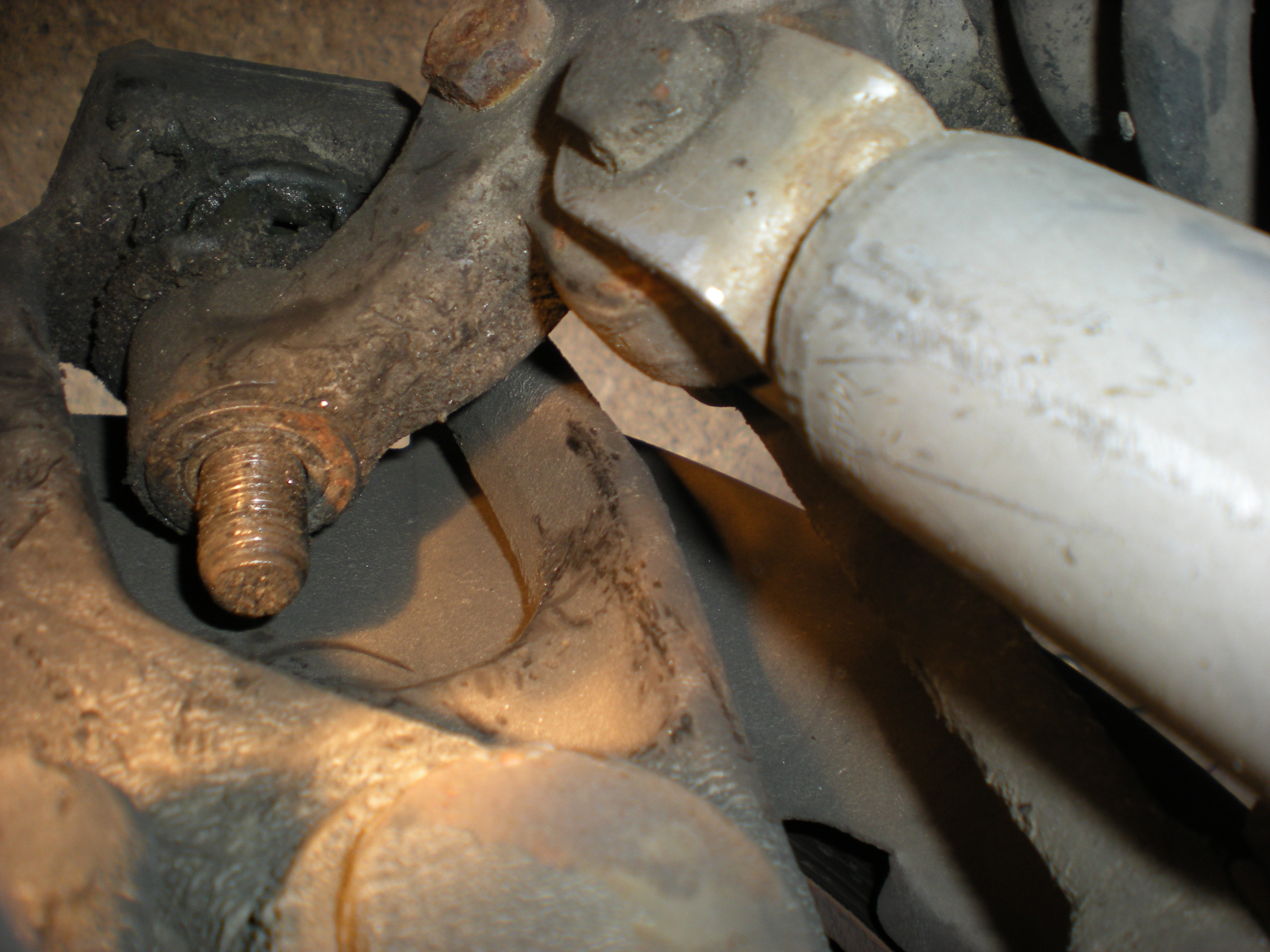

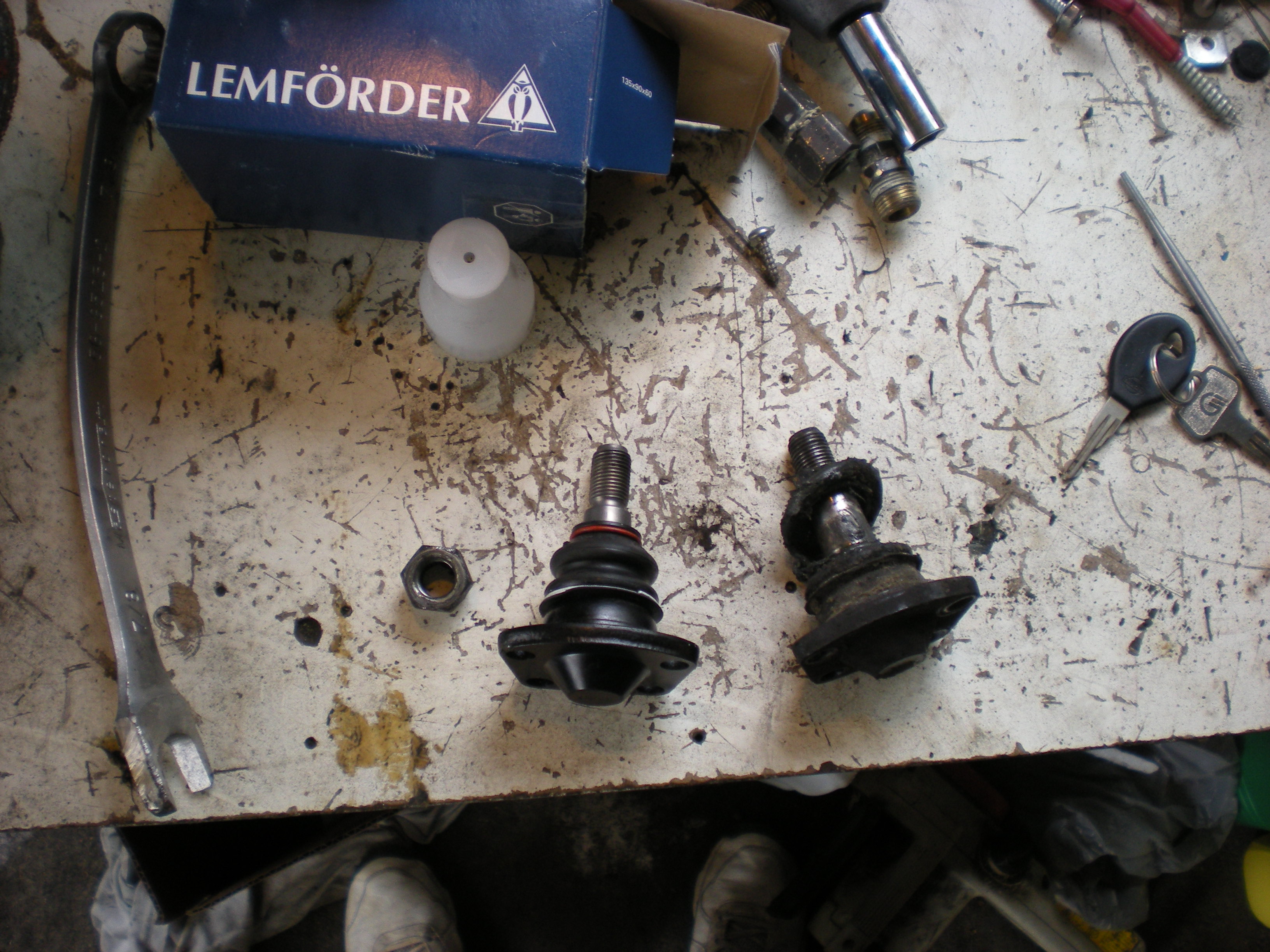

The other day I found that you don,t have to pull the brake/rotor assembley off to do lower ball joints!
You do however need to modify a wrench slightly
After a hard winter,Cin,s car needed these parts as the boots were pretty tore up!It took about three hours,for both sides,having just done new wheel bearings,I did not feel like re-doing this job.
