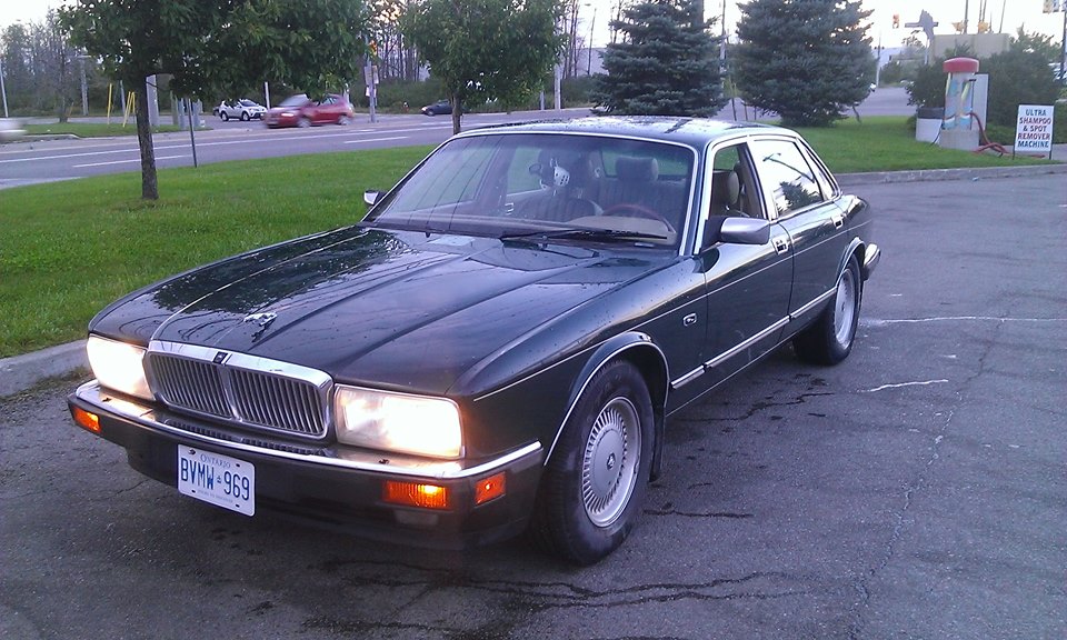

Hey guys, so I bought this sexy 93 jag xj40 sovereign at an auction for 750$ and I would like some help. It has an assortment of issues which I was hoping you guys could help me out with
Firstly cost is no objective as I'm slowly tinkering with it, and am trying to accumulate parts.
Problem 1: The battery keeps dying, this may just be a battery but you never know. WHen I start it on booster pack it starts car but while car is running and driving the battery gauge fluctuates between 10-14. As soon as I accelerate it charges the battery so I assume its not the alternator, correct me if I'm wrong?
Problem 2: Its got a very zesty small hole starting in the trunk floor how might I attempt this? Weld in new pan or fiberglass? WHats your forte with good results?
Problem 3: None of the interior lights work at all except the dash.
Problem 4: It keeps losing power steering fluid in large amounts when running but stops when idle.
Any help is much appreciated as I positively LOVE the car to pieces!
