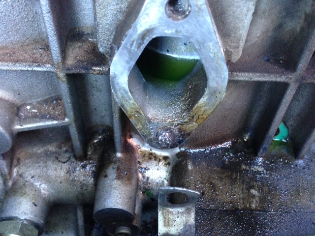

I pulled the manifold and in the process of locating every hose on the car and replacing it. Most of them under they look damn near impossible to do without pulling the manifold.
It looks worse than it is. I think I spent more te walking back and forth fr the car to the tool box than actually undoing bolts

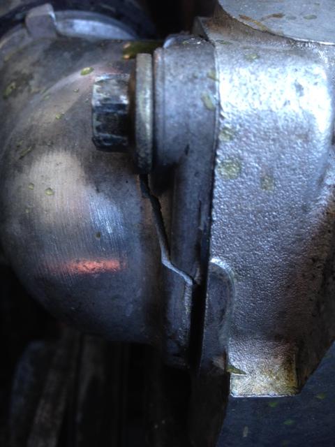

It did appear to be the water pipe that was leaking. I started working at it again this afternoon putting on the parts that I had but 10 min in and now I have to deal with a broken bolt on the front flange.
It moved then seized. I tried walking it in and out, nothing. Pulled out the torch.. nothing. worked a few more minutes and it snapped leaving almost nothing to grab on to. No luck.
Im going to file it a little flat and drill it out with a left handed bit. Retap and run. Hopefully that gets it.
FWIW both bolts had some corrosion at the base of the bolts head so be careful on those guys. At least there is some room to work.
Arrgghh!! I hate it when that happens Unfortunately it is all too common. I now always use penetrating oil first before taking out any bolts in the engine bay and always using anti-seize when putting them back.
Also, be careful using an extractor, they have a habit of breaking off and if they do, you will have a real problem. Ask me how I know this

LOL Thanks
It cost me a prime rib lunch but it will be well worth it. My buddy tigged the remnants up a little and then tigged on a nut and with the heat it walked right out.
I retapped all the holes found 4 new(er) bolts and on it went.

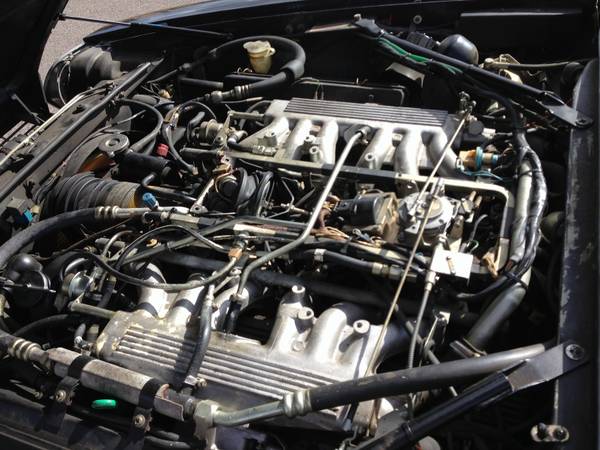

On a 2nd note. A co-worker showed me this....
http://albuquerque.craigslist.org/cto/4110337048.html
Oh so tempting. I really do want a XJS Coupe and this one looks so nice (at least in the pics) even the interior minus the auto seatbelts....but its black on black....
but i have to admit the V12 looks intimidating to deal with and I doubt it gets the 23-24mpg the 4.0 gets.
