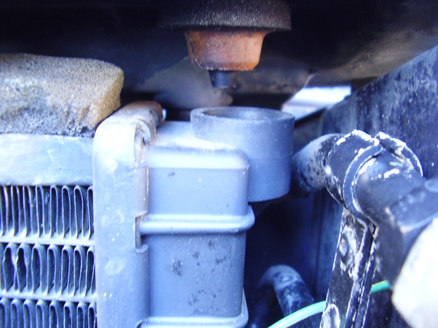

i can`t think of a specific reason for a fan shattering, or breaking, other than old age, gone brittle etc, so i guess we have to start somewhere!
maybe reaching here a bit, but how is the condition of your lower radiator support panel?
when i first brought my car 4 years ago, mine had rotted away so badly, it was barely there. as you can see from this photo, the radiator had dropped a fair bit. so i`m wondering and only guessing, has your rad etc dropped and caused the fan to snag and break.
beyond that, the only other thing i can think of that would cause a fan to snag, is a failed/collapsed water pump seal, which causes the pulley to `flop` about!
