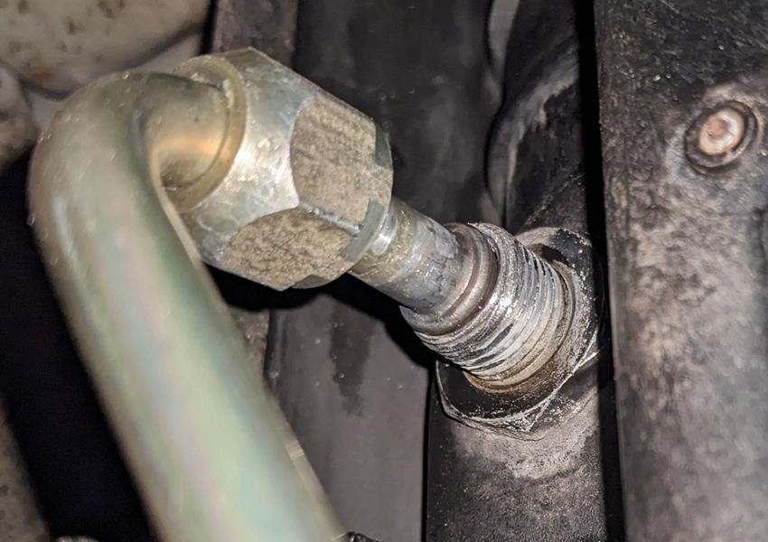

Talking about steering: This is the fitting for the steering cooler line of my XJ12. Does anybody know what kind of thread it is and are these fittings available solely? Mine has been mistreated and the line won't thread up again.
