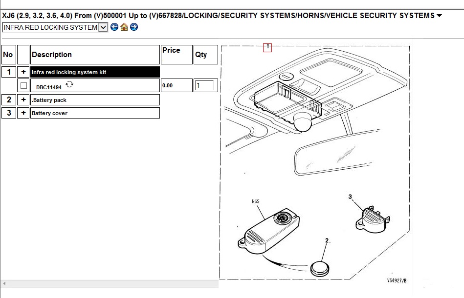

The Parts Catalogue shows a different style which could be the one Rob referred to in post #2:
If you are sourcing one outside Australia, make sure it's the right frequency. I think UK used 433mhz and US is 315mhz on the XJ40.

As I said I have searched high and low over the internet, the one you have pictured in the photo GGG is the only thing I could find online that came close.
The one in the parts catalog "is" the one I was referring too.... it looks to be longer and narrower.
