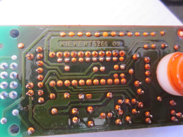

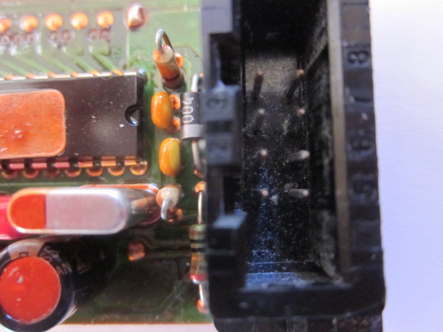

these pics of the central locking receiver from my July MY1990 4lt sov may be of some help in the discussion on keyless entry.
Attached Thumbnails Remote keyless entry fob-img_3277.jpg   Remote keyless entry fob-img_3279.jpg   Remote keyless entry fob-img_3278.jpg   Remote keyless entry fob-img_3280.jpg
Old Mar 22, 2014 | 09:02 PM
  #55
red_101au's Avatar
Posts: 281
Likes: 50
From: Australia
michael prichard,
thanks for the detailed pics.
I am sure they will come in very handy

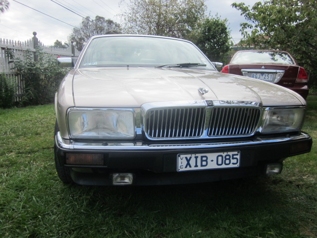

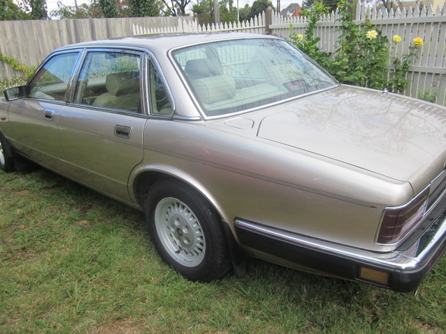

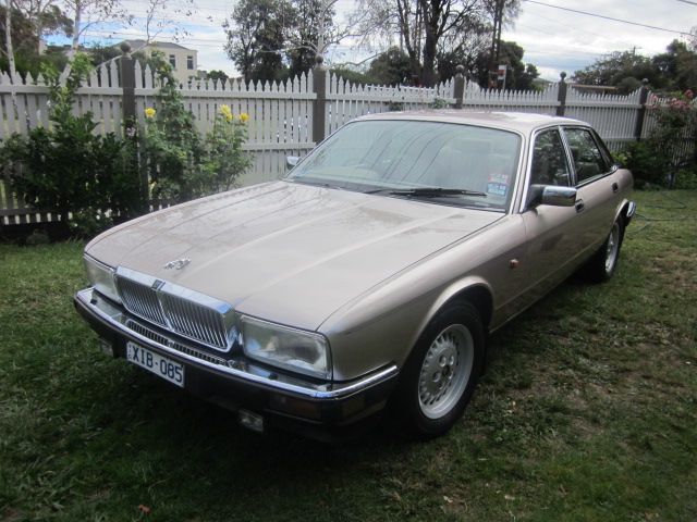

Default XJ40s are not all the same
after so much discussuion on keyless entry, and my post on the TPS, it has become evident that not all owners who have 87, 88, 89 & in my case 1990/91 (Sov) models, have indentical vehicles.
Unless I am mistaken, not too many have a 1990/91 model but either they are earlier or later. I have therefore attached some photos which may or may not excite a few members.
Attached Thumbnails Remote keyless entry fob-img_3345.jpg   Remote keyless entry fob-img_3346.jpg   Remote keyless entry fob-img_3347.jpg   Remote keyless entry fob-img_3348.jpg   Remote keyless entry fob-img_3349.jpg
Remote keyless entry fob-img_3350.jpg   Remote keyless entry fob-img_3351.jpg   Remote keyless entry fob-img_3352.jpg   Remote keyless entry fob-img_3353.jpg
Old Mar 23, 2014 | 06:23 AM
  #57
red_101au's Avatar
Posts: 281
Likes: 50
From: Australia
Looks great..... sweet ride
Pretty much identical to mine..... even the color
In fact from the pictures, other than yours is in better condition....
I would say they are identical.
I do have one question....
Mine does not have the Leaper fitted, but I have bought one
Could you give me the mounting position for it....
ie: distance from the front edge of the hood to the tip of the nose.
I am not sure exactly how far back it should sit
thanks
Just noticed your wiper is sitting on the passenger side...... does it not return to home when switched off.
Also is that a Mitsubishi Magna in the background?? lol I have one of those too hehehehe

Old Mar 23, 2014 | 08:15 PM
  #58
michael prichard's Avatar
Posts: 37
Likes: 8
red_101au
Apropos the wiper, I adjusted the motor so that it would park on left as I hated see the blade as I drove. Not a difficult task except for patience. Background car is a Mitsubishi but Verada Xi. I have been trying to understand why my drivers door rear mirror is heated & the left is not. Jag H T cannot tell me? I am formerly from Adelaide.
Regards,
Michael Prichard
Melbourne Australia
