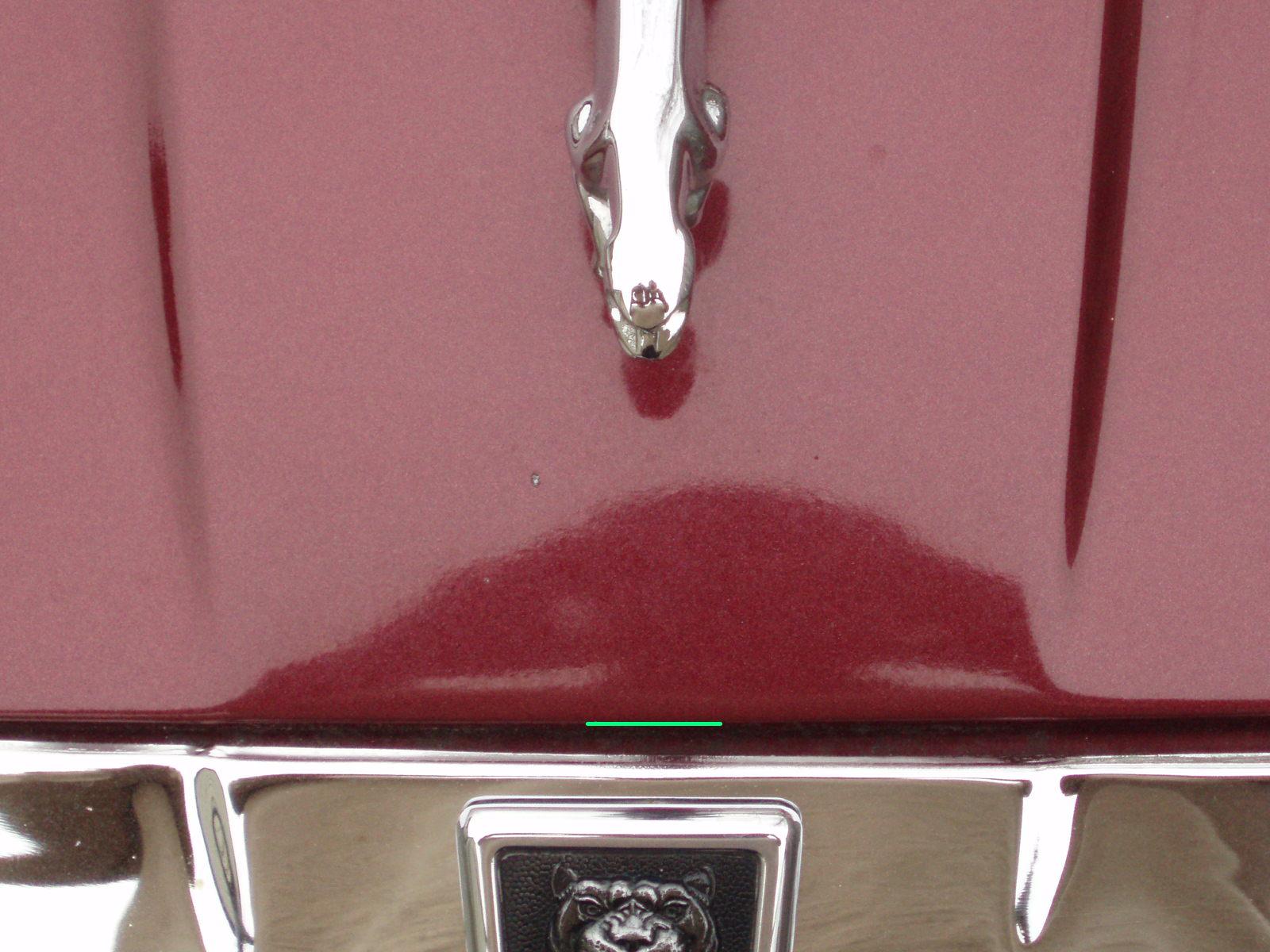

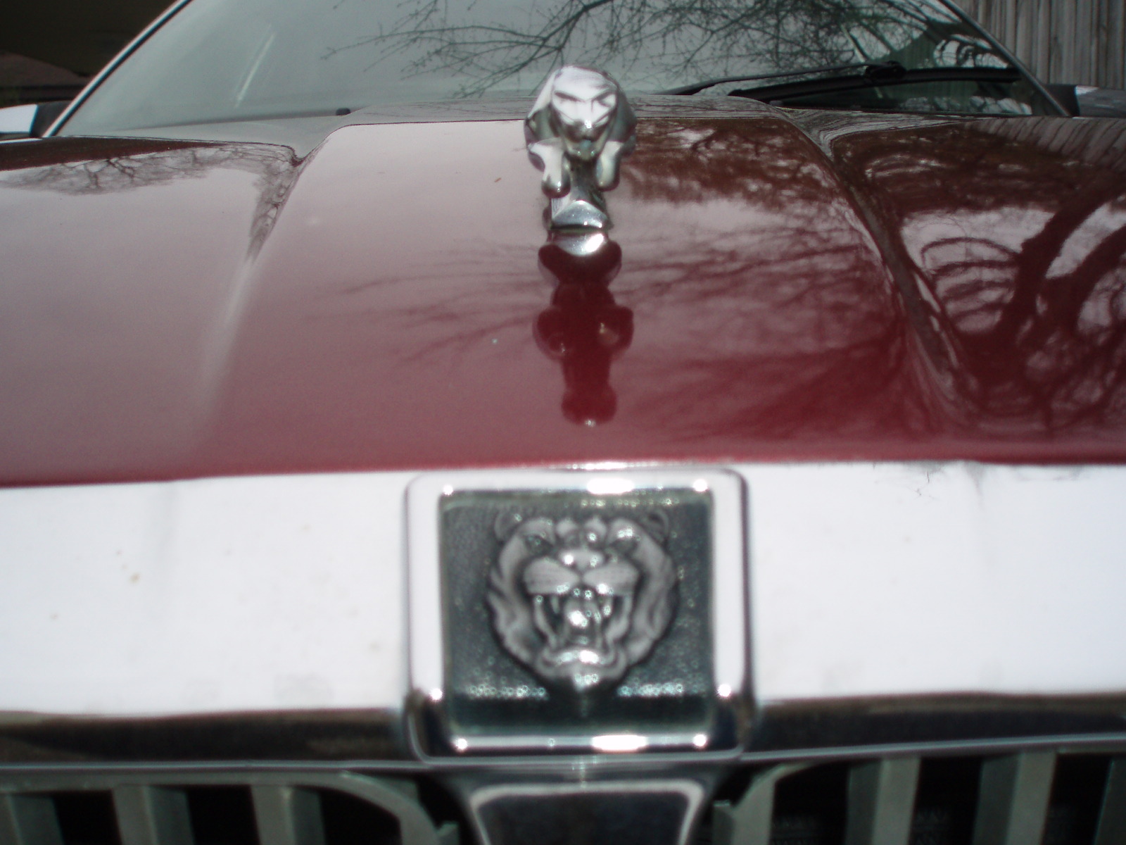

I have as you will see, attached some photos of the jaguar symbol as to its position on my bonnet. Not everyone agrees to that position as there was a very stupid campaign about the damage it could cause if you hit a ped'.
In my opinion, the further back they are positioned, the more ridiculous they look. You will see the base plate. You will also see the chrome square emblem in the (centre of) the chrome grill surround.
1. Place base plate on bonnet so that the back of the plate is 145mm from the top of the chrome emblem (obviously in the centre of the bonnet mound)
2. using black textra, mark position.
3. this position should have the head of the Jaguar 50/55 mm from the bottom of the chrome square.
4. double check to ensure that the Leaper clears the chrome emblem & chrome grill surround when opening bonnet fully.
5 Do not blame me for any errors.
Michael Prichard
Melbourne Aus

Thanks again Michael, I kinda had a rough idea where they emblem should go... but wanted to know exactly.....
However that does sound a little forward to what you usually see.
I tend to agree, some of them really do look like they are too far back.
I really want to get it right, don't want to be drilling filling and re-drilling lol
Of course you would not be held responsible hehehe
There is only one person responsible if I am going to drill holes in my lady.....

Just for you, I'm going to remove my leaper in the morning and measure the hole center(s). I have no issue with mine hitting the chrome grill area and no denting or flat area that K referenced.
I'll take some pics with it on next to a tape measure and off. Mind you, I don't have a metric measure tool, so you'll have to convert.

Looks great... My car came with the leaper installed.. I wish it was not on the car. The hood does not open all the way, as the cat hits the square. also the hood seems dented in flat were the leaper is installed.
Exactly what I was worried about and why I wanted exact mounting positions...
I could see by the way the bonnet opens that if you place it too far forward it will hit or catch on the grille area....
I had noticed they are mounted a fair way back and knew this to be the reason.

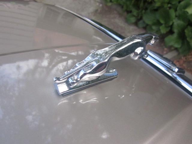

Wow! This turned into some thread! I just put a new leaper on the hood of my car. I went with the larger 7 inch one, instead of the 5 inch that was already on the car.

I added a photo album today in regards to the leaper placement.....talk about off topic.... any way, followed through on my commitment to RED.
Jaguar Forums - Jaguar Enthusiasts Forum - Rob Evenson's Album: Placement of Leaper (aka Hood Ornament)

Someday I'm going to figure out how to add pics in the manner I want. The album reduces the photos, so my editing of measurements are hard to read, so I'll attach them here. Not all of them though...
click on the pics and they should enlarge to see the edit for measurements. The pic with the single green line indicates from where I took the measurement back to the leaper and hole.

great job Rob...... I am very appreciative to you for taking the time to remove your emblem and measure out all the specs for me (us).
I have a perfectly clear understanding of exactly where to mount the leaper now.

After all of these years I never noticed my leaper is not perfectly centered. If you look at the pic with both the leaper and growler badge; find the center of the badge and follow up.... the leaper holes are off to the right by about an 1/8".
If you have the badge, use it to center the leaper. BTW, have someone tighten the nuts so you can watch the bonnet metal for bowing...don't over-tighten those nuts!
