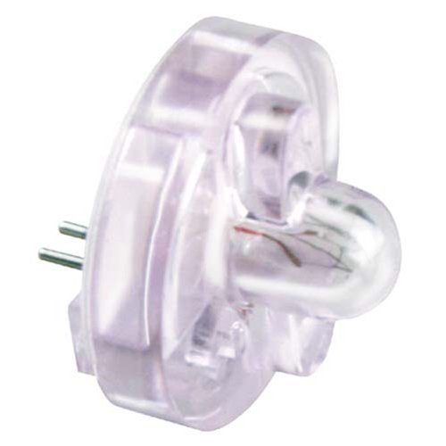

I'd like to add one more item to the "in case of breakdown tool kit" and that is a NOID tester.
Say "Hi" to my (your) little friends.
