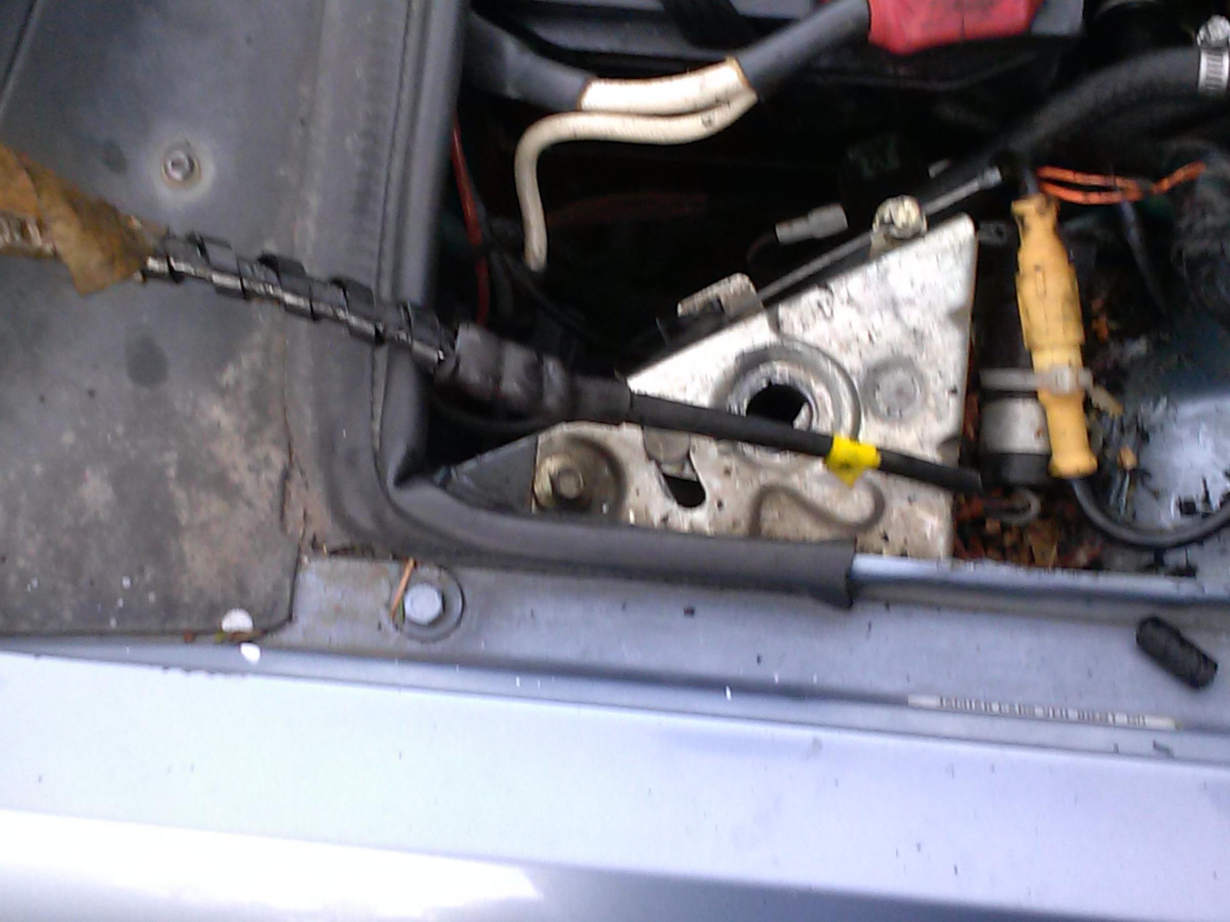

found this plug-in by the battery.. it was hanging down by the exhaust manifold but dont know where it goes to.. the pic is uploaded but im not sure if its going to work ha

ok it worked anyway, if anyone can take a peak at theirs for me to see where it goes, that'd be awesome. thanks!

anyone? im about to raise the front end in the morning so a hint would be nice thanks again.

what exactly are we looking at? or are you referring to?

theres a black connector thats by the battery.. its right next to the yellow connector. the wire thats going across that big silver thing in the pic, that the hood latches onto.. it has been cut and was dangling there.
"it worked anyway" i meant the pic. didnt know how to post them until now haha..

i checked the wires. one is 12v when the ignition is turned but i dont know where it goes

It's the wiring for the low brake pad sensor. Often these fail because of brake fluid deteriorating the wiring so it's easier and cheaper just to cut it off... but the two wires should be soldered together to continue the circuit. It's just a simple 2 wire continuous loop and when the brake pads wear low, the sensor attached in-line wears through, braking the loop, to tell the computer.
