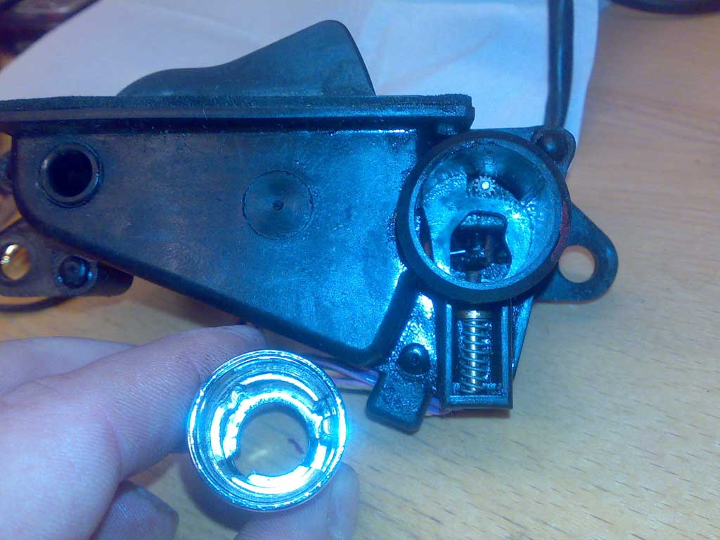

The boot lock assy is somewhat different, picture of the barrel attached.

Here's some info that's nice to know when refurbishing the lock.
Ok, first I disassembled the whole lock assembly from the boot lock. Because it was as dirty as the lock barrel, the first thing was to clean it with turpentine. The inners of the lock and the cylinder are shown in the first picture.
However, as the problem was how to refit the barrel in the cylinder, I started figuring out the suitable place for the spring. First I tried assembling the barrel with the rods only and left the spring out of the assy. Turned out that the barrel-cylinder combination worked also without the spring, but the key (and barrel) turned in the cylinder only when the cylinder was held in one specific position. That was of course the opposite to the position that it lies in the boot. Well, let's try with the spring, then. This was easier said than done, because the barrel didn't turn to the position that it can be pulled out of the cylinder. After some mindwork I figured that the rods should be pushed towards the barrel itself when turning the barrel in the "release" position. There was no chance of doing that, anyhow. The cylinder, anyway, has two holes that are not drilled all the way through. They seemed to be just in the right place, so I carefully drilled and grinded them open. The right side hole gives you straigh access to the rod, when the barrel is almost in the release position. By pushing the rod and at the same time turning the key clock-wise the barrel turns, and can be pulled out. See the holes in the other picture.
