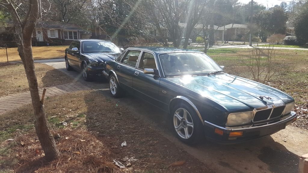

I've attached a few pics below. I bought her from a fellow that didn't know how to make her run and it sat in his side yard for 5 years. Wife made him sell it and I was the lucky buyer I've refreshed the engine and put on new suspension. Now to pull the interior and re-dye the cracks and blemishes, put in new carpeting, headliner, and refresh the wiring a bit and she'll become my new DD to keep the miles off my 09 VDP. 130,000 miles.
And pics for you
Before Pics: (5 years of mice, hose and seal rot...)
After Pics: (after 3 months of dis-assembly, cleaning, new hoses, seals, belts, complete wiring overhaul, new suspension and re-assembly)

Wow, it cleaned up really well!!! That interior looks immaculate!
The steering wheel is interesting - no airbag. Is it an aftermarket wheel?
