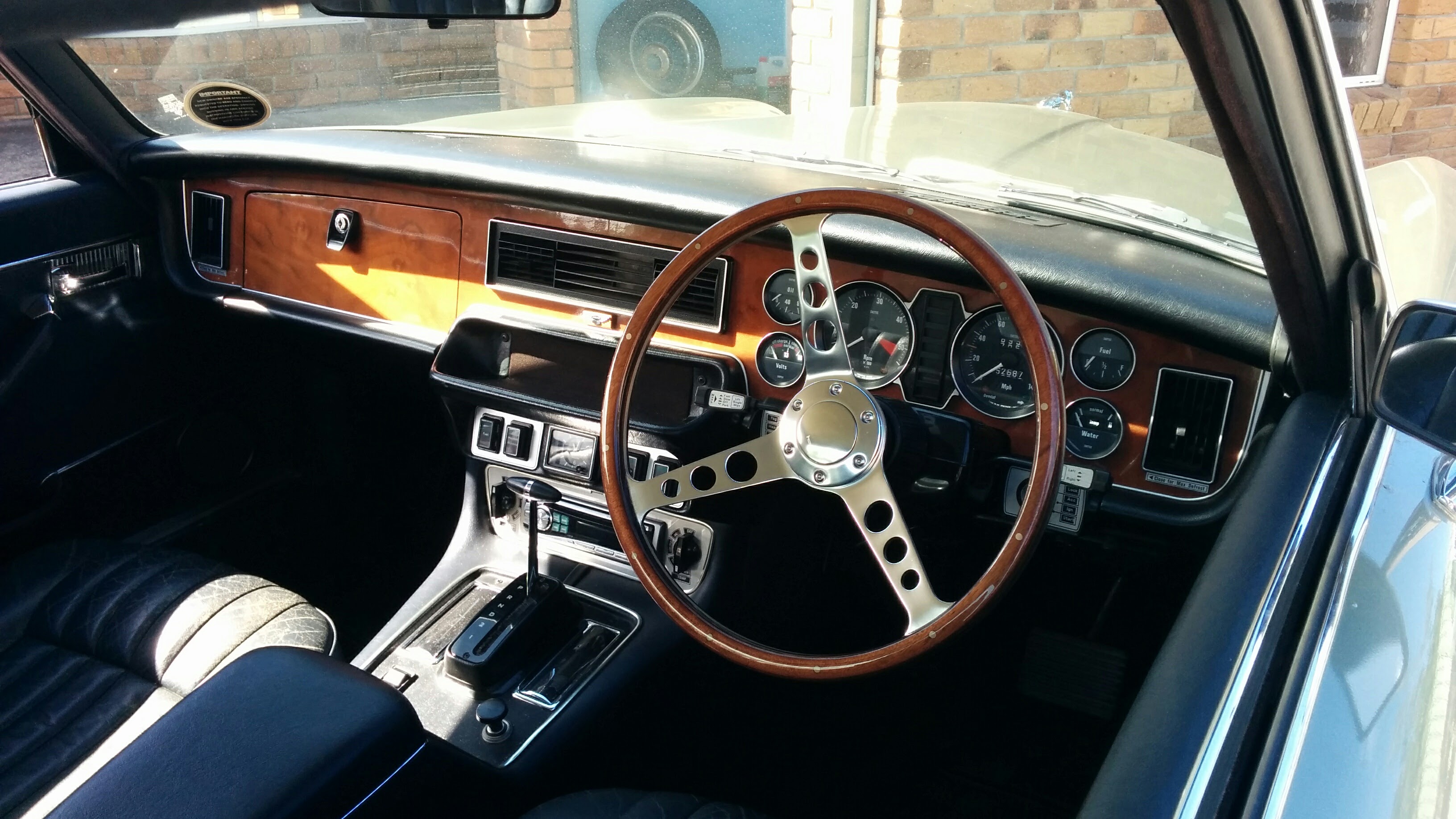

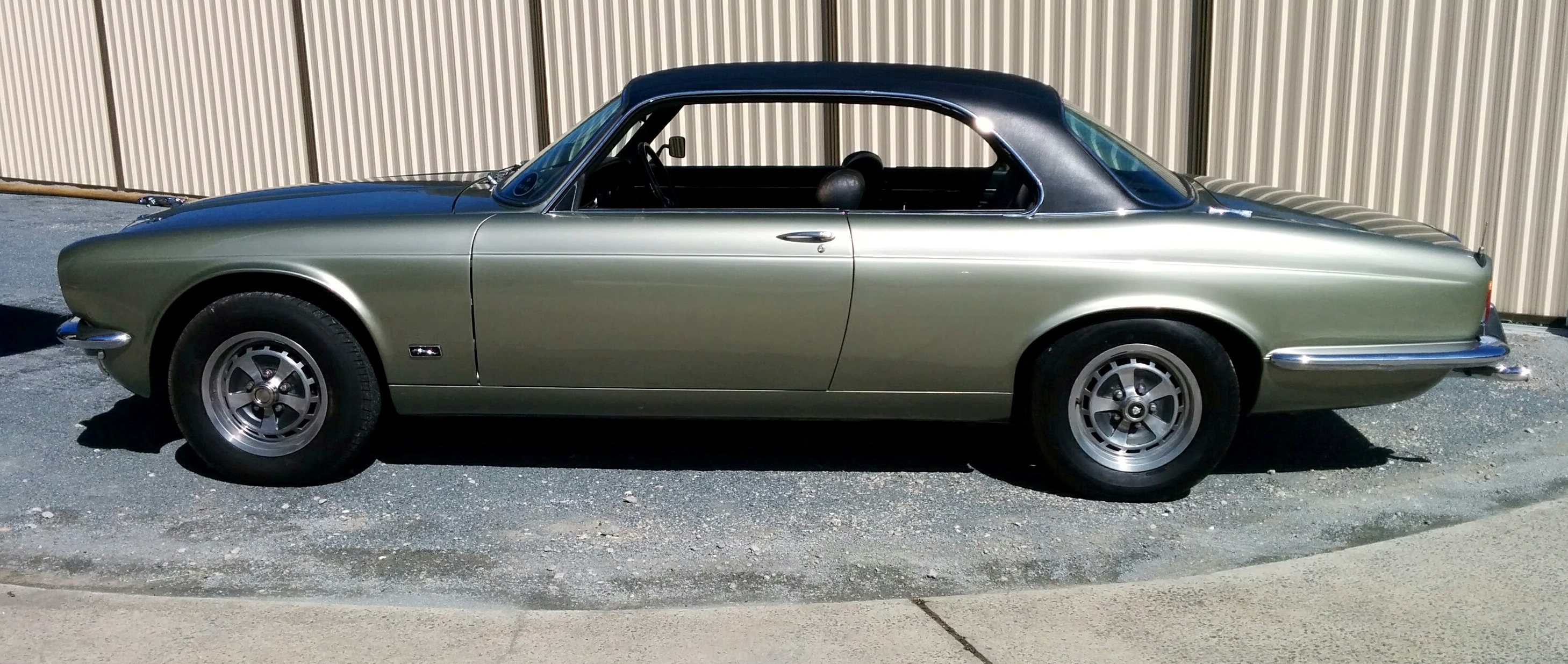

My wife and I live in the Gold Coast, on sunny days I usually just putt around locally and I won't drive it in the rain.
We also like to go for the occasional cruise down to the beach, it's only about 15 minutes to the coast.
It's a sweet ride and I can't wait to get the new wheels on it.

Well, I got my new wheels and took them in for a test fit before painting them I had my fingers crossed but they don’t fit.
The back wheel sits just right but the front rim hits the tie rod.
A 5mm – 10mm spacer on the front wheels only might be a solution but I would like to hear some opinions before I do that. I have seen some 10mm aluminium spacers on eBay for $50.
