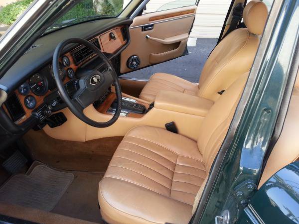

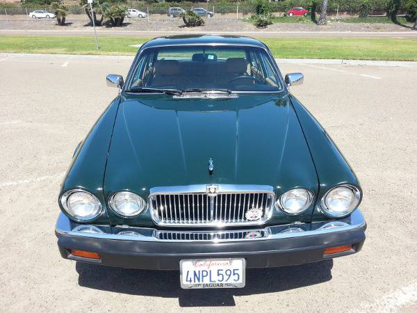

By the way, here's a pic of this XJ6's stable mate. I call them 'twins by different mothers'.
She arrived and she was about as good looking as the pictures. Mechanic said she was in 'pretty good' condition but get ready to put another $2000 into her for front end work and carb rebuilding. Yes, rebuilt engine (with receipt) less than 18k miles on the clock, interior was nice and all the exterior chrome pieces were newish. Spent a bit over $600 with the fluid change and 'trying' to get her smogged without a carb rebuild. Didn't make it and was about to go for the carb rebuild when suddenly a Series III that was in really great shape came past me. Long story but bought the 1987 Series III in BRG and thought, oh-oh, the little lady won't let me have 3 Jags, one has to go. So, sold this brown one to a fellow who's rebuilding a Series I and could use the engine and bits and pieces. The brown one is now a parts car coming back to life as a Series I. I loss about $1500 on the deal but considering what I paid for the Series III that makes that purchase at about market value when the loss is added in. Oh well.
