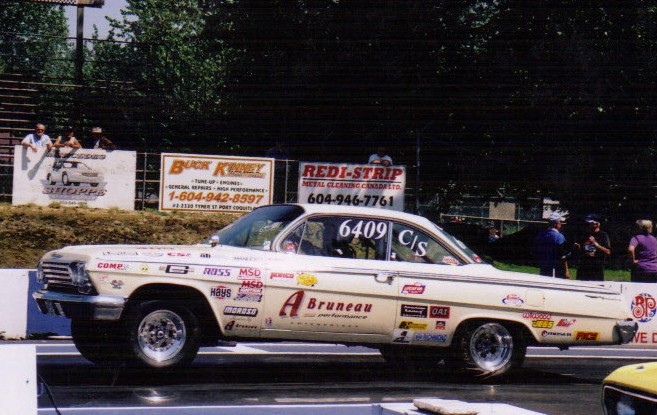

HAAHH !! Ronbros !
great history... and darn nice car you had there.. all of them.
Me ? ... a 409 guy ?
uuuhh...
don't open THAT can of worms...
you have NO IDEA !
I own, built, and drive the fastest NHRA legal Stock Eliminator 409 Chevy... 1962 BelAir sport coupe, 409 / Jerico 4 speed / 5.13 gear. Shift at 7000-7200 RPM, goes through the traps at 7250 RPM... high 10's @ 123 MPH.
