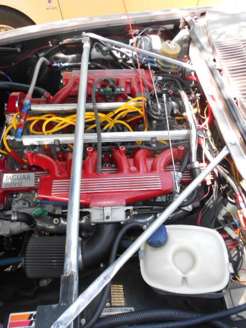

pic of my pump& filter setup, 1/2" aluminum hi-pressure lines,Aeroquip, and 3/8" return line low pressure back to tank.
on my system you can barely see the low mounted fuel/ air seperator tank, the small line lets rising air bubbles return back to the main fuel tank, pure fuel is drawn from the bottom of the small tank, its Jags idea.
my pump and system is way overkill, but thought back 20 odd yrs, i may turbo/supercharge the V12 and need a hi/volume system! may as well do it while the money was flowing!
also pic of FPR (fuel pressure regulator) adjustable. fitting for gage on the front of left fuel rail, barely see it,(quick connect).

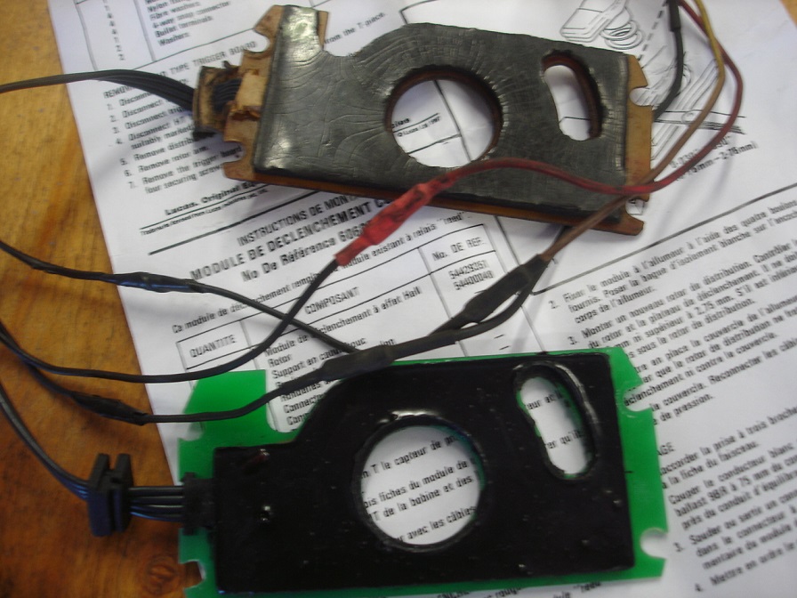

I received the new 4-wire trigger board today. It came with a new rotor as well.
VERY carefully installed it, making sure the rotor was the correct distance above the board ( .030 to .090"... mines at about .062" )
the magnet on the new rotor, was much stronger than the old one.
anyhow
done
It's as it should be.
A couple photos:
the old and new part
and, the underside of the new part.
Attached Thumbnails 1978 Series 2 V12 Engine Mis-Fire-dsc000062.jpg   1978 Series 2 V12 Engine Mis-Fire-dsc000032.jpg
