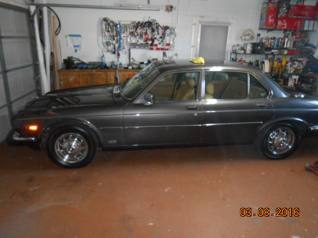

In the first picture, the 205/60/15 does make the car sit lower. I switched out the rims for the chrome ones from the S2, because they were in excellent condition and I had 5 of them.
The second picture is the car with the S3 rims and 215/70/15.
