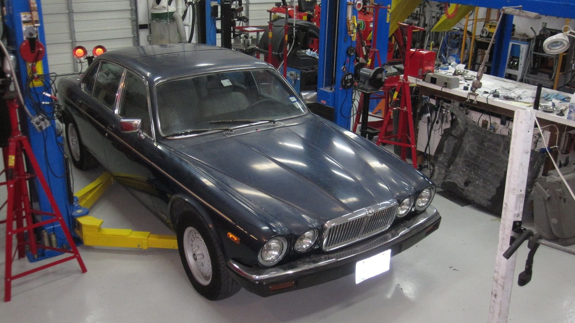

I purchased this car (1985 Sovereign) in 1994 knowing it had a cylinder head problem - specifically a tapping noise. It sat in my garage for 4 years and in 1998 I had a choice to make: Either fix it or get rid of it. I decided to fix it. I pulled the cylinder head off the car, had it rebuilt locally, put it back and from 1998 until 2006 it was my daily driver. I am a pretty good wrench and I enjoyed probably close to 80,000 miles of glorious driving. Once I rebuilt the engine wiring harness, this car was absolutely reliable and had no fear in driving it anywhere. In 2006, however, my interests changed slightly and the car had to go since I had no room for it any longer. I gave the car to my daughter who drove it for another 5 years (2006 - 2011) putting another 20,000 miles or so. However, by 2011 the best days of this car were long gone belonging to the past.
Since the reliability suffered tremendously under her watch, she gave up the car and since then I was able to make room for it once more. However, it sat for the last 4 years neglected.

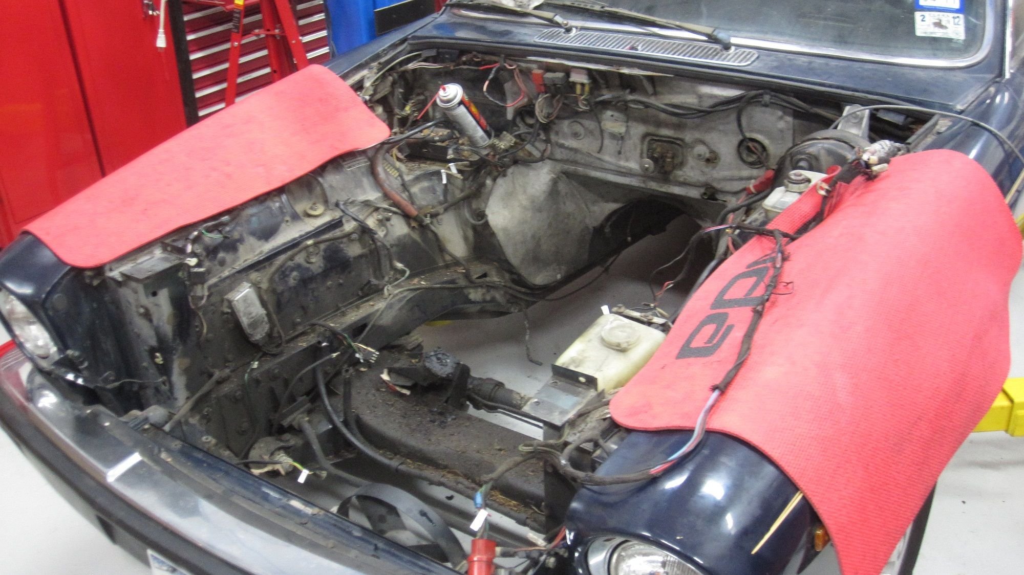

Today, I embarked in a quest to make it a driver again. I have been blessed during the last few years with my own private shop that I built and have the room to work on her once more. This time, the engine will come out and have it, at a minimum, resealed and possibly have machine work done to it. I am taking a course on engine rebuilding in a local community college and will use this engine for my project. Of course the car needs more work such as interior trim refinishing, door handle repairs, possibly suspension work etc but all that I have done on this and other cars.
Today I managed to get the condenser, radiator and assorted hardware out of the engine bay. I will be pulling out the transmission as well since I plan to replace the slush box with a TH350 tranny using John's Cars quarterbreed conversion. The tranny has always been the low point of this car.
I will be pictorially documenting as I go along.

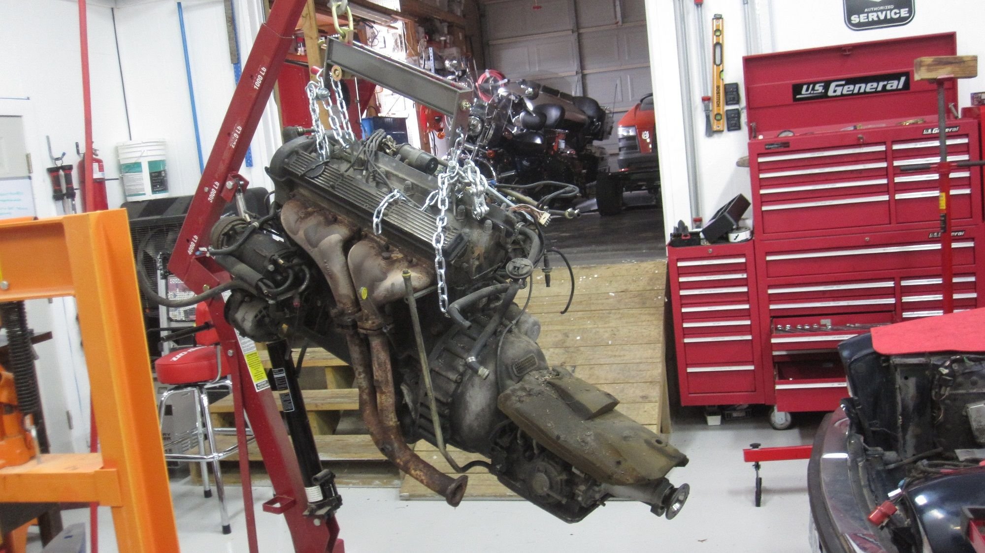

Almost out
It is amazing how many little things you forget to disconnect when you try to pull the engine out of the engine. I just about have it done though. I should've dropped the exhaust header out but did not, and not only that, the only oxygen sensor is on the way and hitting the steering column. I tried to disconnect that sensor but it is baked on tight. I would have to just remove the header before finally completing the extraction. Hopefully I'll get the engine/tranny combo out tomorow... stay tuned....

Dec 31, 2014 | 12:02 PM
Engine/Tranny out
On to separating the slash box from the engine. I managed to get the oxygen sensor out. That was the only hang-up from last night....

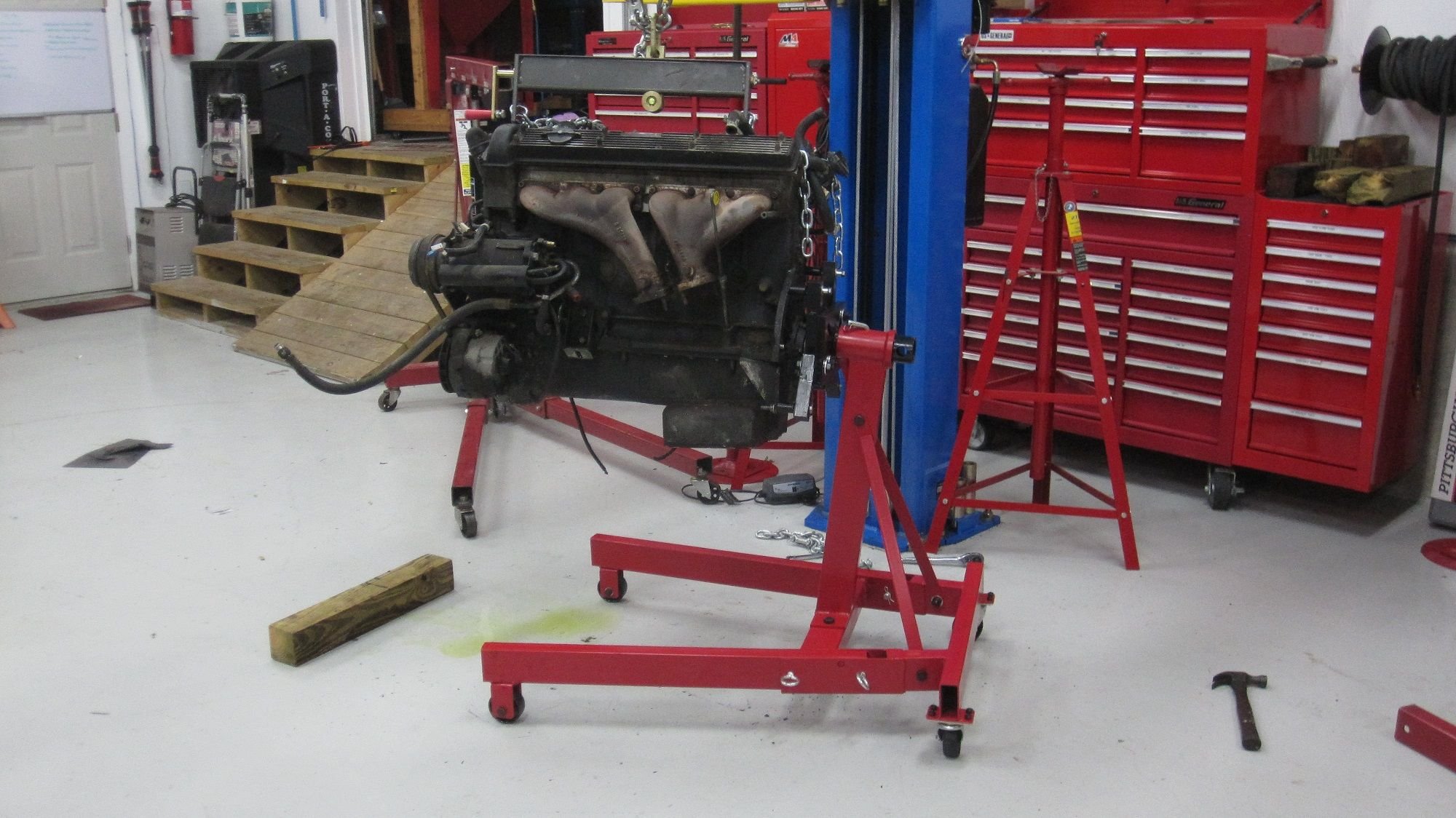

Jan 1, 2015 | 11:25 PM
Engine lift to engine stand
Not as easy as it should be. The lift's and stand's legs stand in the way. That is where the two post lift acts as an intermediary and facilitates the transfer. Now the engine is on a 1 ton stand and ready to be stripped. Since I have a few other projects lined up, this will probably have to wait a week or so before I get to it.
