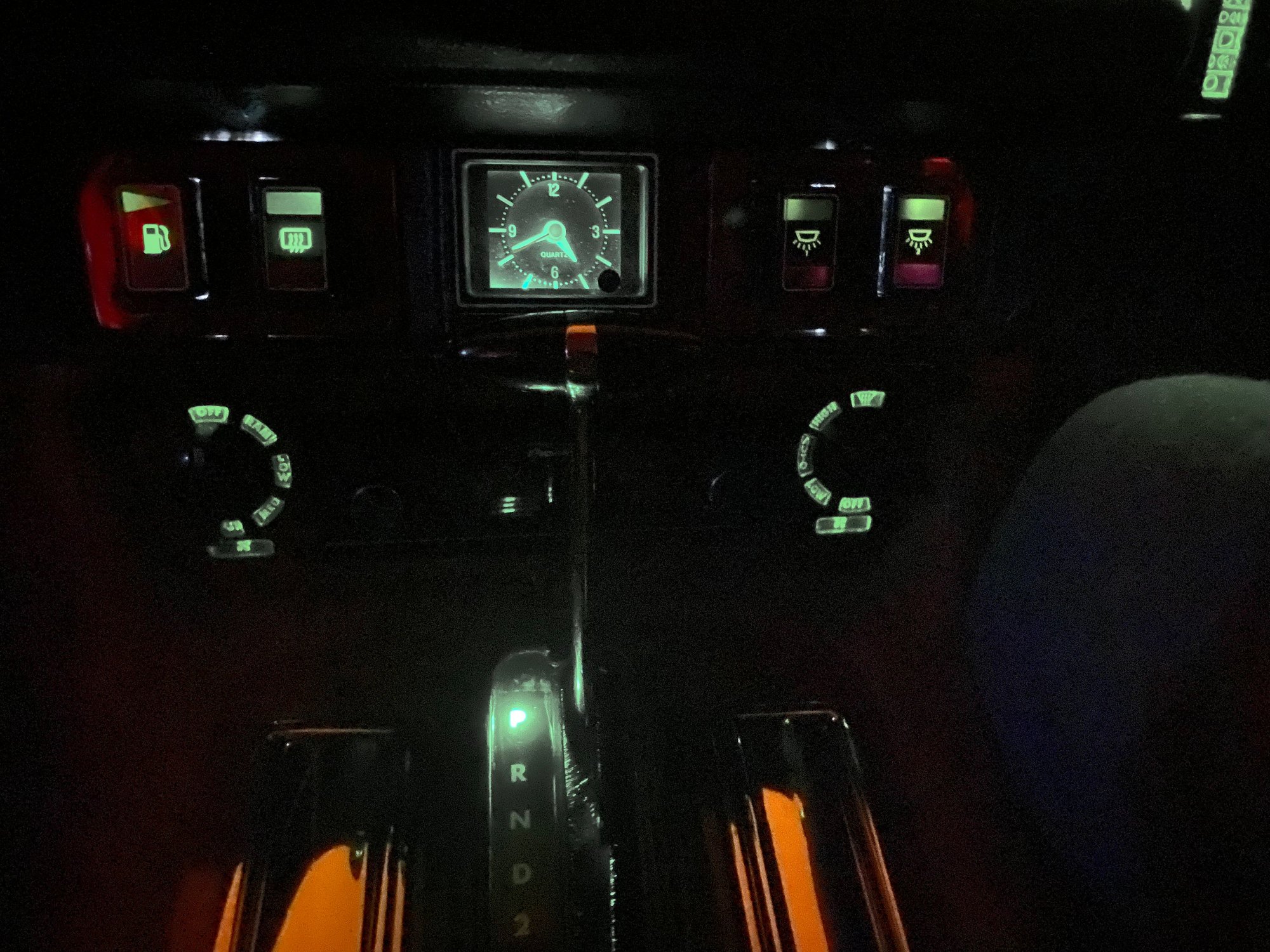

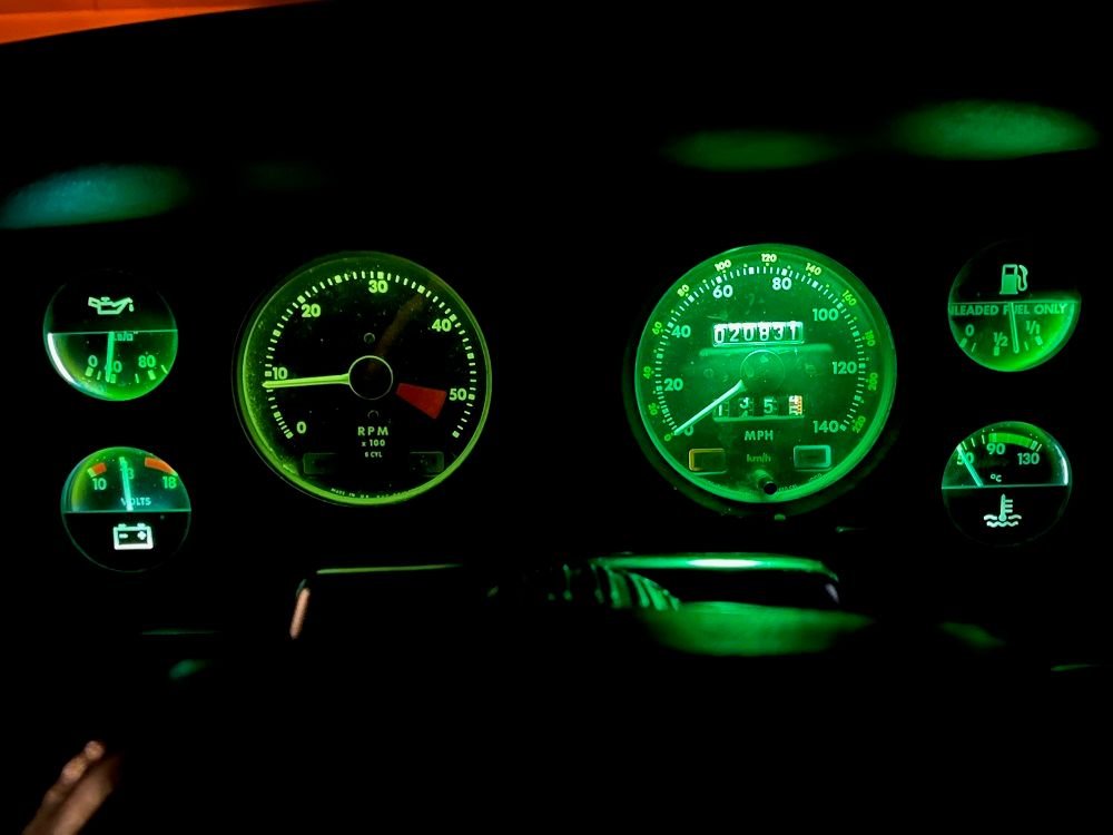

The next project was replacing all the dash gauge lights with LED bulbs, what a difference, the gauges are much brighter and much easier to read. I am curious why the LED bulb in the tachometer didn't make as much difference in brightness as the one in the speedometer did? Upgrading the opticell will be next.

MSGGrunt, What LED's did you use? The Speedo/Tach ones are different from the small gauges, so there should be two part numbers. Also, does the dimmer function , or are these non-dimmable LED's. Ian
Old Nov 28, 2023 | 07:25 AM
MSGGrunt's Avatar
Joined: Apr 2017
Posts: 444
Likes: 324
From: Western Massachusetts
The rheostat does not dim the lights.
The LEDs I used were based on another thread on here.
Yes, the two bulbs for the tach and speedo were different than the four screw in ones used on the smaller gauges. The tach is probably not as bright because of how the light travels within the gauge. Not a big deal as it is still plenty bright compared to the original incandescent bulbs. With my car being a VDP with the recessed gauges it was a bit more work twisting the tach and speedo to remove and reinstall. I found removing the center warning light housing gave a bit more room and a bit more purchase on the gauges.

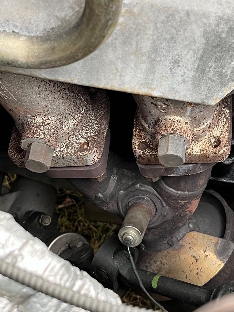

Question, what are these two plugs for in the exhaust manifolds?
Old Dec 10, 2023 | 05:58 PM
  #30
Larry Louton's Avatar
Joined: Dec 2015
Posts: 425
Likes: 221
From: Venice, Florida.
There is a tool for measuring the CO and Hydrocarbons that you would attach after removing those caps. Had a valve so you could measure which bank had the misfire or leaking injecter. Another thing or two that you are going to hear about sooner then later. #1 cylinder is closest to the windshield. A-bank is closest to the windshield. B=bank is furthest away from windshield. Camshaft timing is adjusted from frontmost cylinder while #1 is at TDC. Purchase tool to adjust upper timing chain.

Very nice car and the LED lights came out nice. I did the same thing and also the opticell initially but ended up taking out the fiber optics and wiring in LEDs. I don’t know why the tach is different. Has the bulb dislodged? Anyway beautiful car, enjoy. 😀

That's a super compliment to be trusted to work on that beautiful cat you have.
If you're happy just changing the opticell bulb, it's right there under the center console.
Did you already try it? I found it really didn't make much difference in light output through the optics. Also one of my long fiber optic cables was already broken.

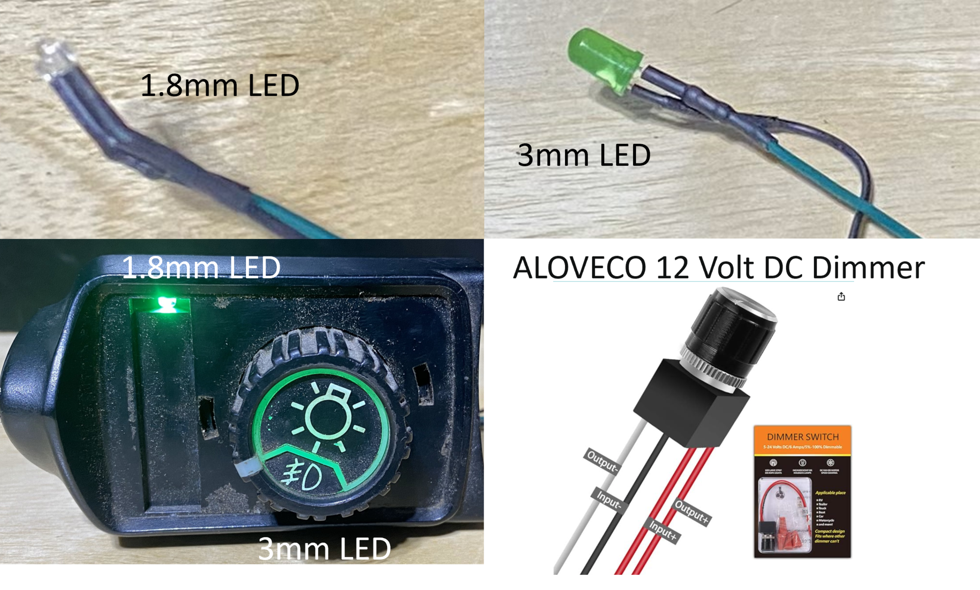

I bought a 30 pack of prewired 12 volt green 3mm and 1.5mm LEDs for $7 or $8 on Amazon. I unplugged the opticell connector. I then routed and wired up 7 LEDs from the dash locations to the opticell plug.
Initially too bright but easily fixed.
You can either disconnect the retrostat by joining the wires or buy an LED dimmer $20, again from Amazon. If you do need anymore info, links to parts, tips etc. I'm more than happy to assist. Your MA. neighbor ukborn

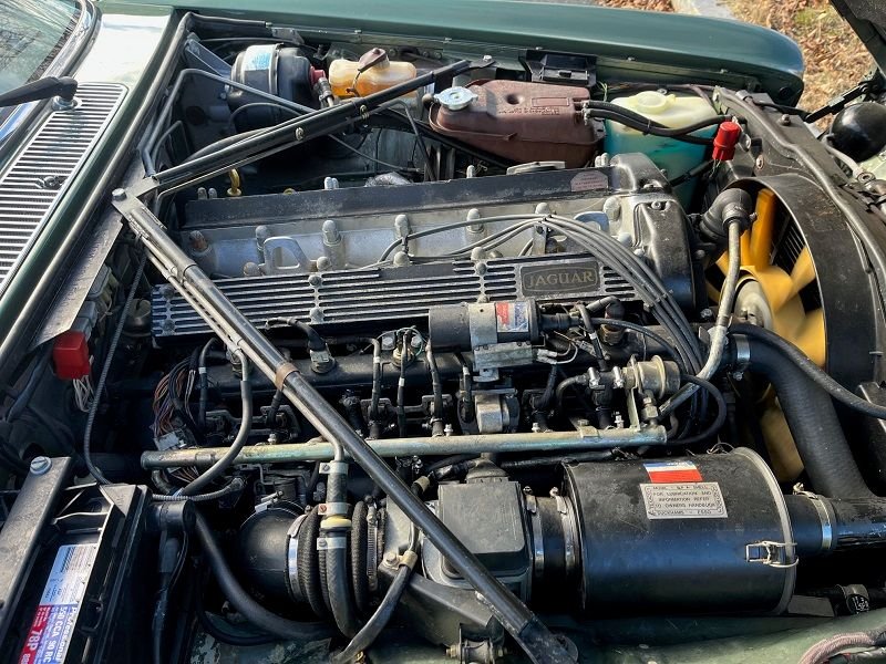

Working on cleaning up the engine bay. I struggled with if I should remove the air pump and its associated hardware, but in the end I decided to go ahead. Everything was removed with no damage and the entire system could be put back in working order very easily. Much cleaner engine bay. The plugs in the head I got off McMaster Carr.
The exhaust heat shield and cam covers are next. The heat shield will be polished and I have a nicely refinished set ready to be installed. I was going to replace the head stud nuts with fancy chrome ones from Moss Motors, but have instead decided to have then gold zinc plated when I have the lifting hooks and other pieces refinished.
