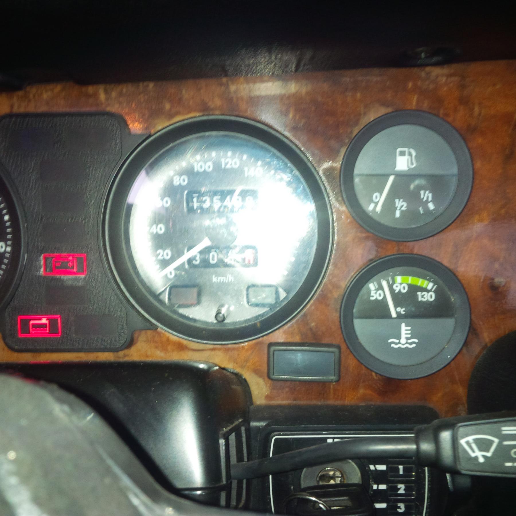

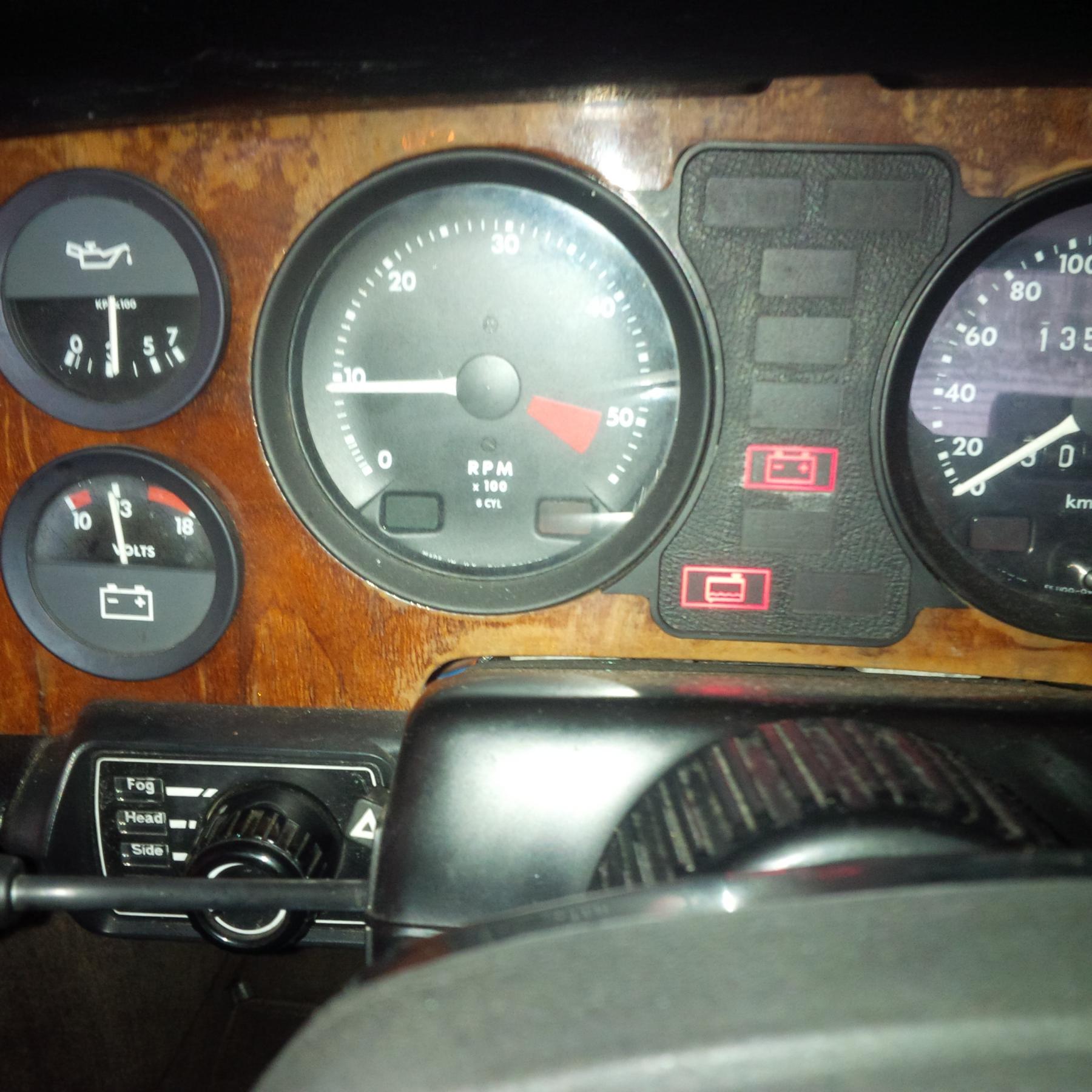

In picture is the rectifier what the Blue wire goes to? It's the rusty piece I had to take off old alternator or should have I even put this on the new one? Here's pics of what I'm seeing on dash lights now thanks in advance. Tom

Here's pics

Old Nov 15, 2014 | 08:57 AM
Doug's Avatar
Posts: 25,535
Likes: 11,735
From: Pacific Northwest USA
The rectifier is inside the alternator.
Looks like you might have a Motorola alternator. Is that correct?
The wire colors you've mentioned and shown in the pics do not match what a person would usually expect to see on a Ser III nor what is shown in the S57. Perhaps because you have a non-USA car and the S57 applies to USA models.
If the warning light stays on it could be a damaged rectifier, yes.
DD
