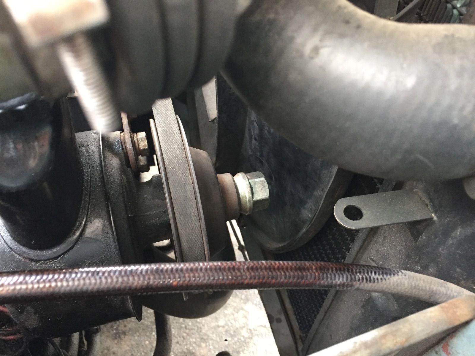

drove out to a friend in Sylmar today and heard a bang.
Popped open the hood to find my power steering pump pulley lodged between the lower radiator hose and the radiator!
After finding a lug nut to be the only available fastener in a 9/16X18 dimension the minor struggle to get the belt back on ensued.

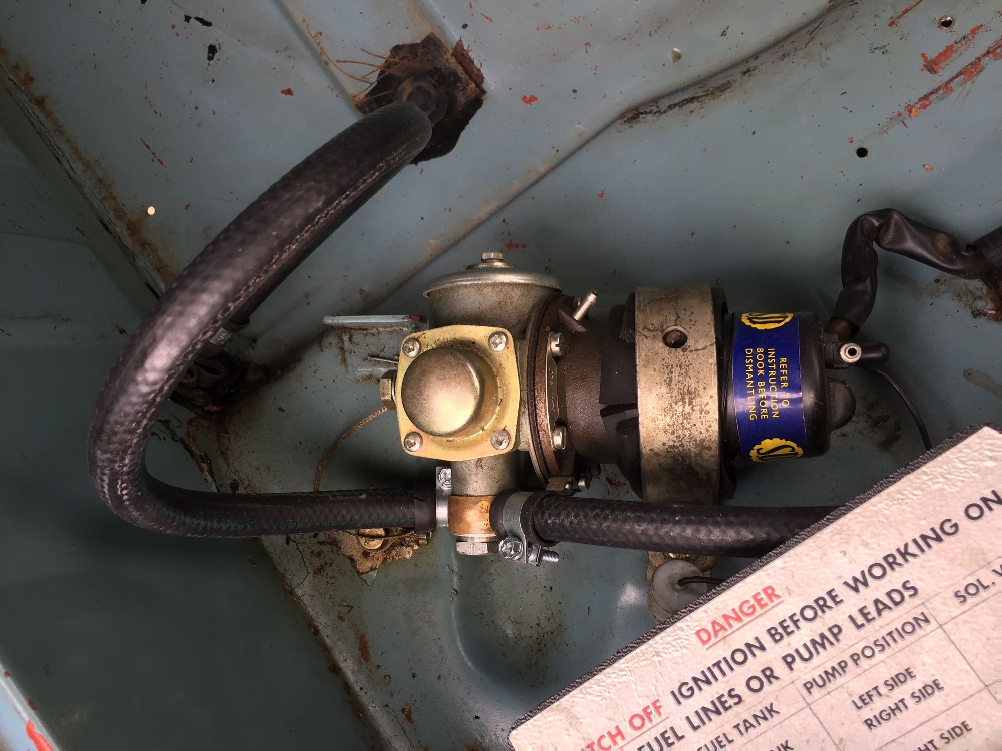

Just a note, manual choke car with strombergs
left pump (port side) is intermittent so I've been on the right one (starboard) for the last few weeks

Default And now the video evidence
I think I found the problem
Starboard pump video link.
https://vimeo.com/214428446
note the foaming fuel filter!
After it's been off for awhile
https://vimeo.com/214428500
Port intermittent pump
https://vimeo.com/214434832

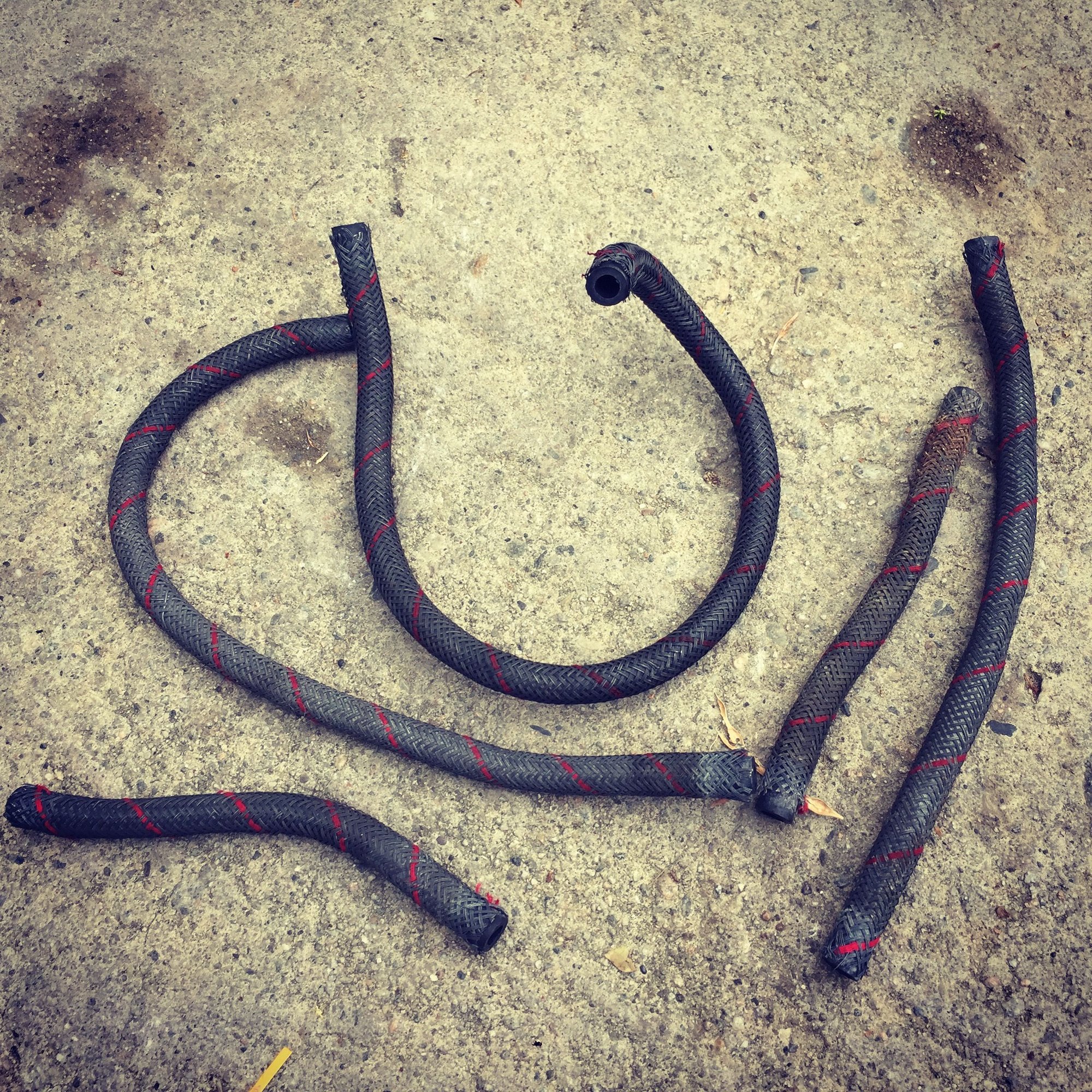

So in the end I had to replace the smiths petroflex hose with some newer gates material.
the old hoses didn't have any noticeable leaks when ai blew into them, but 2 were very leaky when I pulled a vacuum in them.
Replaced most of the clamps with Swedish ABA clamps. And I'm good to go there.

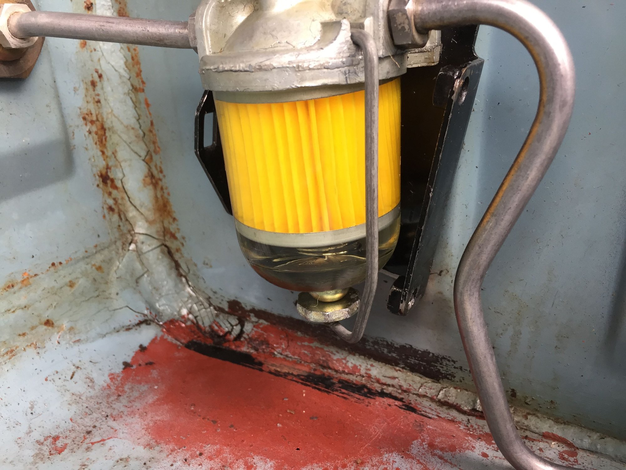

i also replaced the filter with probably the best one I've found yet.
XK's spring to much tension, motorcars ltd wrong gasket size, SNG Barrett worked the best.
i still am having a slight lead around the filter bowl and at the threads at the filter housing, do I need to ask David Bodger if he has a spare? I'm wondering if I mmmmmmmm

Finally see a photo of the bracket at an angle and the filter plumb. Any ideas why?
