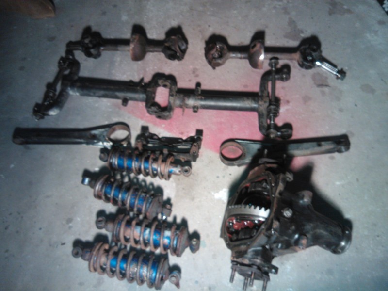

I've cleaned and de-greased a lot of the parts now. They'll all get a coat of Paint before they go back in. The Cage, the bottom plate and the diff lid is off to sand blasting.

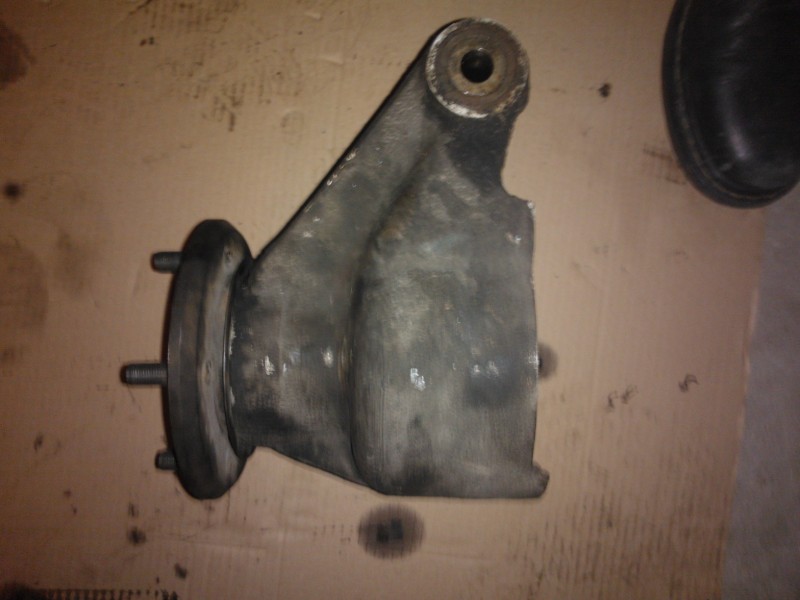

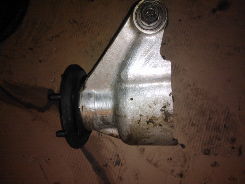

The hubs are covered with a thick layer Tectyl mixed with old muck. Really nasty stuff.
After a good 20 minutes of scraping and cleaning however, it seems there is hope.

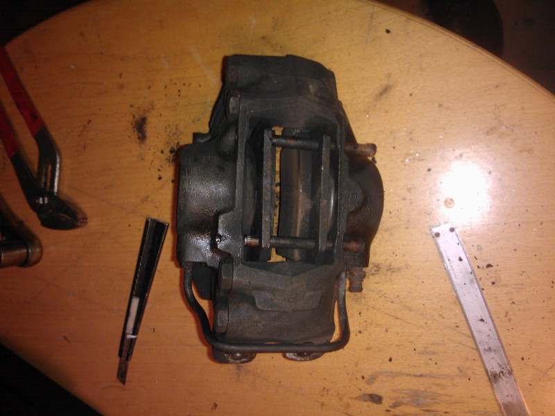

Time to disassemble the calipers, give them a good clean up and rebuild them with New pistons and seals.

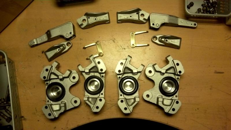

The calipers are blasted, cleaned, painted and rebuilt with new seals and stainless steel pistons.

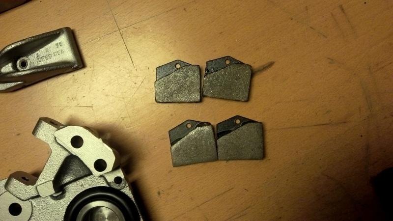

My parts supplier have sent me 4 Equal e-brake pads! I guess I'll have to give them a call in the morning!

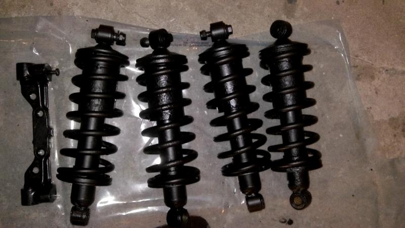

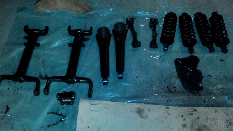

Lots of other bits have been thoroughly cleaned and given a new coat of paint.

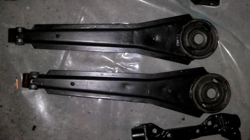

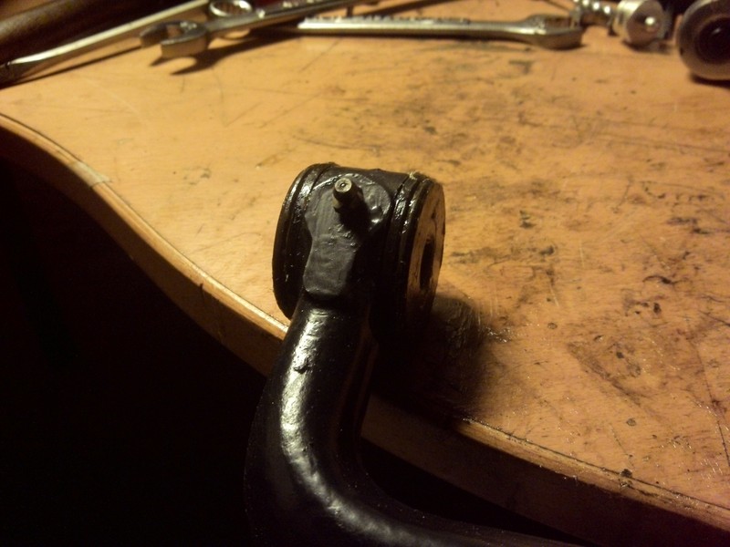

The radius arms have been fitted with new bushings

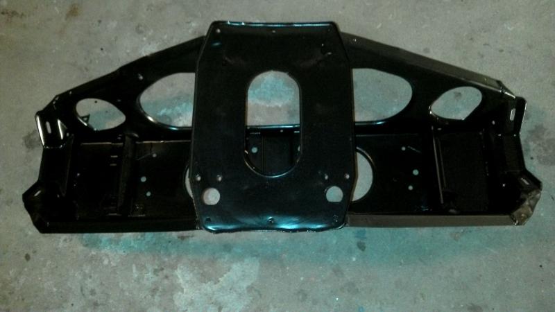

The subframe and bottom plate is still off to blasting and paint

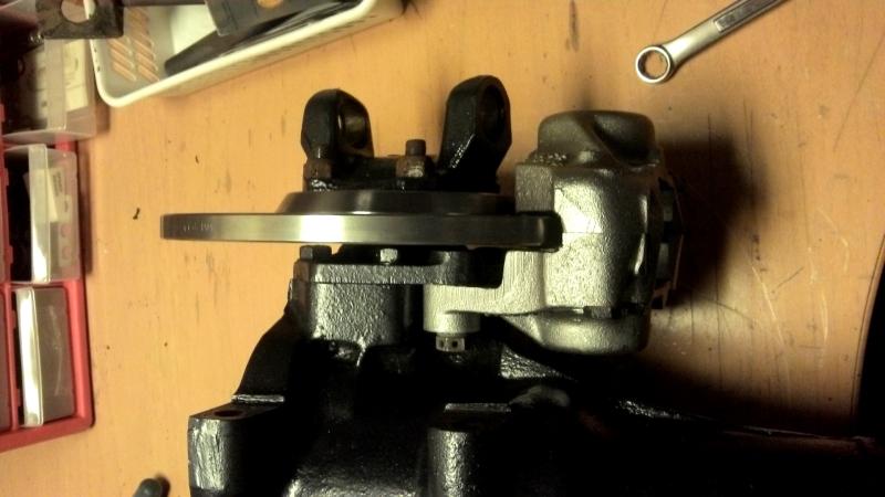

The first caliper is back in place.

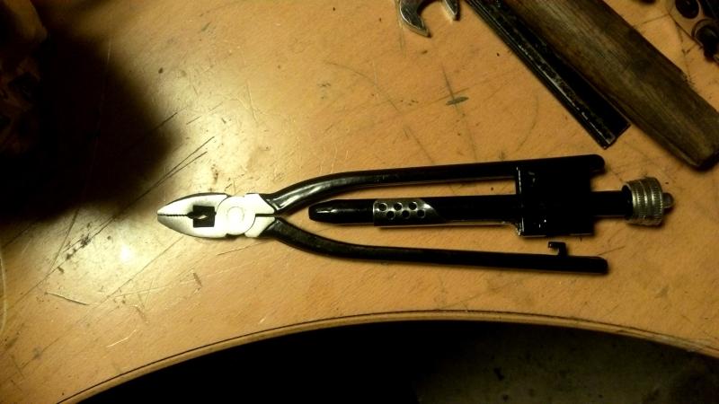

Got one of these off e-bay. No quality stuff, but it gets the job done.

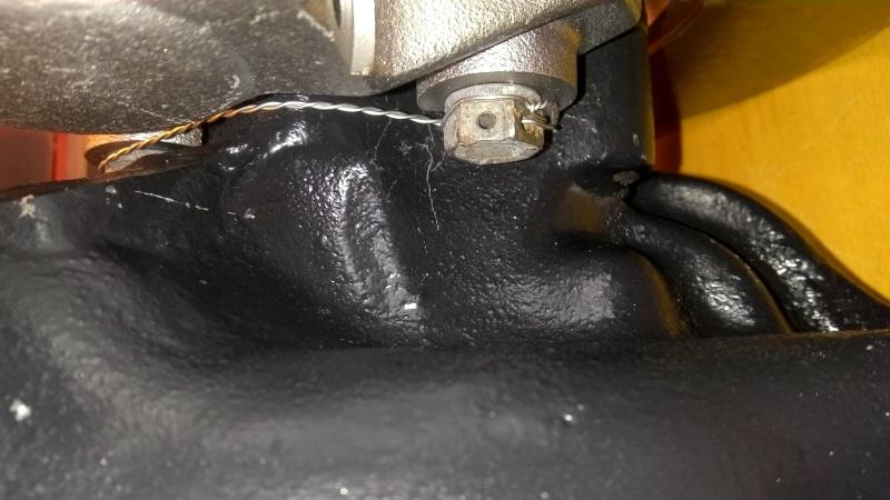

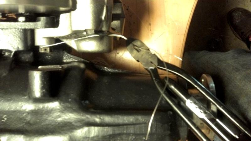

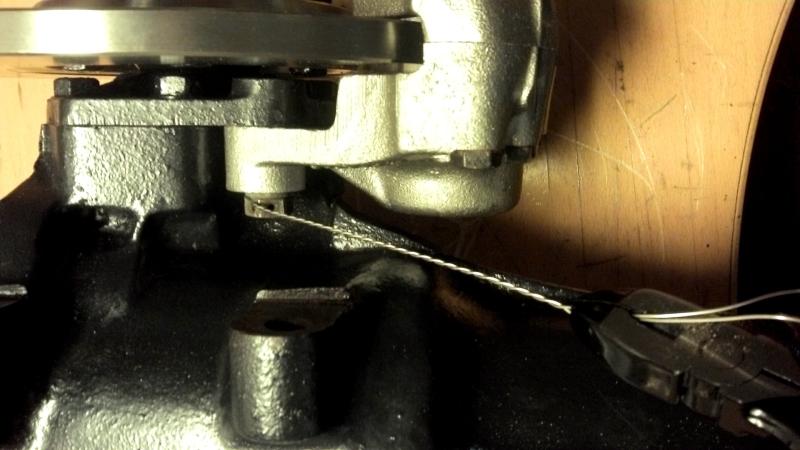

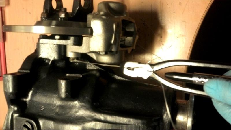

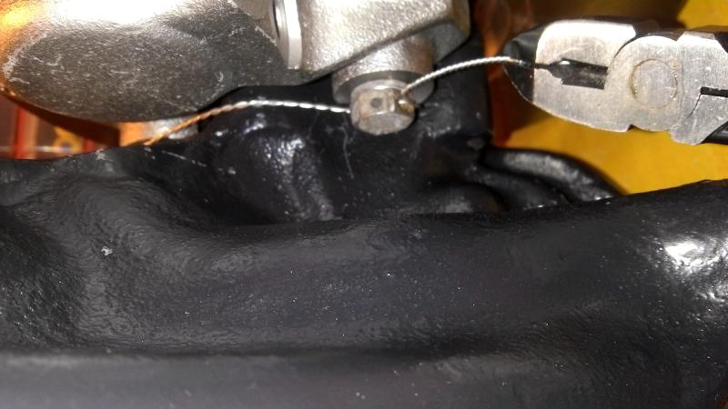

Locking wire in Place

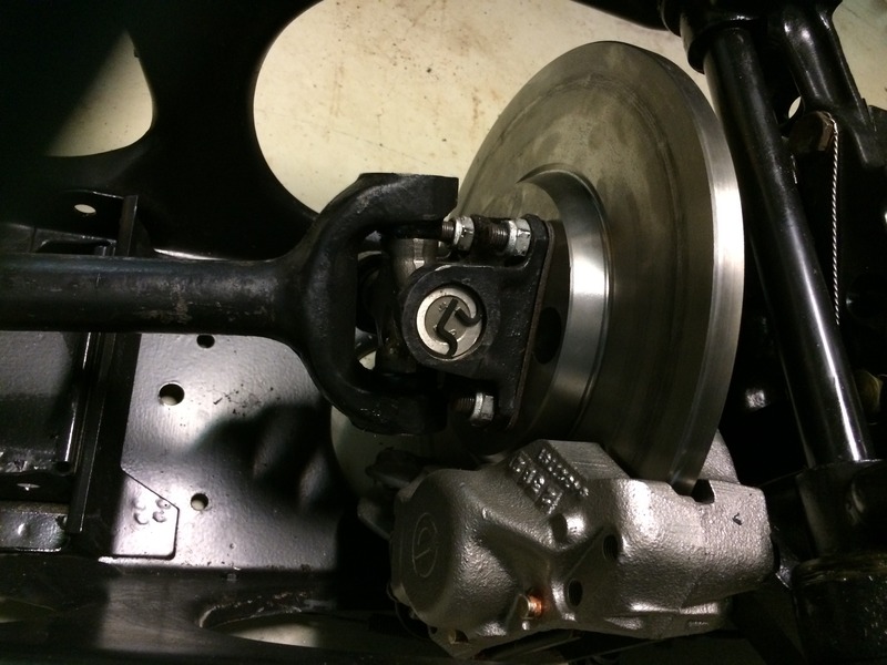

Rebuilt calipers in place.

Looking good, I need some lessons in tie wiring.
Old Feb 16, 2015 | 10:39 AM
JagCad's Avatar
Posts: 6,796
Likes: 2,403
My compliments, sir. Very nice work. And, I learned where the bolts are that mount the calipers to the "pumpkin". wondered about that when I contemplated installing mine in situ. Chickened out and farmed it out. But, they messed up my e-brake. although, I seldom use them, one day, I'll ;look into a fix. But, I may have done the last get under it. At my age, up and down is a major event.
Those twist pliers are neat. I've pair on my bench back board in the "special" tools section. Did a few on my roadster project. Safe, fun and look neat.
Somewhere, I have or had a lexicon on how to use them and the wire in various locations. Aircraft in origin, I think.
And, the wire itself is handy. Done lots of things with it. Among, them, fixed the flapper valve control in a toilet tank. The no rust feature is handy as it is immersed in water!!

Lol! Yeah the project has definately grown! It started out as a brake job, but as I got along and I had everything out, in pieces and put so much effort into cleaning etc. I figured I'll go the distance and make it all purdy! It is a summer car for me, so it's not going anywhere in a couple months anyway.
Thanks for the nice comments everybody, it's really rewarding and fun to put the refurbished parts back together. Especially after cleaning decades of accumulated oil and road muck off every imaginable little piece of the IRS in diesel! Yuck! I hate diesel!
Many moons ago I served in the air force, and I would do daily inspections on light aircraft. I would also assist in routine maintenance like oil changes etc. One of the skills I learned was to secure the oil filters with wire and twist pliers. I finally got to put that skill to use!
There's really nothing to it, but I agree it looks really neat. It's also a really good idea on the IRS. Some of these bolts are not accessible for re-tightening should they ever come loose once the IRS is in place.

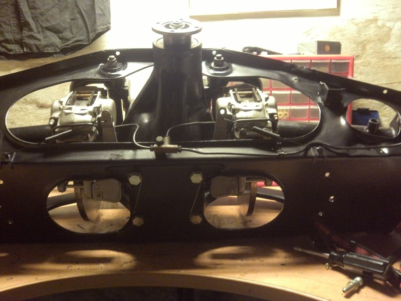

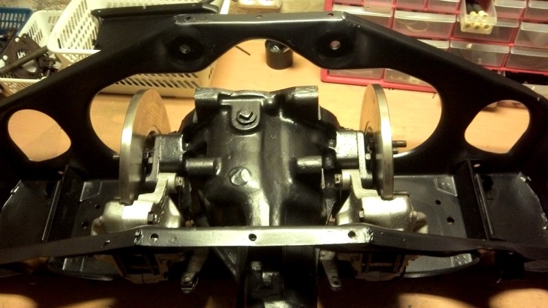

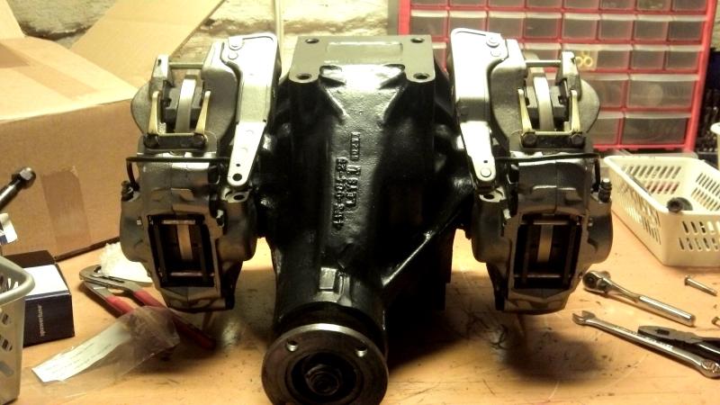

Got the e-brake calipers back on. I hope I've set it right.
Got the cage back from blasting and paint. All that is left of the job now is to fit it all back into the car

Old Mar 1, 2015 | 07:06 PM
  #31
Posts: 26,776
Likes: 10,317
Default How Did I Miss This??
How in the World did I miss this thread!!? I must have been brain dead.
Olav, this is a Great tutorial! I'll be checking it quite often when I get to my rear brakes.

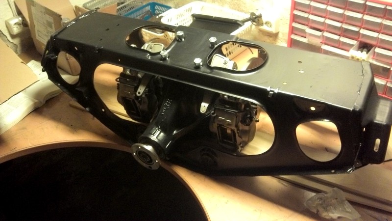

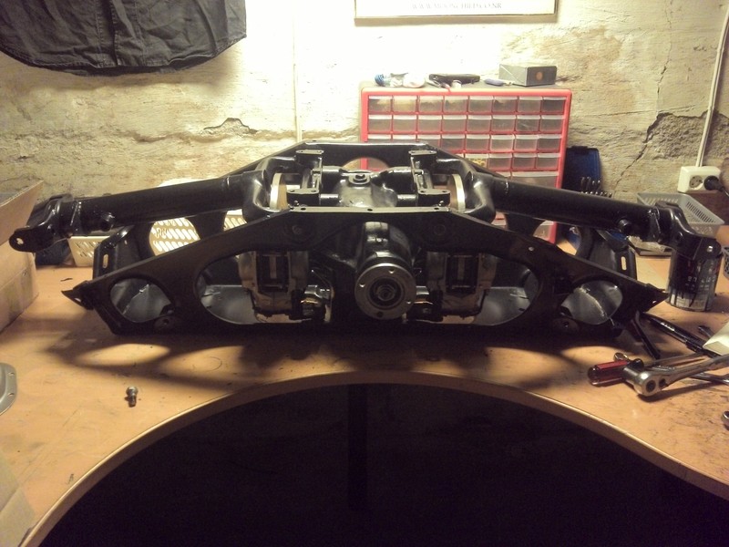

Thanks for the nice words everybody! Progress has been slow lately due to other commitments, but I managed to get some work done this evening.

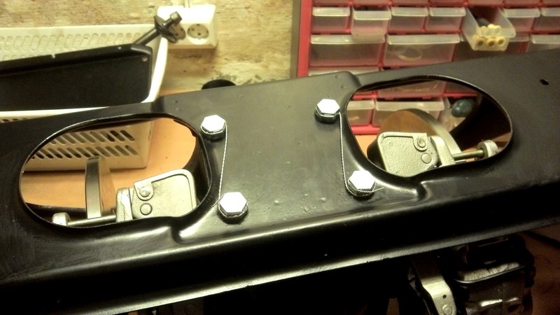

Putting the diff back inside the cage.
Safety wire in place

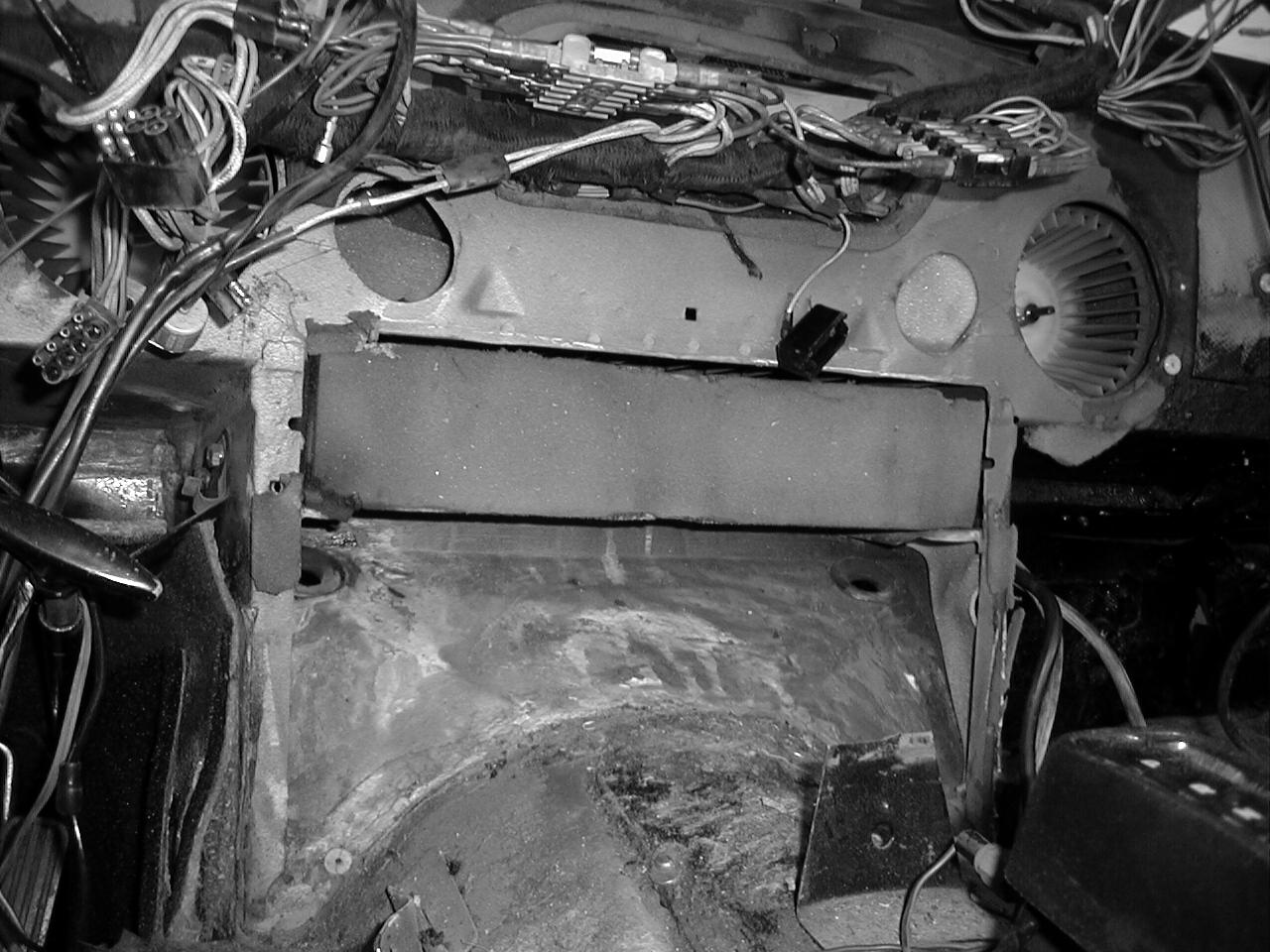

Having done both jobs and looking at another heater core job... I would rather rebuild the IRS again.
Check out where the heater core is in a S1 and what has to be removed... picture is black and white as it was from an old early phone.
Heater core is behind the foam covering in upper center part of the photo - is in an actual recessed "shelf". You can get an idea by
locating the RH heater/AC fan in the photo.

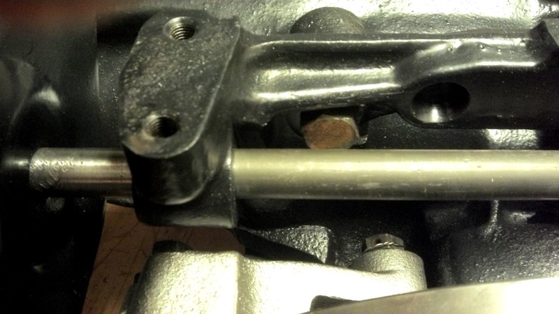

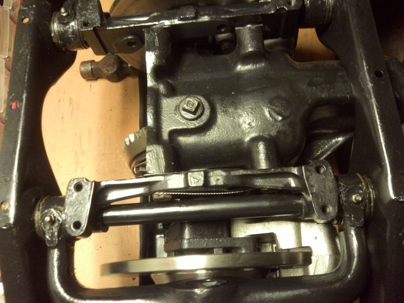

The fulcrums are lined up, shimed, torqued and wired

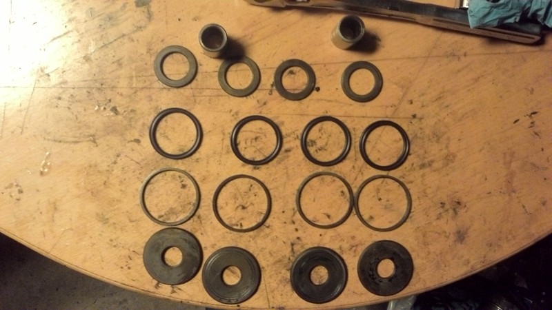

The variuos parts that go onto the inner wishbone. Rubber seal rings are new

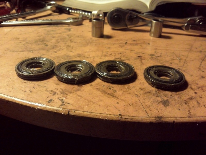

Stacked up and greased, ready to go in.

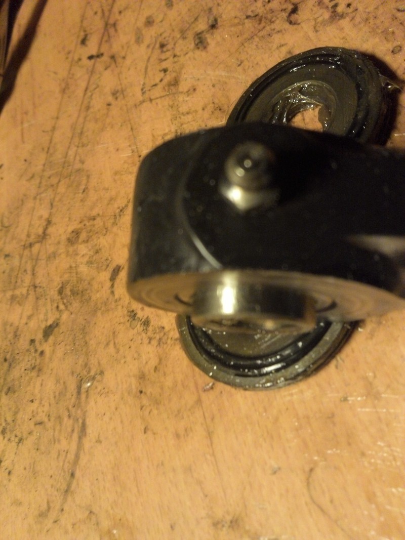

Metal sleeve goes inside the needle bearings

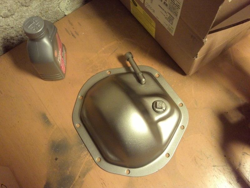

Diff cover painted and ready to go back on

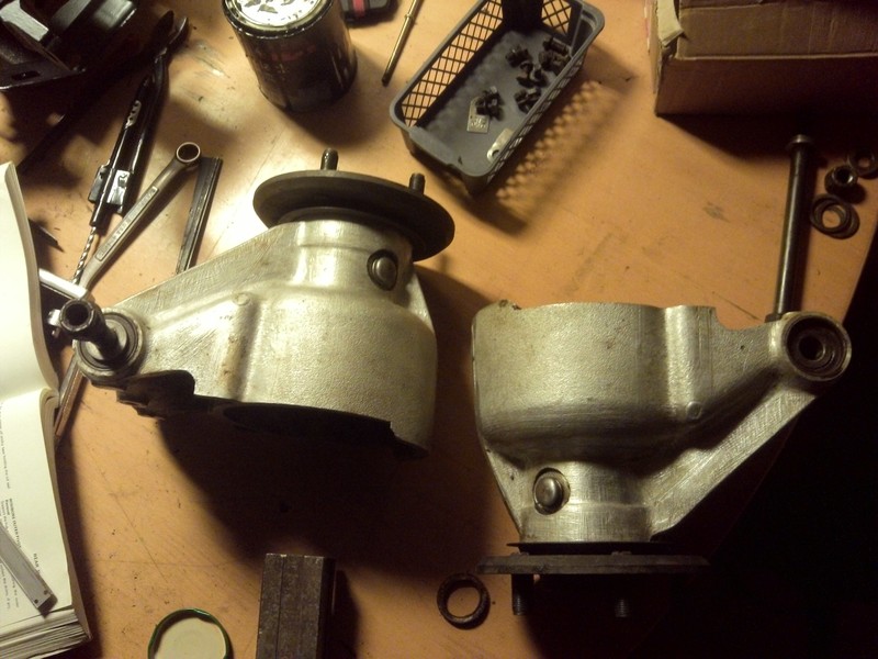

Hubs cleaned up quite nicely. Both fitted with new bearings and oil seals

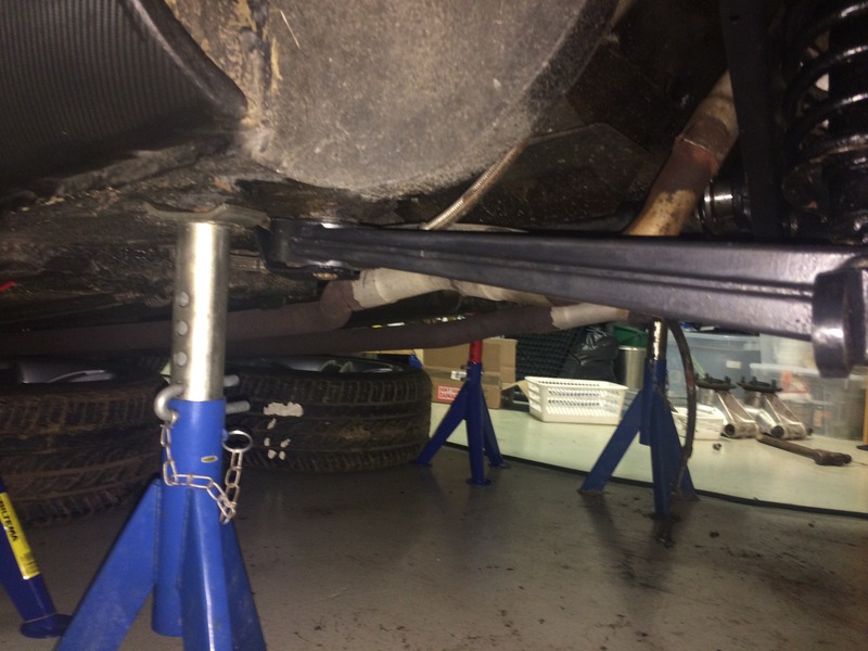

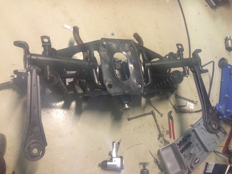

Got the IRS transported back to the garage today.
Diff cover mounted.
Half shafts back on.

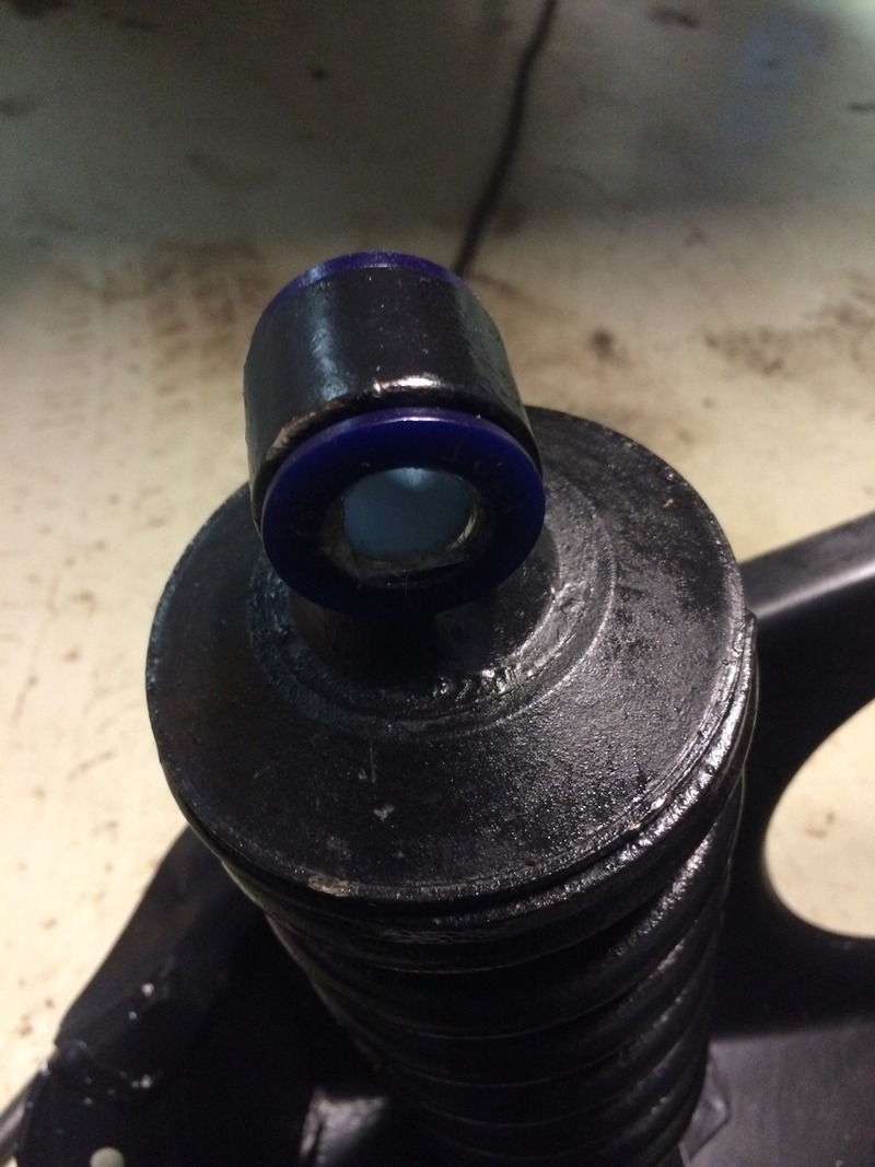

New poly bushes fitted to the struts
Preassembly Complete

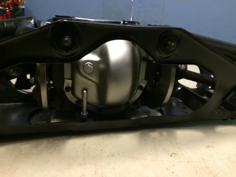

Ready to go in. Notice how I routed the exhaust pipes wrong. Took me a while to figure out why the hell the IRS wouldn't fit back in!
Got it right in the end!

Radius arms back on
That's as far as I got today. One more day of work now, and it should be ready!
