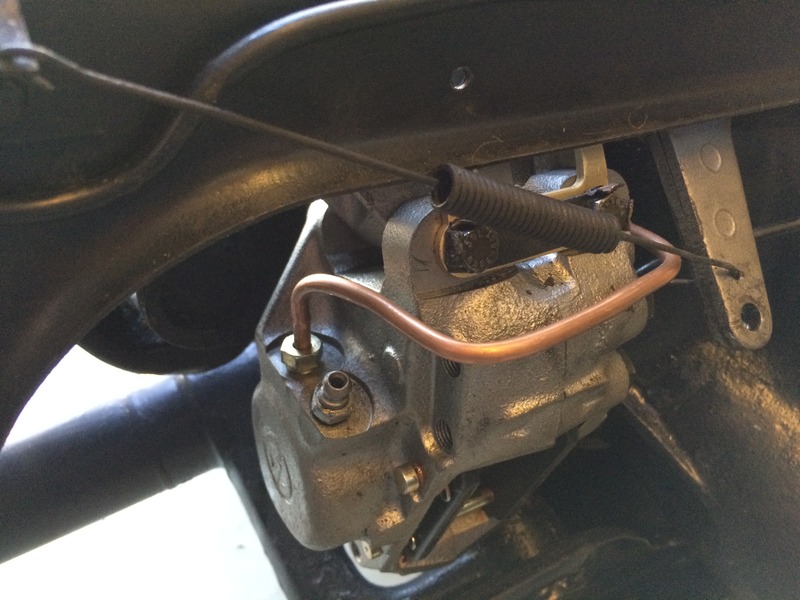

I had a bit of a set-back in my IRS project Monday last. As I backed the car out of the garage, brake fluid gushed out of a brake line on one of the calipers. I jacked it back up, and spent a few hours fiddling about with it. Time wasted completely, the fitting was stripped and there was no way it would come off with the IRS in the car. So I dropped it again. I wish I had done that immediately instead of fiddling about under the car for hours! It took me exactly one hour and it was on the floor
New brake pipe installed.

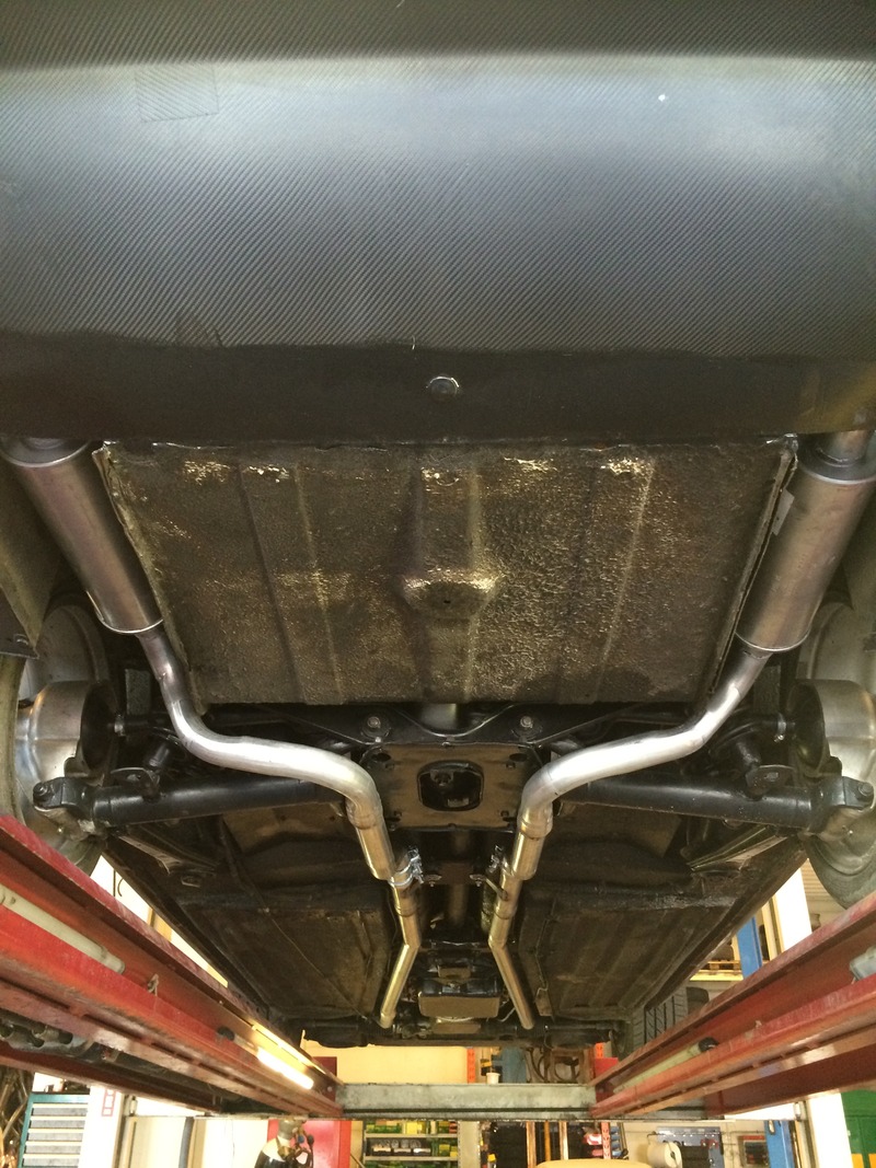

Finally I could back the car out and enjoy it! Wrong! The exhaust made a terrible racket, and it was leaking all over the place as well. I bit the bullet and had a new exhaust fitted. Routed under the IRS. Thanks Roger Mabry for putting that idea in my head! 😊

I am currently replacing that rear valance with a new copy from SNG Barratt so I can exit the exhaust under the IRS in my '71 car instead of just
underneath. PO had the original holes filled up and welded shut! It looks too odd for a Jaguar that way... will use the curved exhaust tips.
I plan to use ball clamps instead of flanges for easy removal for servicing the IRS should that be needed again (mine is already done).
It is a shame that all our hard work and paint is not shown while driving down the road!

Tor, what size mufflers did you go with? I will be wrapping up the engine portion of my project in the next couple days, lord willing, and the next move is exhaust. Since you were just there, i was curious how big of a muffler to get.
Thanks,
Seth
Old Apr 17, 2015 | 05:26 AM
  #51
Aviator-Olav's Avatar
Posts: 59
Likes: 16
From: Norway
Hi Seth. The tubes are 2" and the mufflers have appox 4" outer diameter.
They are straight through mufflers, they are loud! I wanted that low end V8 rumble so it was exactly what I was looking for, but it's not for everyone I'm sure!
