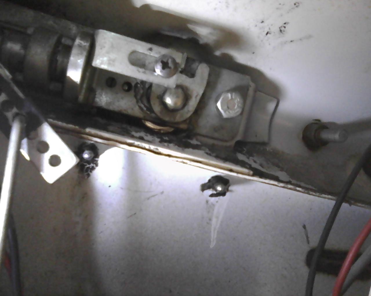

Here's the slot with small bolt installed.
Unfortunately my lock solenoid id dead. Oh well. Another item on the list!
DD
