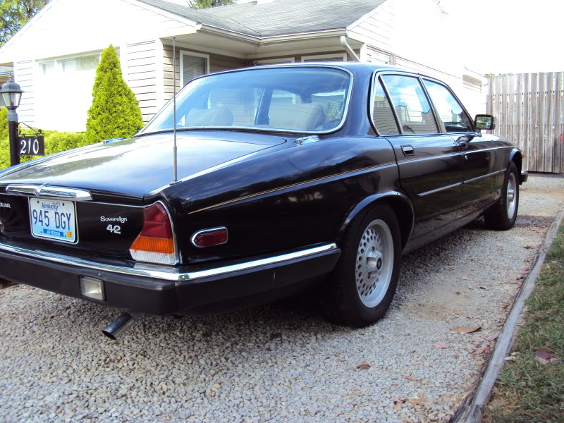

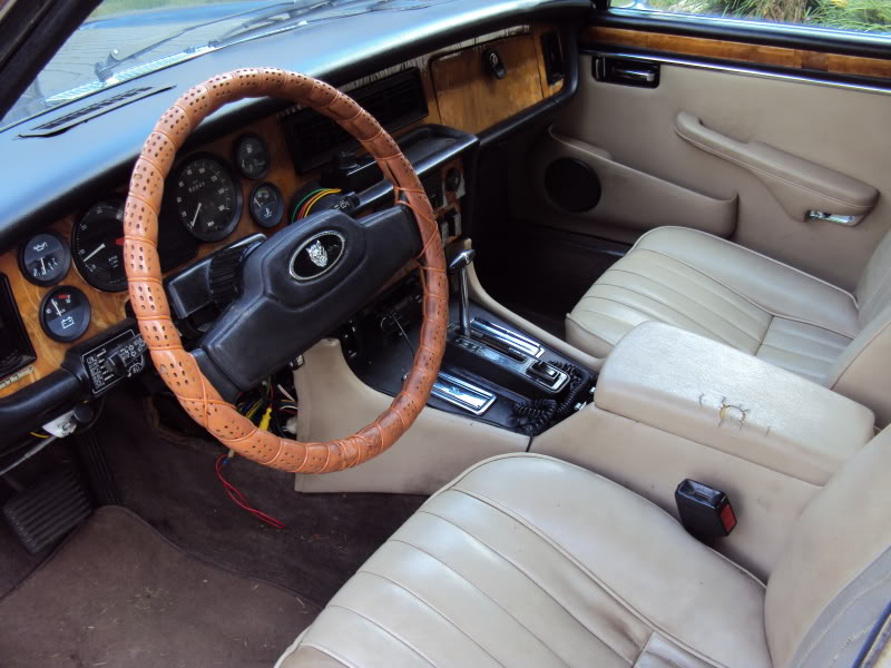

So I picked this up about three weeks ago. I pulled it out of a guy's front yard, and got it for a song. It's an '84 Sovereign 4.2. The exterior body panels are in great shape, and only has rust around the front and rear windshields (which is pretty much expected when looking at one of these). No accident history, and all panels line up nicely.

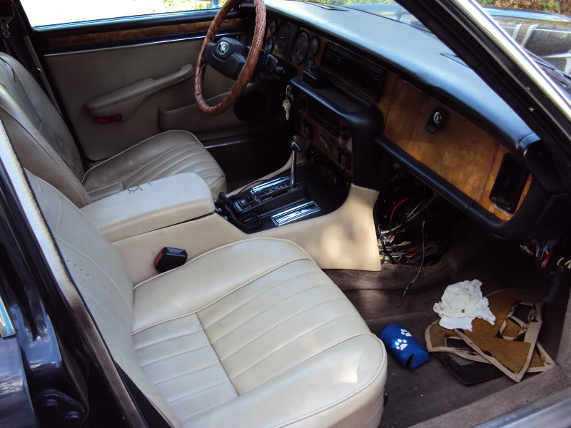

Now... the bad...
-The transmission is shot. It slips like a fat girl on ice skates.
-Most of the interior is no good to me.
-The climate control has been hacked by the midly-retarded previous owner(s).. (see: bicycle brake cable running through firewall to control heater control valve, RadioShack 5 position rotary switch wired into blower motors, etc..)
-Massive external leak from one of the fuel tanks.
-Faulty fuel return valves, causing the fuel return from engine to be fed back to the leaking tank (even when running off of the other tank), ensuring a constant rolling fire-hazard.
-Exhaust system is almost non existent.
But wait, there's more! After gutting the interior, here is how she looks..

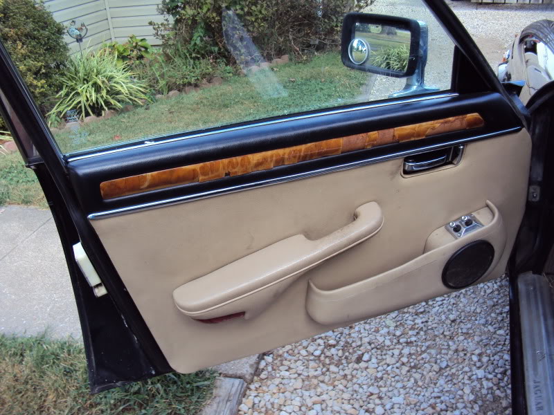

An '86 XJ6 I've had for ten years. Totaled via a treelimb through the windshield in January '09, which buckled the roof. Three times as rusty as the other car.
The good?..
-Rebuilt transmission with less than 4k miles
-New fuel system (pump, change over valves, lines, etc)
-Full functioning climate control components
-Solid floor-pans to be cut out and swapped
-New exhaust from downpipe back.
-New shocks all around
-Pads/rotors with less than 7k miles, new master cylinder
-New radiator
-Immaculate interior.. all wood re-veneered, dyed, and clearcoated in '02.
This will be a donor car, with thousands of dollars of like new parts. They will be pulled and saved, and then the shell will be hauled off and crushed (likely in the next couple of weeks).

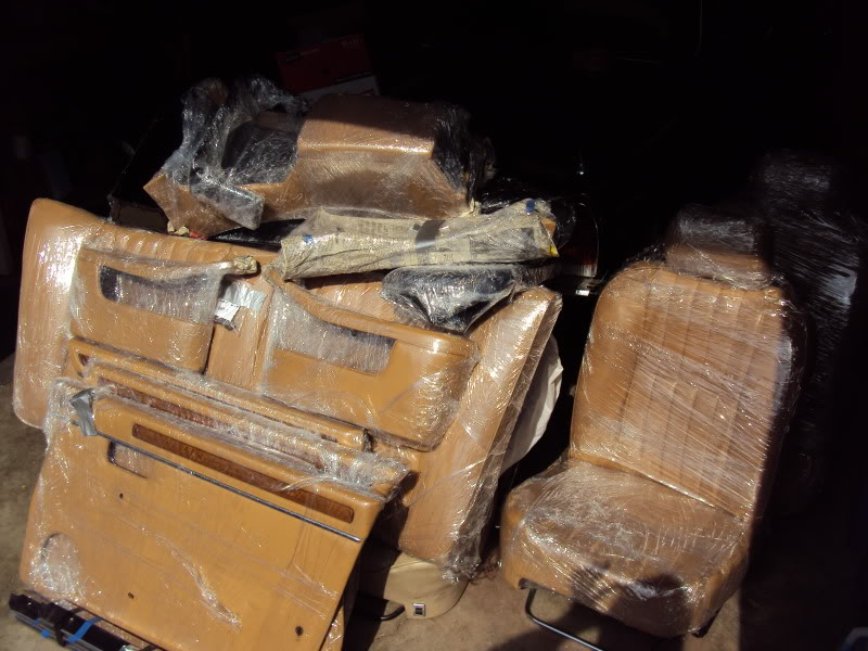

Seats, carpet, dash, etc. carefully removed, sealed, and put into storage.

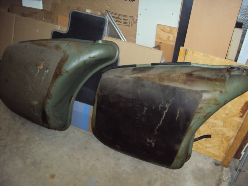

Fuel tanks removed.

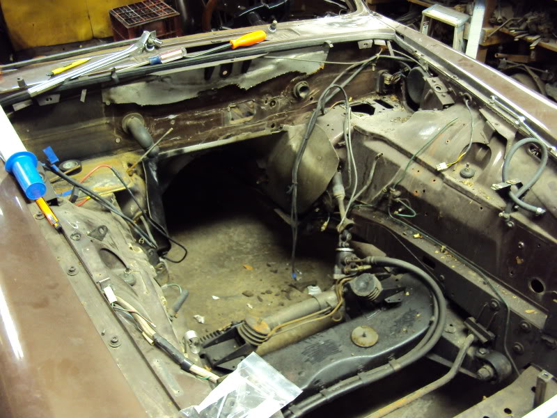

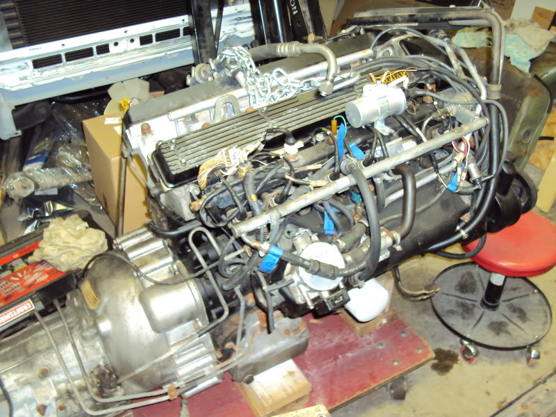

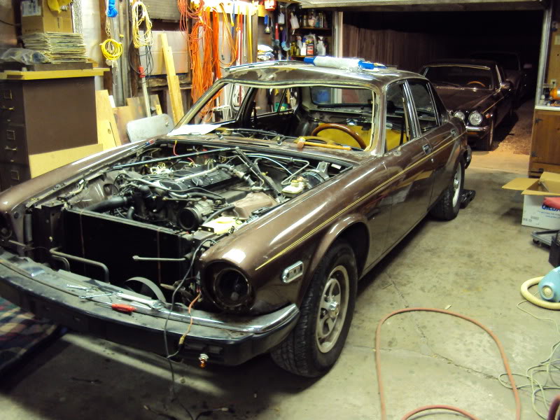

Thanks for the support guys! Engine/trans removed. Exhaust, driveshaft, various plumbing, complete wiring harness, hvac box and ducting, and blower motors removed. As usual, all carefully packed, labeled, and stored.
The last picture is of the climate control unit.. which for those that don't know, is an engineering marvel on its own. It's a circus of servos, microswitches, relays, vacuum actuators, adjustable linkages, sensors, mixing flaps, and various other switches and valves. It's like a rube goldberg machine from hell.
Next weekend I'm dropping the rear end, and busting the out plasma cutter to cut out the good sheet metal and small patch panels I need. Thanks for tuning in.

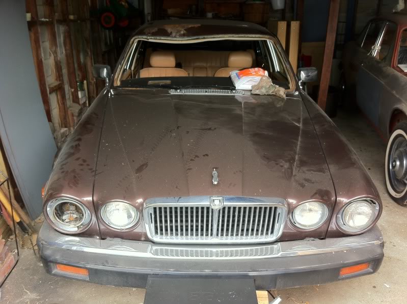

Yes, a great project and well worth doing. I have a soft spot for these cars, my own car being Claret red with doeskin interior. This brings me to my reason for answering, what ever colour choice you eventually make, ensure that it goes with the colour of your interior! SNG Barratt and several books describe the original interior / exterior combinations. I'd stick with one of those. When you finish, would you like to repaint my car for me?! Good luck, keep the pics coming!
Old Jun 24, 2011 | 04:34 PM
Fraser Mitchell's Avatar
Posts: 9,556
Likes: 2,555
From: Crewe, England
My, Oh My, have you been busy !
I noticed that the body of the totalled car is better than the one you propose to rebuild, (or looks that way from the pics). No way you can get the roof dent out, I suppose ?
