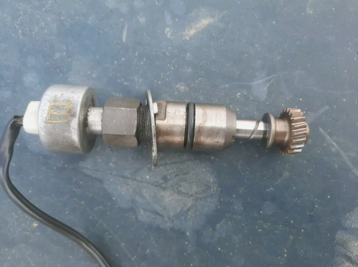

Is this the speedometer sensor?
Old Aug 10, 2021 | 11:12 AM
JagCad's Avatar
Posts: 6,796
Likes: 2,403
I think so!!!!
Never had to mess with mine.
Might check with David Boger for a used unit that works. swap it in.
Way out there. Might chcuk it in to a drill and see if the speedo responds??? .

That's the sensor. Take your time connecting the new one, It can be tricky - or at least mine was.

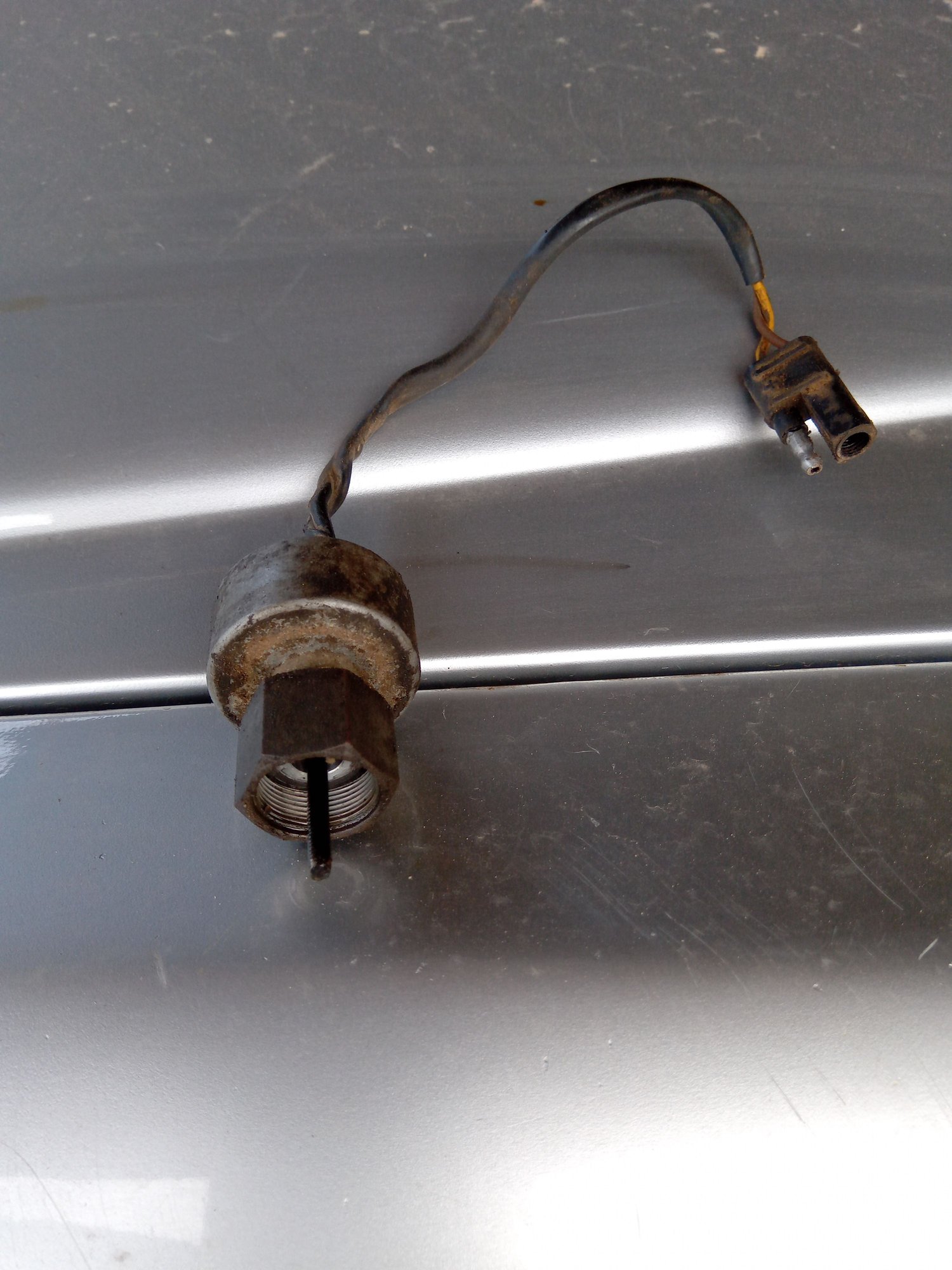

Hi Hktk,
The sensor is located at the driver side tails end of the transmission when the car is lifted , it has two wires as seen in the photo I posted previously.
It is easier to be seen when the car is lifted.

Bad news on speedo sensors right now. Most online resellers are getting their speedo sensors from Eurospare. Unfortunately Eurospare is shipping part # DAC4569 (sensor for the XJS & V12) in a bag labeled DAC4570 (sensor for the XJ6 S3). I am on my 4th attempt at getting the correct part.
The DAC4569 has a 1-1/16" connecting nut with an id that is too big to fit the XJ6 nipple - the nut is almost as big as the sensor body. The DAC4570 is a 7/8" nut as shown in the photo earlier in this thread. Unfortunately, all the resellers have the correct photos of the parts on their site - you can compare them - but so far the parts I have received don't match the correct photo. If you can, buy from someone who has the actual part in hand, especially if it's sourced from Eurospare.
