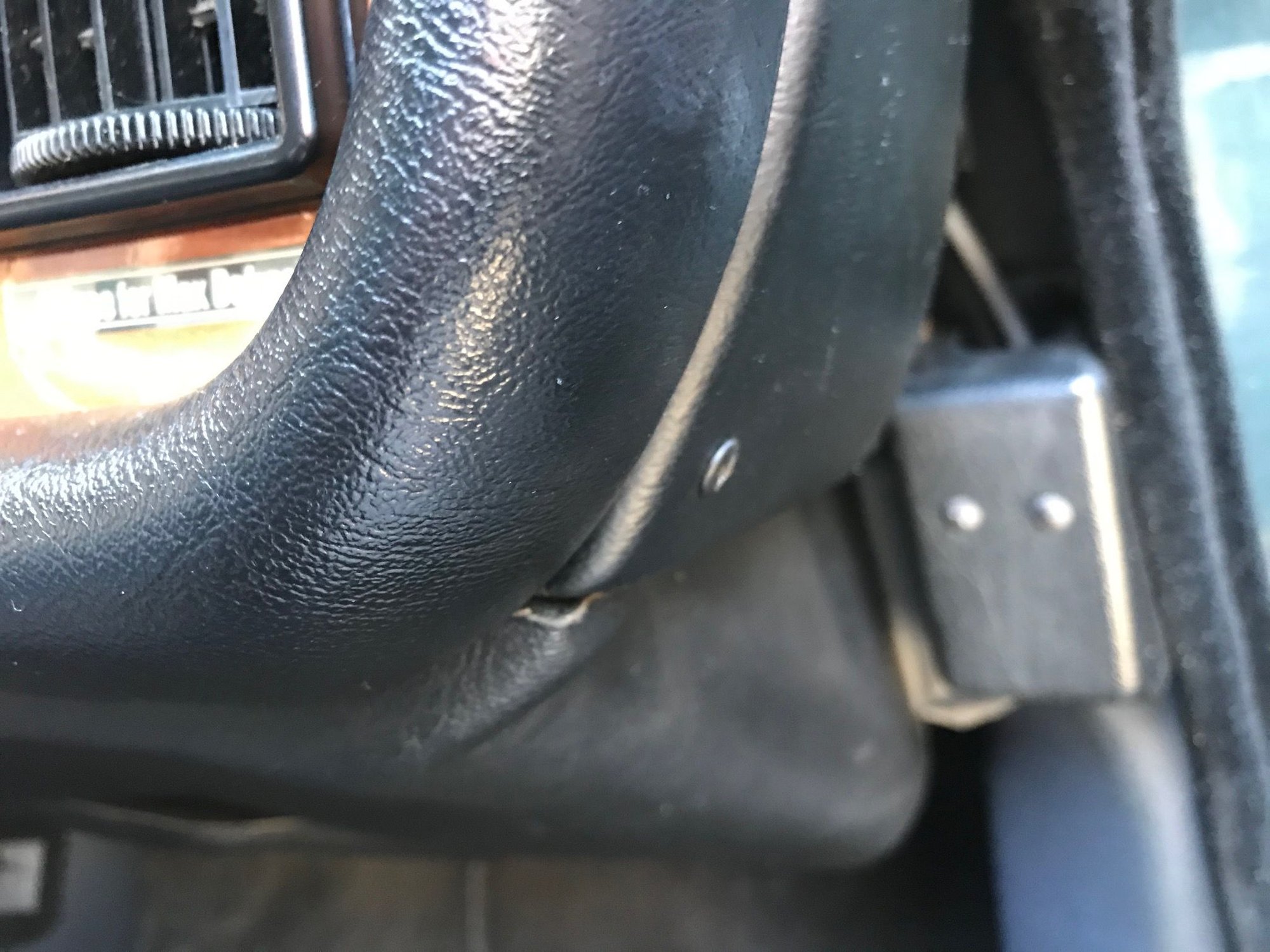

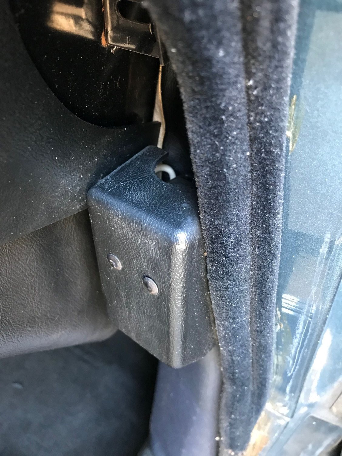

I haven't had my '86 XJ6 long enough to know for sure, but I've had an MGB for decades and once faced the same problem. I had hit a large pothole and the car shut down completely after driving not that much farther. The sudden jolt of the pothole turned off the inertia fuel switch, just as it's designed to do when involved in an accident. I assume XJs have a similar switch somewhere. I'm sure someone here can confirm this if it does. Hopefully it's just that simple.
EDIT:
I looked at my '86 and found the fuel inertia switch...it's much easier to get at than it was on an MGB. Open your right hand front door. It's located right in the open, in the doorjamb, right next to the dash. It's the small black plastic box in the photos attached. You'll see the top of this box has a large semi-circle opening. With a flashlight you can see there's a plunger that will be all the way down to supply power to the fuel pump. A heavy jolt, such as from an accident or even a severe pothole, will turn off the power to the fuel pump. In this case, the plunger will be popped up. If you can't tell if it's up or down, pull it up and then push it back in. Sorry about the poor quality photos. Good luck!

hey guys, so after a bit more testing the car started for maybe a second before dying again to clarify there is Zero compression with that piston i know that the thumb method isnt accurate but it worked with all other pistons except this one it seems unfortunately its probably going to be the valve on the bright side the head had a guarantee on it so if that is the problem we can get it fixed free, im going to go ahead and check that inertia switch aswell although i dont think its a fuel problem but thank you all for the help means alot!

UPDATE, After following the advice of Emily Wojcik (Thank you by the way) the car miraculously started to run but something is very clearly misfiring so i didnt leave it running for long i came back a little while later to try it again and it sat there and idled by itself and didnt turn off i didnt leave this for long as fear that i could make the problem worse by running it very odd stuff.

Mar 15, 2020 | 05:58 PM
You're welcome and glad it worked. If you hadn't mentioned the pothole I wouldn't have even considered the inertia switch. It may be misfiring due to the disruption in fuel supply although I don't know how likely that would be, but I think it would be a big coincidence if the car developed an unrelated issue at the same moment the fuel pump shut off. Could the sudden lack of fuel have dislodged debris, clogging injectors? Hopefully others will have a better idea where to go from here.
