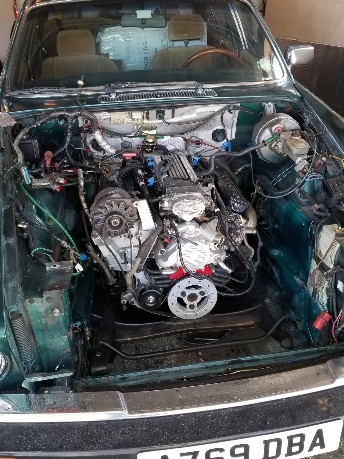

I managed to get motor in over the weekend... This is a Young mans game!! Everything hurts this morning!!! Lol
only took a couple.of hours, but doing it alone is a lot of up and down, under car, on top, back under, back on top, I swear I walked at least 3 miles just in the few feet between the front bumper and the spot where the trans crossmember is!!!

Oh, what fond memories of the times that I could and did the routine..
Darren. That picture recalls that stage in my installation. But, you are making great progress.
Look forward to the time you twist the key and are greeted by 8 happy cylinders sans any exhaust...
