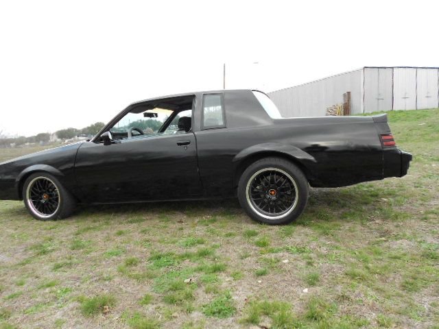

good choice a GM LS2, put one into a 1985 Buick GN ,,4L80e,, great combo and no more blowin those V6 turbo engines(2) all over the street/tracks!
ron

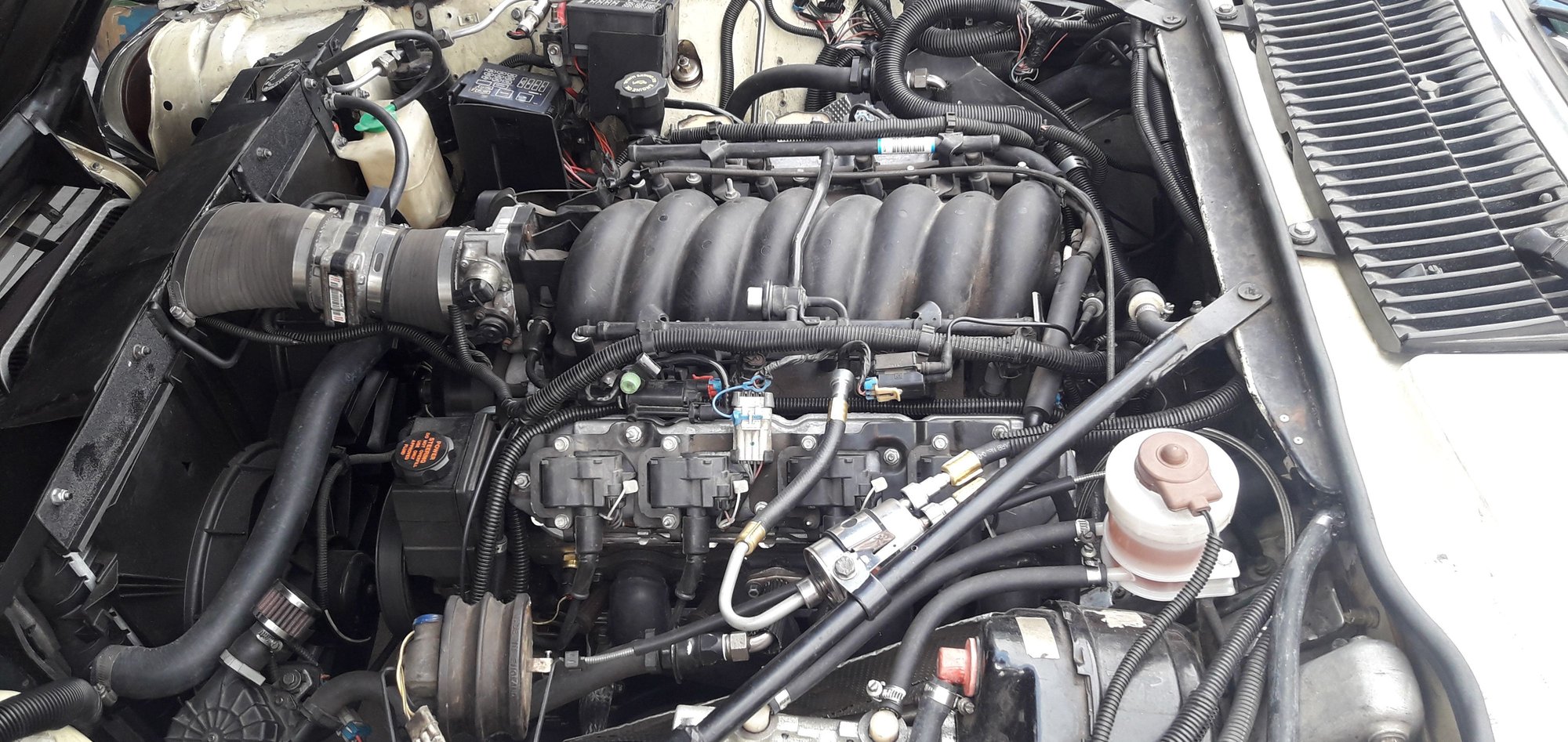

Although not an XJ6, I thought you might want to have a look at our (nearly) completed 88 XJSC with 2002 Camaro LS1 and 6speed manual trans. The car is up and running and even with a basically stock LS1 (325hp) and the 3.54 gears (from late XJS rear end with OB brakes) the car is a rocket. Great shifter action, factory level clutch pedal effort, etc. I can only imagine what it would be like with a few LS modes like cam, porting, tuning, etc.,. getting up and over the 400 hp mark. In the pic below the only thing left to do is the AC hookup...That air intake BTW is a California legal high flow setup from K&N - brings in nice cool air from in front of the AC condenser....
Part of the big bump in performance of the car in general is the weight loss using the LS. I had it over at the smog shop where they have a scale and it came in at 3315 lbs with a 1/4 tank of gas and a 180 lb driver inside. That's approximately 400 lbs lighter than a stock V12 automatic XJS. I would expect a 150 lb or so weight savings using an LS in an XJ6...
While we have worked with several hundred customers on LS-Jag conversions over the years, this is actually our first in house manual-trans XJS conversion. I am really happy with the results... And all of this info goes back into the brain trust to be available for customers interested in doing the same thing on their cars.
One note- the engine will get some nice top covers to hide the wiring, fuel rails, etc.,. so the final look will be even cleaner than here.
For anyone interested, the whole buildup is here (Jaguar Specialties) and I am adding new installments periodically-
