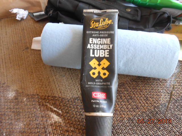

Parts stores don't carry Assembly Lube because No One ASSEMBLES things anymore!
Automotive DIYers are a Dying Breed!!
Come to that, Any DIYers are very rare.

I recently (2 months ago) rebuilt a Mitsubishi V6 engine for my son and I purchased Assembly Lube from Oriellys (Melbourne FL). Just for the hell of it, I went to Oriellys yesterday and they had it.
On the Plastigauge, I agree with Darren. if you ever bought a milled crankshaft, it comes with plastigauge for checking your final clearances.
When I rebuilt my 350 engine, I took my crankshaft and engine block which were in excellent condition to my machine shop (Rank Engineering) for them to polish the crank and hone the block and they still gave me some plastigauge for when I was doing the final assembly.

This graphite/ Moly paste stuff should never be used in modern engines. It's left over technology from WW2 aircraft which ran hot, had large clearances and basically had screens for oil filters. It does stay in place so it was ideal for engines that were built back home and then took months to reach their destination by ship and then may have sat for months or years in the theater of operation perhaps to be moved again at some point. The GI's brought home this and many other learned practices like supercharging, using parts you had access to no matter the brand, 100 octane (AV GAS) and methanol injection.... and right there hot-rod'ing was born.
Although I am young and have no direct experience this is my understanding from talking to many older engine builders and vets at air show back in the 80's and 90's. In recent years there have been fewer and fewer 1st hand sources at these events. I did meet the of one the pilots at the controls of the Air Plane that dropped the 2nd Atomic Bomb on Nagasaki at an Air show at Floyd Bennet Field in Brooklyn NY some time in the late 90's. He few in a replica of the Enola Gay which was the 1st plane to drop an atomic bomb. No-one knows the name of the 2nd plane becasue after the first... the horrors of war were more clear and may not have been celebrated in the same way. As for the pilot...We spoke briefly, shook hands and I observed. It was illuminating to see this person as an old man long past his prime and having been on the forefront of one of the most defining moments in American history.
Back to lesser things...
In modern engine with tight clearances and media mesh filters the graphite clogs filter and prevent the oil wicking action that properly coats bearings. Years ago mechanics used this stuff and just flushed out the system shortly after a quick break-in period when oil was cheap and you just dumped it somewhere. Now-a-days with roller lifter and modern oils it's not ideal.
Originally Posted by sanchez
Today's modern engine builder uses modern assembly lubes with no graphite and far less dry moly. The tools for pre-oil pressurization just prior to start up are commonly available now. The thick oil type of lube is what to use, a product like Lucas assembly lube. In a pinch a simple thick oil like additive STP oil treatment or motor honey is sticky and will say in place under regular conditions and will suffice in a jam.. All these modern products can stay in the engine util the first oil change.

@ icsamerica: you are quite correct re assembly lube with moly. I was told to flush the oil after the break in period, which I did after about 100 miles so I initially used 5 quarts of bulk oil I purchased from a friend of mine who owns a repair shop. On my engine, I primed it using an old distributor shaft attached to a drill, before I started the car.
As you stated, it is not really necessary to look for assembly lube. STP oil additive or any other, will work just as well.

I have used white lithium grease in the past with no ill effects, however I knew engine would be fired within 24 hours of assembly, this engine may very well sits for a month or two before its installed and fired..
My lube is supposedly sitting outside my front door now (per amazon) so I'm good!
Maybe if wife is doing ok this evening I will get to play a little.. I turned A/C on in garage before I left this morning in anticipation..

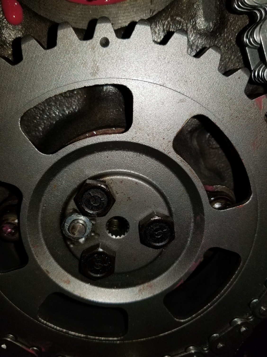

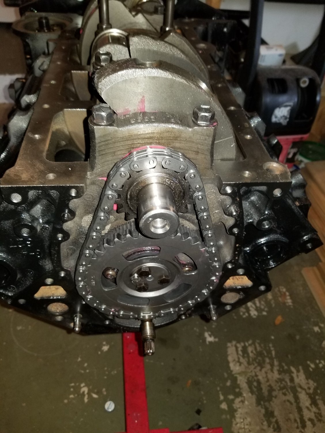

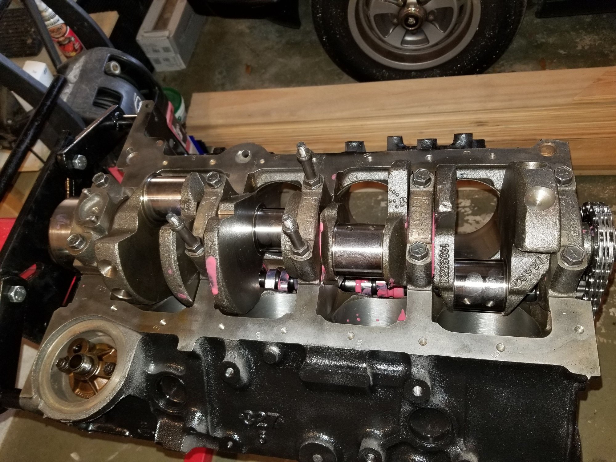

Made some progress over the weekend, got crank in cam and timing set (after drilling cam gear for 2 degree advance bushing), also got 6 of the pistons in... and then came to a screeching halt!!!

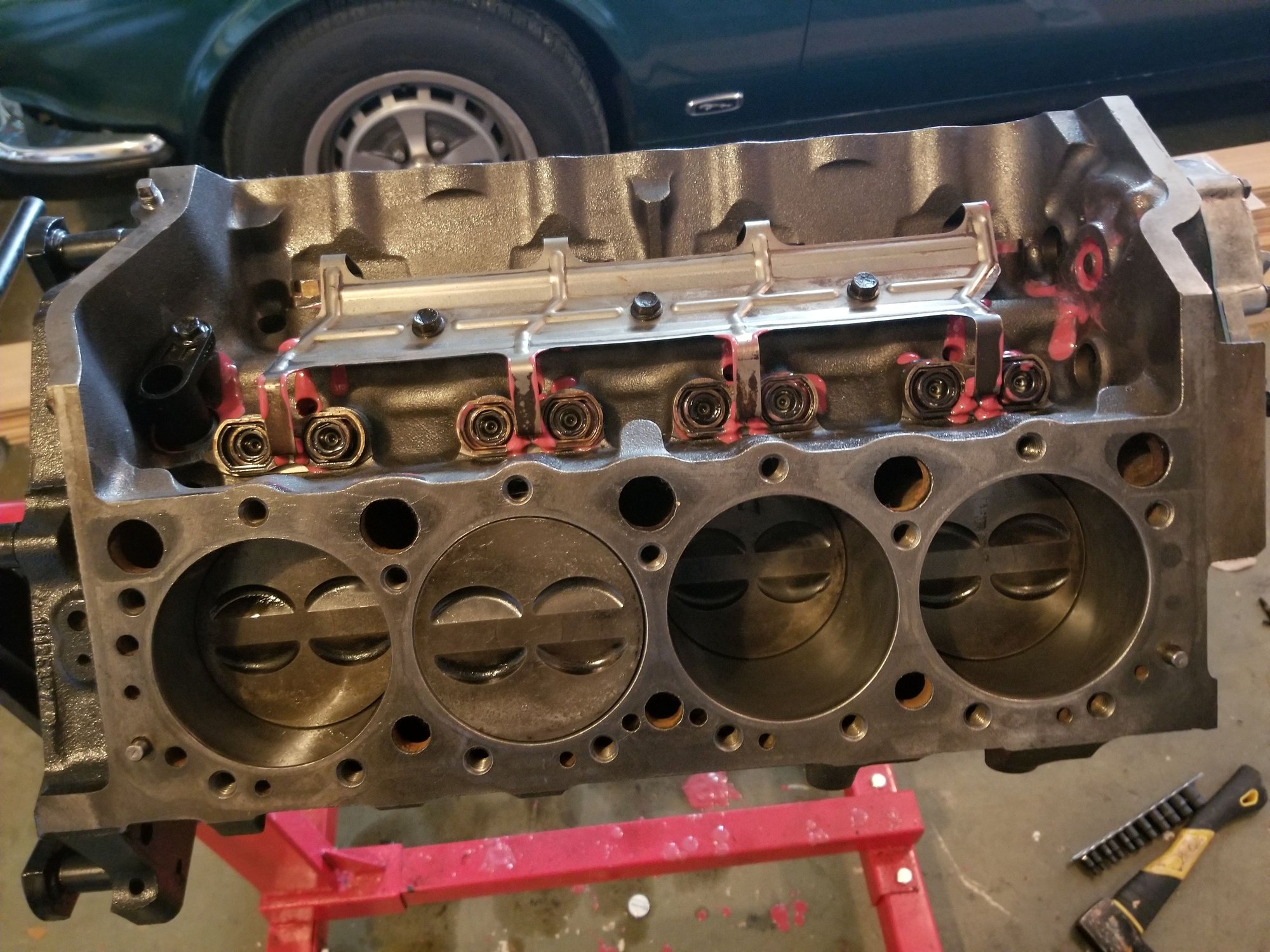

Being as bore was not changed I am reusing the original pistons, after having machine shop check the one I thought was cracked (its not), I cannot get the rings off of the two remaining.
One has entire top ring still on it and compressed into groove with no means of grabbing it, and other one has 1/4 of the second ring, same scenario... I am now soaking them with hopes they will just pop free!!! Heres some pics just to keep it interesting
Crank in!
Timing gears done and cam advanced 2 degrees ( per what i found on impalass forum for running lt4 hotcam with heavy car)
Close up of 2 degree bushing... drilling that gear is no joke!!
All pistons back in on this side...and lifters installed too.
Timing cover bolted back on, yes its early version with spline drive for opti, but car doesnt really see rain so not a big deal and another trick i read about is to thread a nipple into water pump weep hole to divert it if it develops a leak, so i should have no issues .
