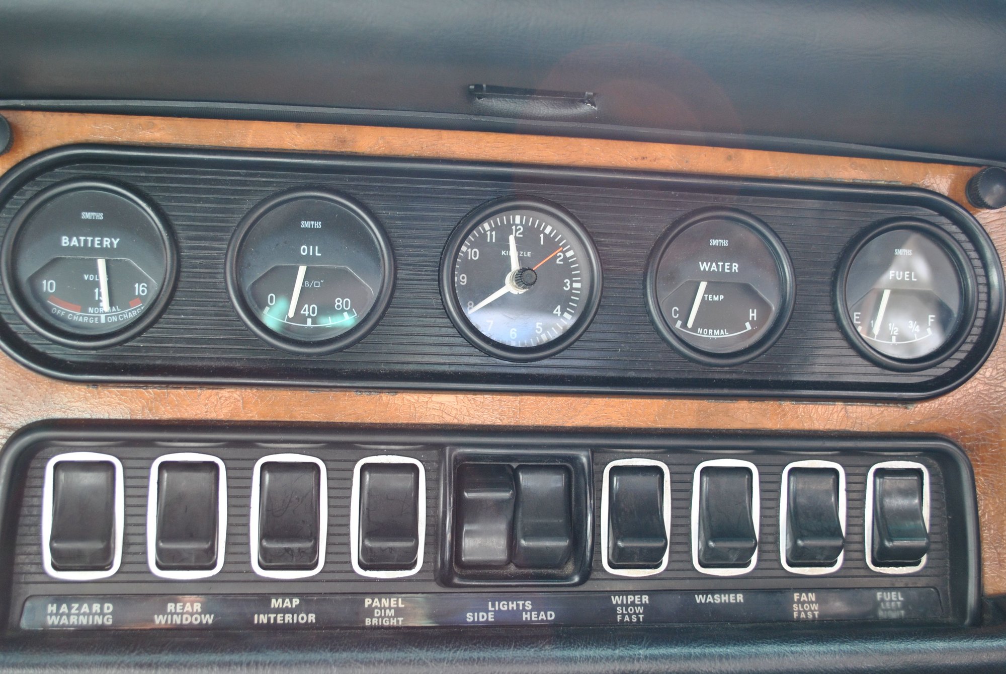

I'm not sure of F temps, but mine runs near the cold mark all the time. ( around 70 degrees C), On a hot day in Queensland (45C outside) It might rise to 80 C.
Stuck in traffic on a 45 C day it might rise to just below the "N" at the start of normal on the temp gauge.
The only time it got to the "L' on normal I pulled the radiator and had it checked, it was a bout 50% blocked.
This photo was taken during a 25 minute run at 110+ mph on the Newell Highway in mid winter temps (20 c for us). But even Grant Francis says my car runs unusually cold. I'm good with that though.
