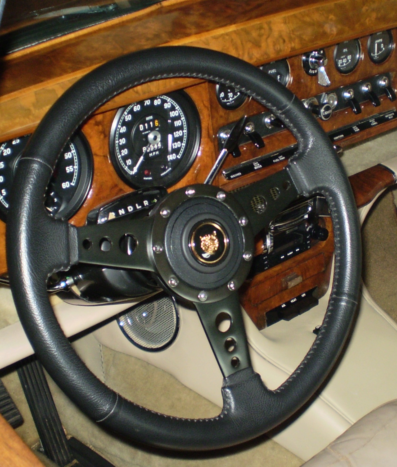

try Moss Motors in Goleta California, they have a selection of very nice aftermarket steering wheels called "Tourist Trophy". Made in China but excellent quality. They have thick or thin grip, 15" or 16" diameters, and wood or leather.
I installed a thick grip, black leather, 15" diameter Tourist Trophy in my 1965 S type to get rid of the 17" "school bus size" original steering wheel. Moss Motors also sells the boss kit and horn-push kit.
