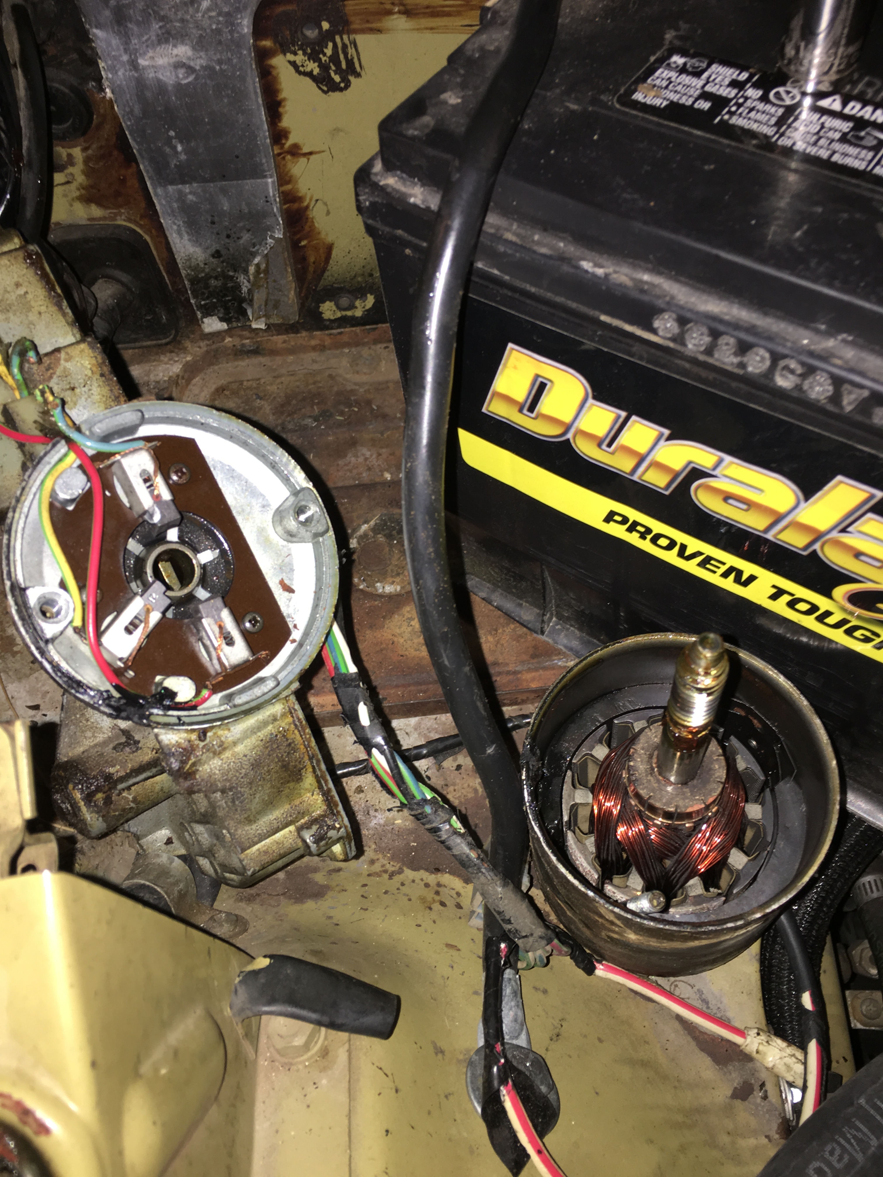

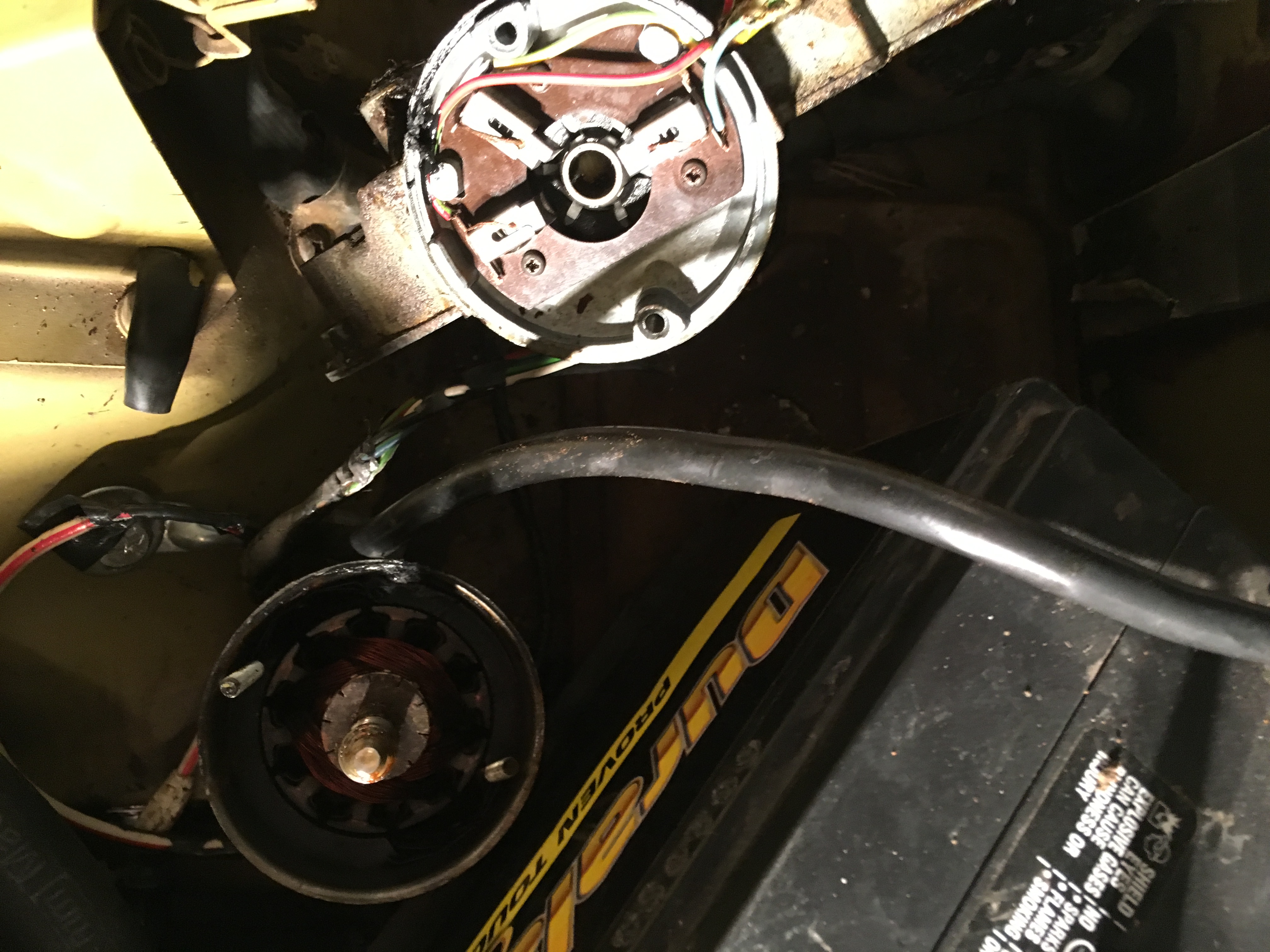

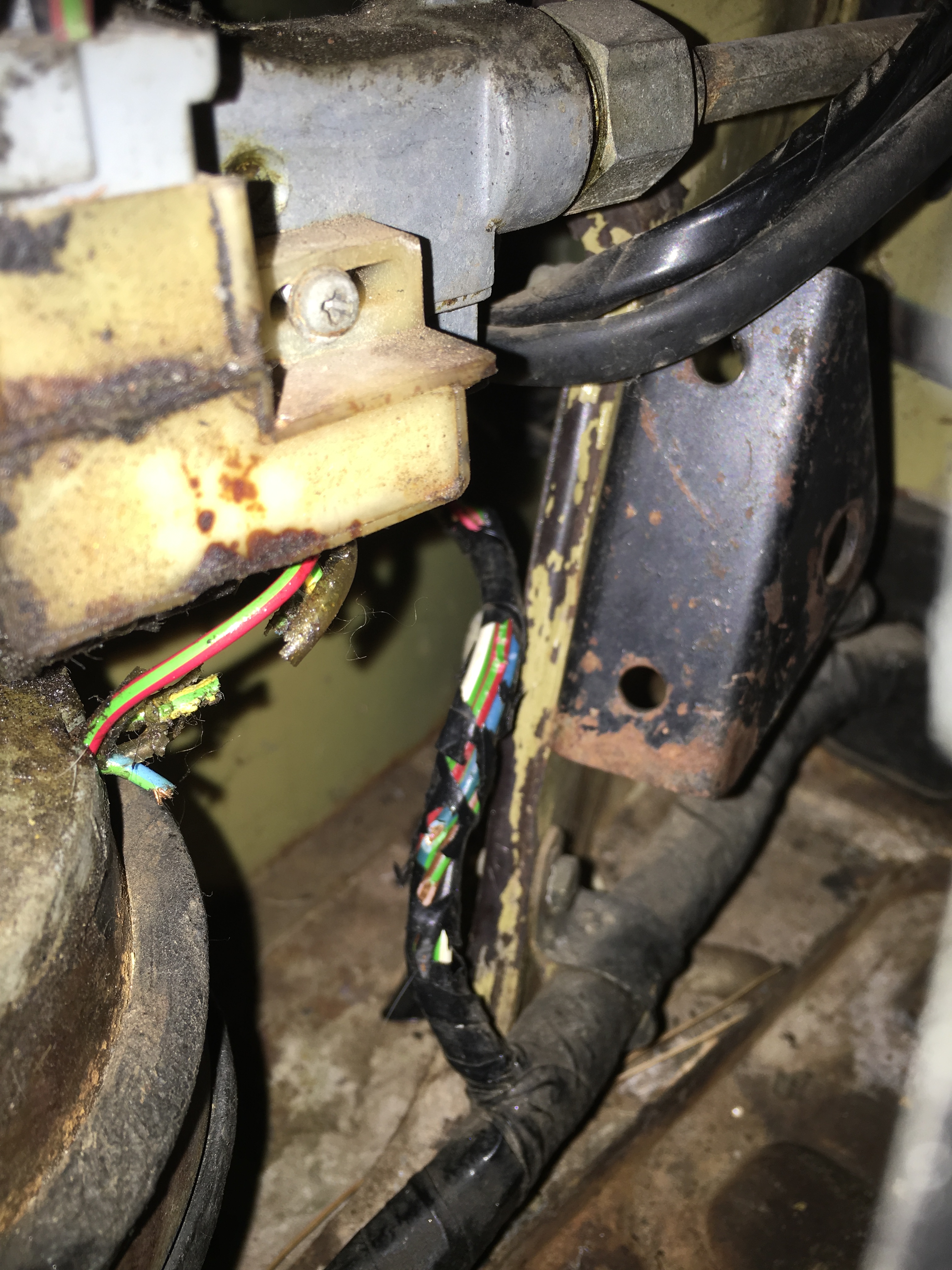

My '73 XJ actually sat from 1988 until 2016 when the second owner purchased it at auction. He did a lot of work on it last year then sold it to me. He said the wiper's didn't work and today I found out why. The Barn had Rats and they apparently like wiper motor wiring.
I removed the motor and re-soldered the wires. The motor was seized to from sitting most likely. I got it all cleaned up and back together and I now have fully functioning wipers that Park! It was a good day.
