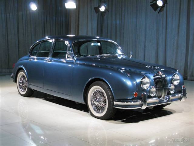

This is the most breath taking car I have ever seen I would love to have a Mark 2 LOL! so want it LOL!

Agreed, the variety and style of all the old saloon cars is amazing. The particular example you showed is a timeless beauty. Anybody say that about an XF ??
