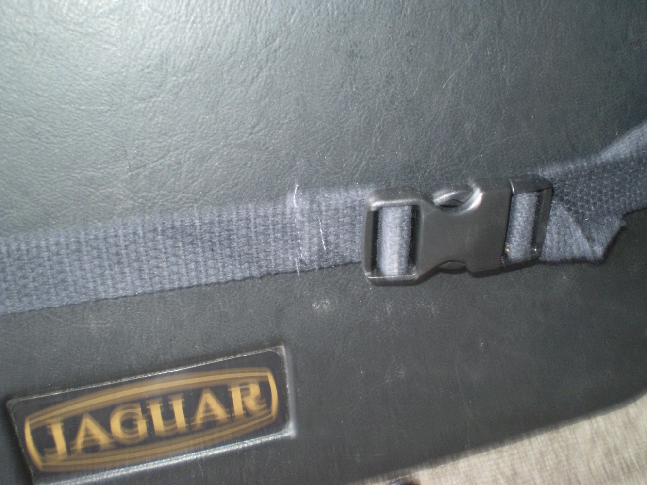

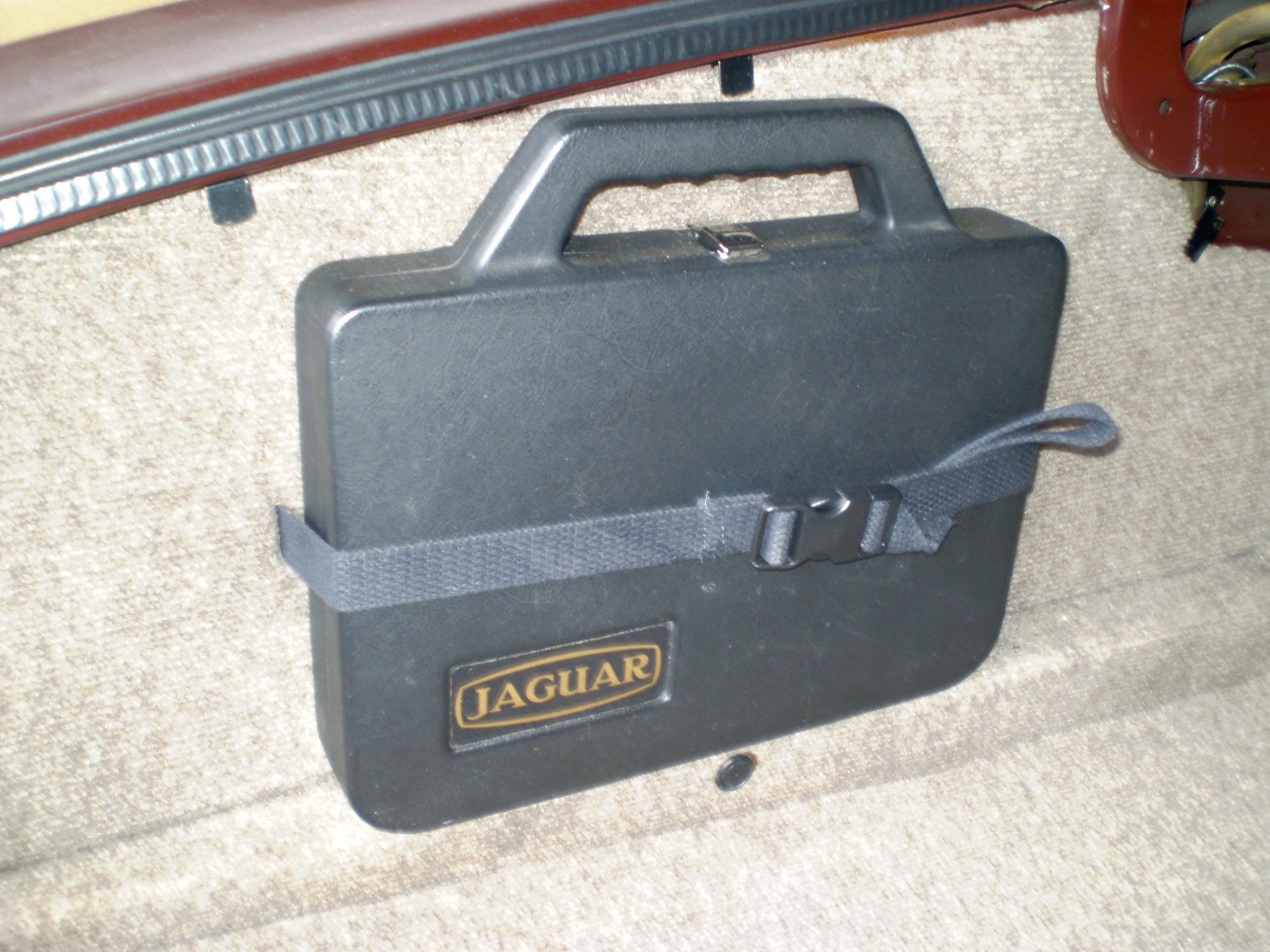

I had forgotten that I had also modified my strap. I just realized it today. My apologies but I put my car in storage 15 months ago and I am just getting back to it, the good news, the battery maintainer kept going all 15 months and still kicking!!! It saved my Interstate battery and the engine started after putting fresh gasoline.
ok, so today I opened the trunk for the second time and guess what? I looked at the strap and toolkit and BAM it hit me! I had removed the factory strap because I was fed up with not being able to make it tight enough to keep the toolkit from sliding.
here's what I did: you know those buckled straps that come with luggage? Plastic buckles and cloth straps. I took one of those and used it for the toolkit.
here's how I did it: I measured the distance between the factory "bracket" that protrudes on the side upholstery panel, and the opposite side of the toolkit case.
I cut another hole opening, same width as the new strap,
I inserted one end of the strap through the hole, ran it behind the chipboard panel, and came out the other hole. Presto! That's it. I rethreaded the buckle to the strap (one of the buckles is always removable), and now I can tighten the strap by just pulling it.
see the pictures.
Attached Thumbnails Boot / Trunk Toolbox Strap Replacement-01-toolkit-strap.jpg   Boot / Trunk Toolbox Strap Replacement-02-toolkit-strap.jpg

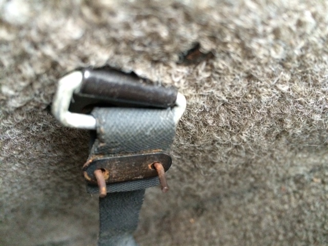

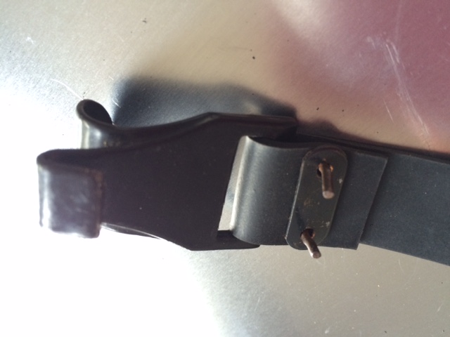

So Jose,
You fashioned a retaining strap for your toolbox. OK.
From your photo, the toolbox is now on the left hand side of the boot (trunk).
I am assuming this is where the jack cloth fabric strap was? OR does this vary with US spec'ed cars?
I note that Lnrb has her jack strap on the left hand side.
I have never seen the toolbox factory fitted on the left hand side of ANY Australian Series Three cars
Furthermore, with the Australian delivered cars, there are two specific mounting points for the toolbox strap on the trim panel wall
1; An anchoring point rearward for a buckle to accommodate the fixed end on the strap
2; A raised metal 'A' shaped pressing forward (towards the lip of the boot / trunk opening) with a slot cut in it for the 'loose' end of the strap to fit into to restrain it
Cheers,
Nigel
PS As for onboard Pneumatic jacks, a lot of weight and space for an occasional use?
Attached Thumbnails Boot / Trunk Toolbox Strap Replacement-boot-old-boot-strap-open-pin.jpg   Boot / Trunk Toolbox Strap Replacement-boot-new-strap-place.jpg   Boot / Trunk Toolbox Strap Replacement-boot-strap-clip-almost-there.jpg

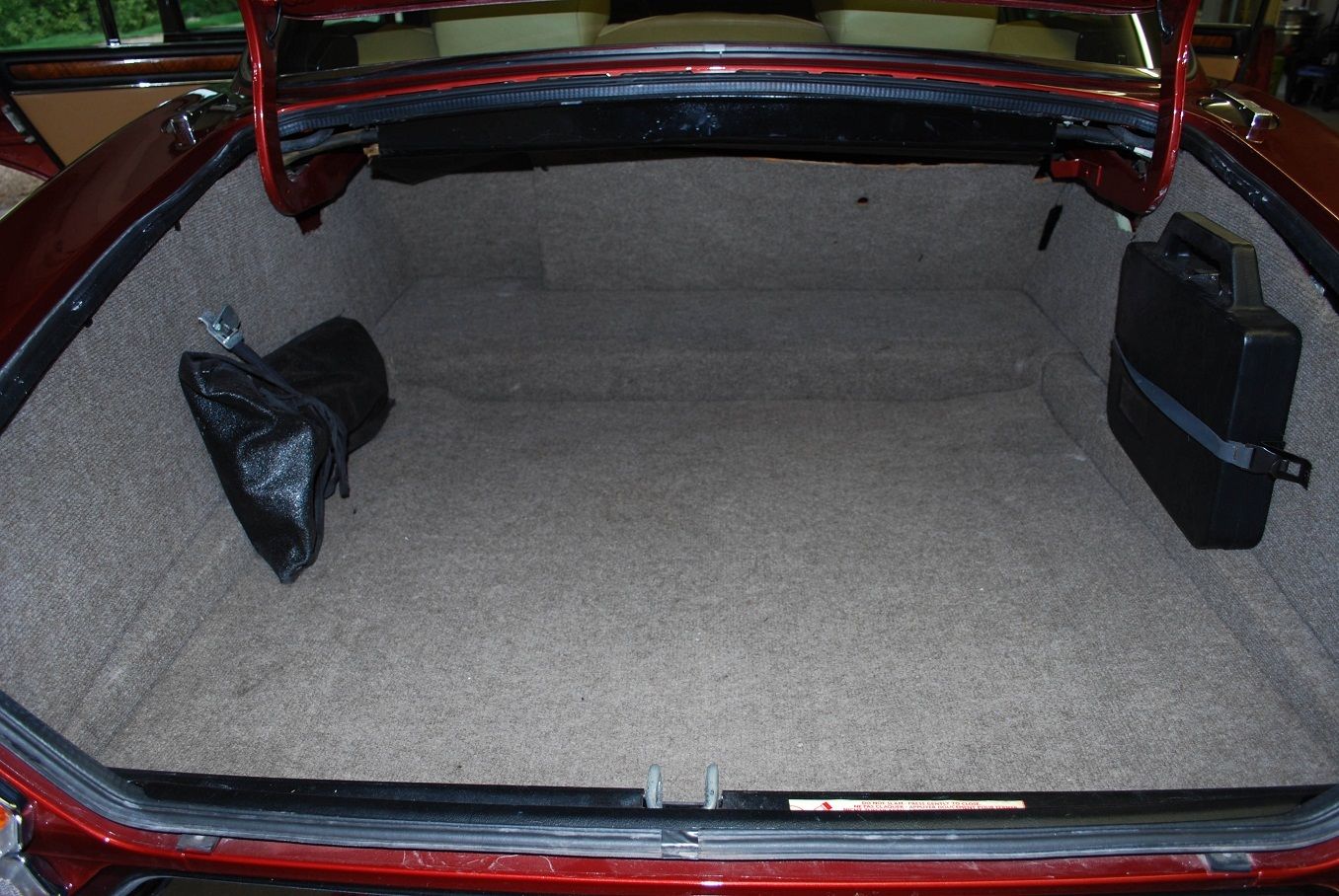

Nigel,
the way you describe it is correct, same thing in my car.
but if you remove the opposite side upholstery panel, and you look at the back of the chipboard, the markings for the cutouts are there, because that is where the 12 cylinder XJ have their toolkit, on the opposite side of the jack bag. And also, where the XJ-6 has its jack bag in Australian or RHD cars.
My jack bag has always been on the left side, the strap was bolted where you can see a round black plug under the toolkit. It was vertically mounted until I did the horizontal mounted strap.
the jack bag is now in the spare tire compartment, I modified the spare too. See the next pictures.
Attached Thumbnails Boot / Trunk Toolbox Strap Replacement-xj12-toolkit-mounting.jpg

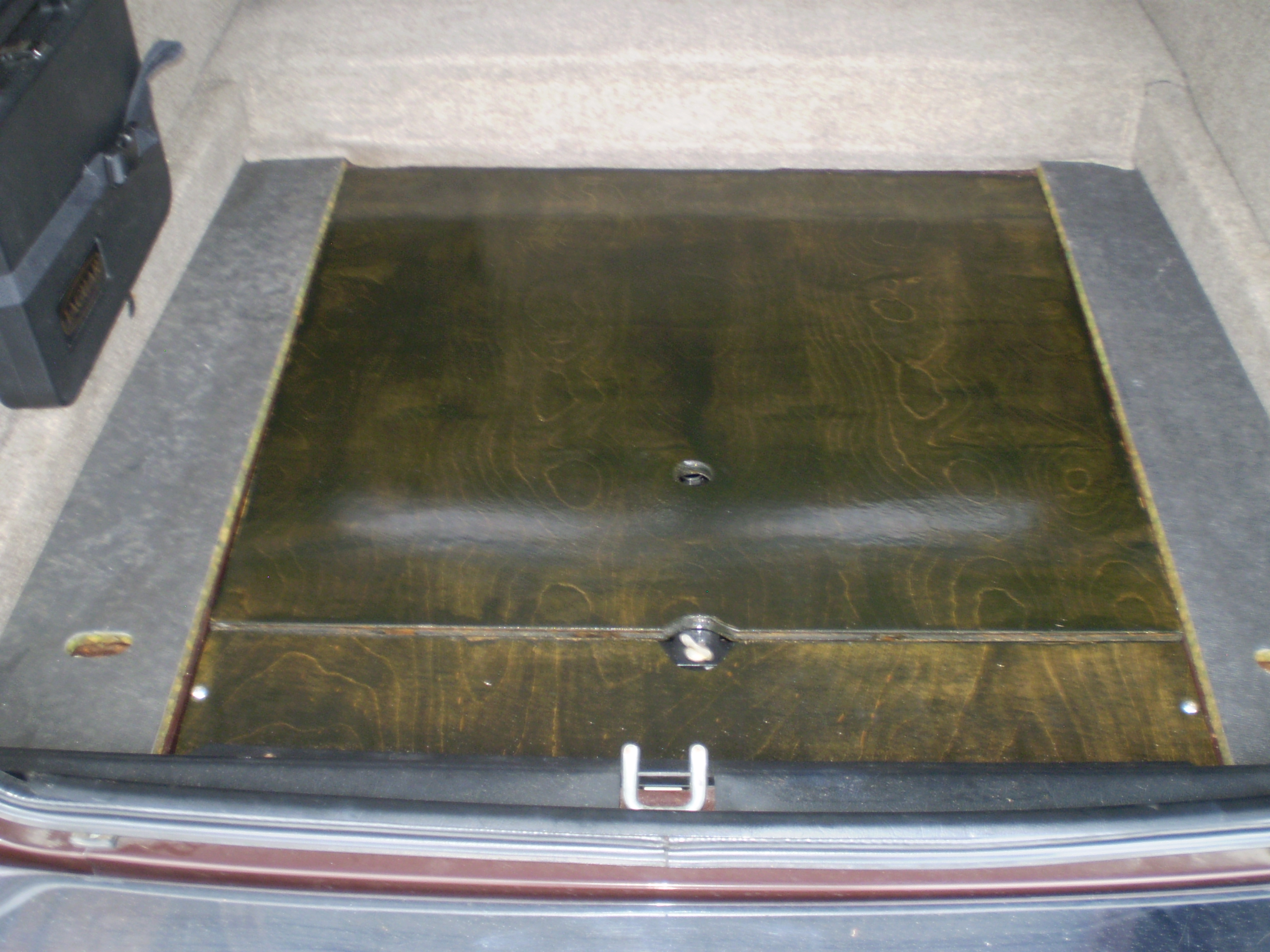

Old Jul 15, 2015 | 11:52 AM
Jose's Avatar
Posts: 9,139
Likes: 2,662

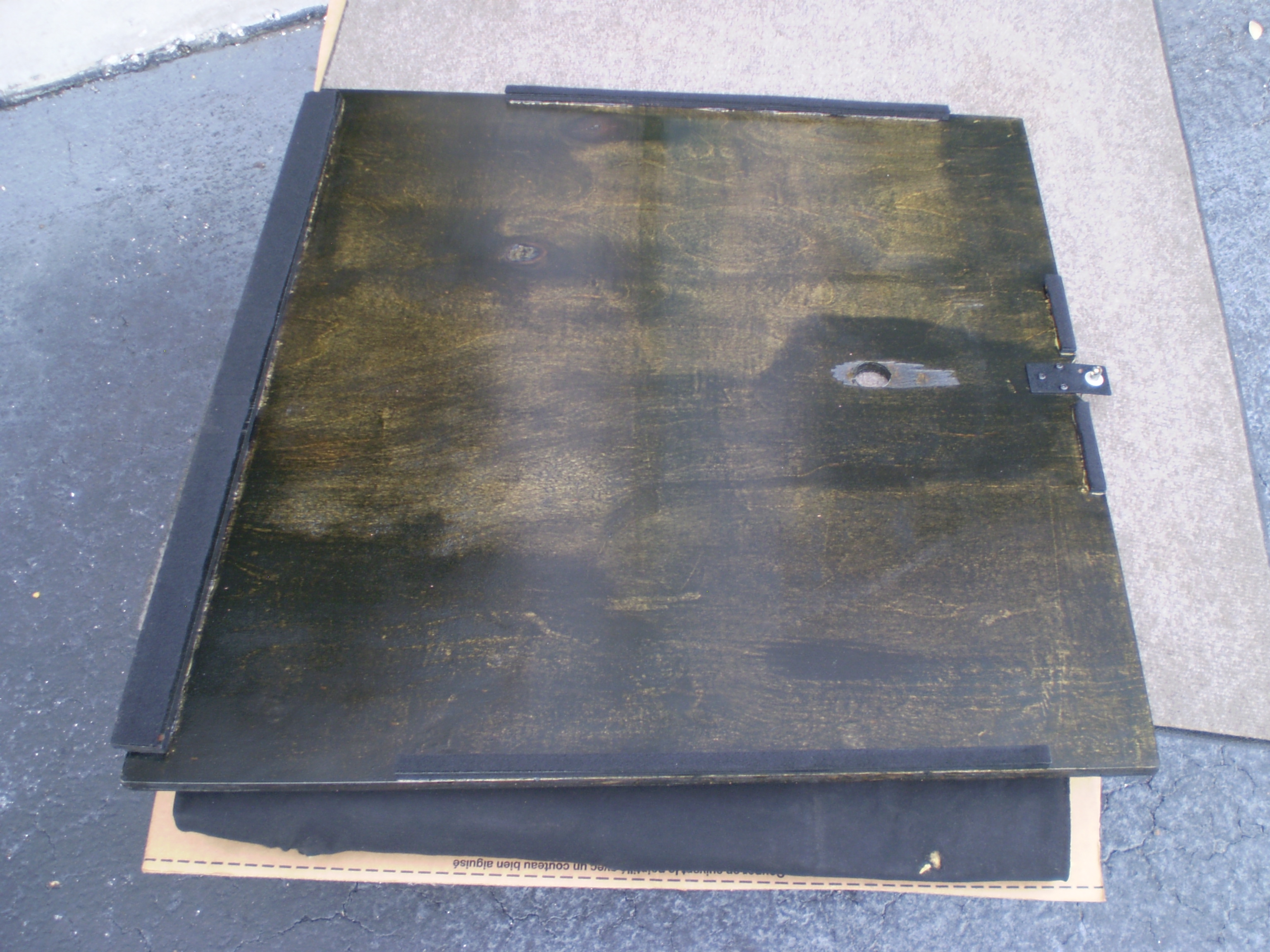

so I modified my spare tire with a modern X308 "donut" spare, and now there is room for the jack bag in there under the removable panel which I also modified.
David boger (Everyday XJ) found me the Series 2 holdown for the spare tire.
Why did I do that? because the original boot floor panels had become mushy and distorted, so I made the two panels out of solid wood, stained them in Black Forest stain and polyurethaned them, talk about picnic tables. the original material was some sort of pressed cardboard??
Attached Thumbnails Boot / Trunk Toolbox Strap Replacement-01-xj6-trunk-panel.jpg   Boot / Trunk Toolbox Strap Replacement-02-xj-6-trunk-panel.jpg   Boot / Trunk Toolbox Strap Replacement-03-xj-6-spare.jpg   Boot / Trunk Toolbox Strap Replacement-04-xj-6-foam-pad.jpg   Boot / Trunk Toolbox Strap Replacement-05-xj-6-carpet.jpg

here's an example of what I meant earlier, both the toolkit and jack bag, one on each side. This is someone else's car.
Attached Thumbnails Boot / Trunk Toolbox Strap Replacement-toolkit-jack-bag.jpg

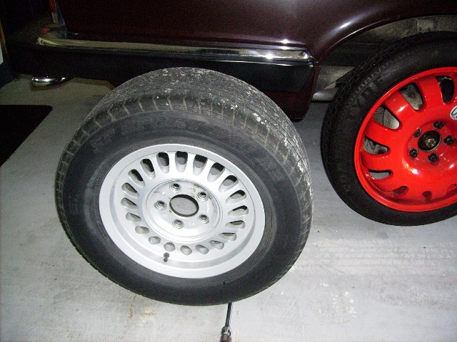

in my car I use 235/60/15 tires so a full size spare is too "tall" for the spare tire compartment. That is why I went with a "donut spare" from a modern XJ-6, leaves plenty of room for other stuff and the trunk floor panel closes flush as it should.
why carry a flat spare just to make it fit the spare tire compartment?
also a fully inflated (60 psi) donut spare weighs about half less than a full size spare.

any donut spare, from any Jaguar after 1995 will fit and do the job. They come with a heavy duty Pirelli Temporary Use tire and a very nice robust wheel, except it is a very loud orange color so you don't forget to replace it a.s.a.p.
Look in your local Craigslist for any Jaguar parts car and grab the first one you find.
very handy and easy to replace.
as to holding it down in place, your original Series 2 holdown can work if you add a bushing over the stud and a washer-spacer. But you really do not need a holdown.
