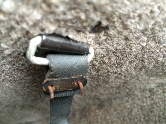

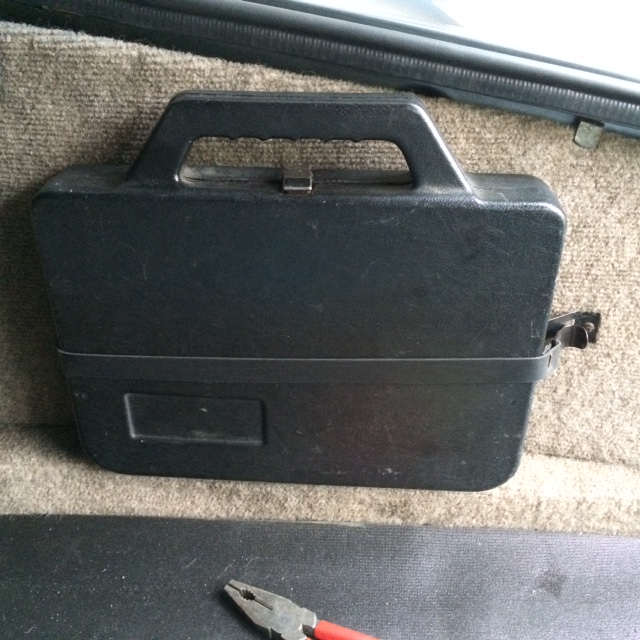

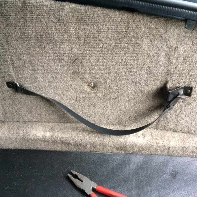

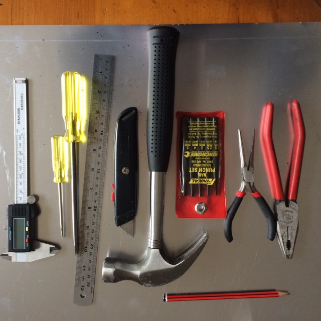

Hi Everyone,
Today is cold and a little wet in Melbourne and not conducive to going outside, so I have ticked off another item on my to do list with the xj6.
After 30 years the rubberized strap holding my toolbox to the boot wall wasn't holding very well.
So with about an hour and some tools at hand I fashioned a new one.
I sourced the strap from a rubber specialist in Clarke Rubber.
Closest match I could find was 1.5mm x 25mm (1 Inch) Neoprene weather strip for the princely sum of $3.15 / metre (yard)
From my measurements, I needed a width of 20mm or 3/4 Inch to fit in the existing buckles. This was done by carefully trimming about 5mm off one edge of the strip.
The length worked out at 46cm or 18 Inches, but this isn't critical as you can play around with the overlap on each end a little.
I used a small flat bladed screwdriver to carefully pries open the staples at each end and work the old rubber off being careful to not lose the tab sitting under the staple on each end.
I used a 3mm hole punch to create the holes in the new material and basically reassembled the staples, tabs and strap.
The space between the holes was 124mm
The only fiddly bit was the assembly on the boot wall, as I didn't remove the trim and found getting the right angle and pressure to close that staple was tricky, however, I believe it was still easier than removing the trim.
I have uploaded some photos to document this.
An easy fix and hopefully of use to someone else on the forum

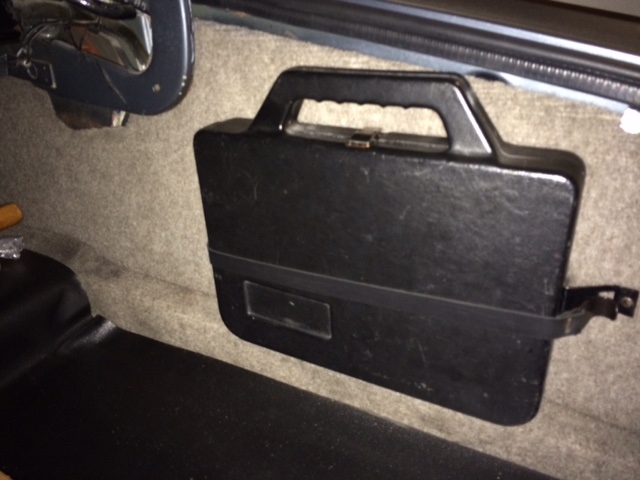

Hi Jose,
Mine was a rubberized material on or over a webbed strengthening material which had hardened and was crumbling with age.
It had obviously stretched over time and no longer held the toolbox in without wedging something else between toolbox and wall panel to take up the slack (at least I had somewhere to keep the owners document wallet).
There was no way of adjusting the strap as the buckles were fixed with staples.
The cloth strap on the other side which holds the jack is adjustable, not sure if you are confusing the two?
Then again, from memory, the toolkit was a sometimes available option on US spec'ed cars, so maybe the fastening straps differ in your market?

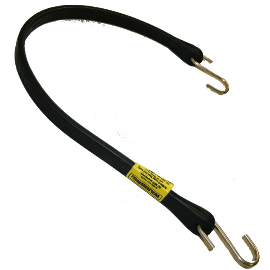

good question Nigel and others...
I think it depended on the destination of the cars, if the toolkit was included or not.
if you are talking about an elastic black rubber strap with two "S" hooks, one hook at each end, we can get those in the US at autoparts stores for a few dollars, they come in many sizes, from very short to very long. They are used in pickup trucks to keep things from moving.
I am not talking about "Bungy Cords", those are different, I am talking about a flat, black rubber, elastic strap with a "S shaped hook on each end, but no adjusting feature like the ones in Nigel's pictures, but which could be used as a replacement.
see picture
see picture

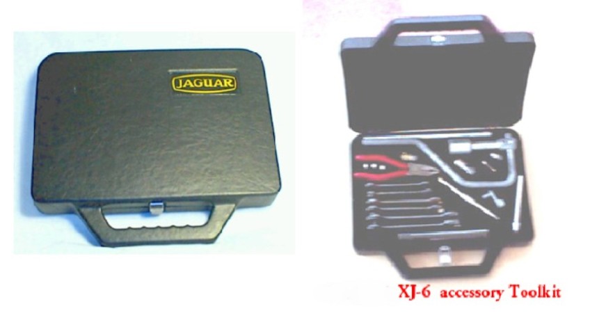

The jack bags were made of a material called "Hardura", a black thick vinyl bag with cloth strings at one end which eventually rot / dry out and one day break when you tighten them.
I'm sure David at Everyday XJ has a few of those, but I don't know if the jacks are the same from the Series 2 to the 3.
