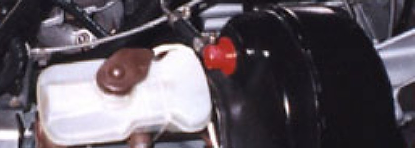

I wonder if the metal of the hood is coming in contact with one of the wire terminals, the cap should have a rubber cover over it.
Also, if you disconnect one of the cap's wires, does the light go off?
