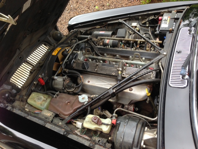

I have a 1984 XJ6 Vanden Plas . It has been garaged and not registered for a few years. I take it out once or twice a month and drive it around my neighborhood secluded street. I check all the electrical components, turn the radio on and off making sure the antenna raises and lowers, switch the gas tanks, raise and lower the windows just checking stuff and recently noticed a smell after applying the brakes. There doesnt appear to be any fluid where I park it . The pedal does not go to the floor if i apply pressure and the brakes work albeit a little soft. Although I am careful not to stress the system. I have not bled the system and am worried I may have a seal problem in the master cylinder.
What are some of the reasons that I detect a burning brake smell after driving a short distance?
