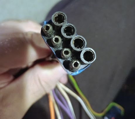

Default Breakout Plug to Shelf Switches
This plug conveys connections from the console area up into the switches in front of the heater/ac unit, yet following some notes and colour codes as well as the logic of what is normally seated in this space some of the wires on the plug seems wildly unrelated to the logic of the switches you'd find there. picture of the switch and a sample of the type of switches. Here's what the colours tell me:Left Top
Purple with Green-s [Purple/ Green Fuse to hazard flasher]
Red White-s [panel light switch or fibre optic source]
Straight White [White Ignition switch or starter solenoid to ballast resistor]
White Black-s [White/ Black breaker, or distributor side of coil, demister ]
Lower Left
White Black-s [White/ Black breaker, or distributor side of coil , demister]
Light Green with Orange-s [Green/ Orange Low fuel level switch to warning light]
Purple with White-S [Purple/ White Interior lights to switch]
Straight Purple [Purple Accessories fed direct from battery via fuse]
From memory it had things like demister for back window, heater, map light, cab light override, stuff like that.
