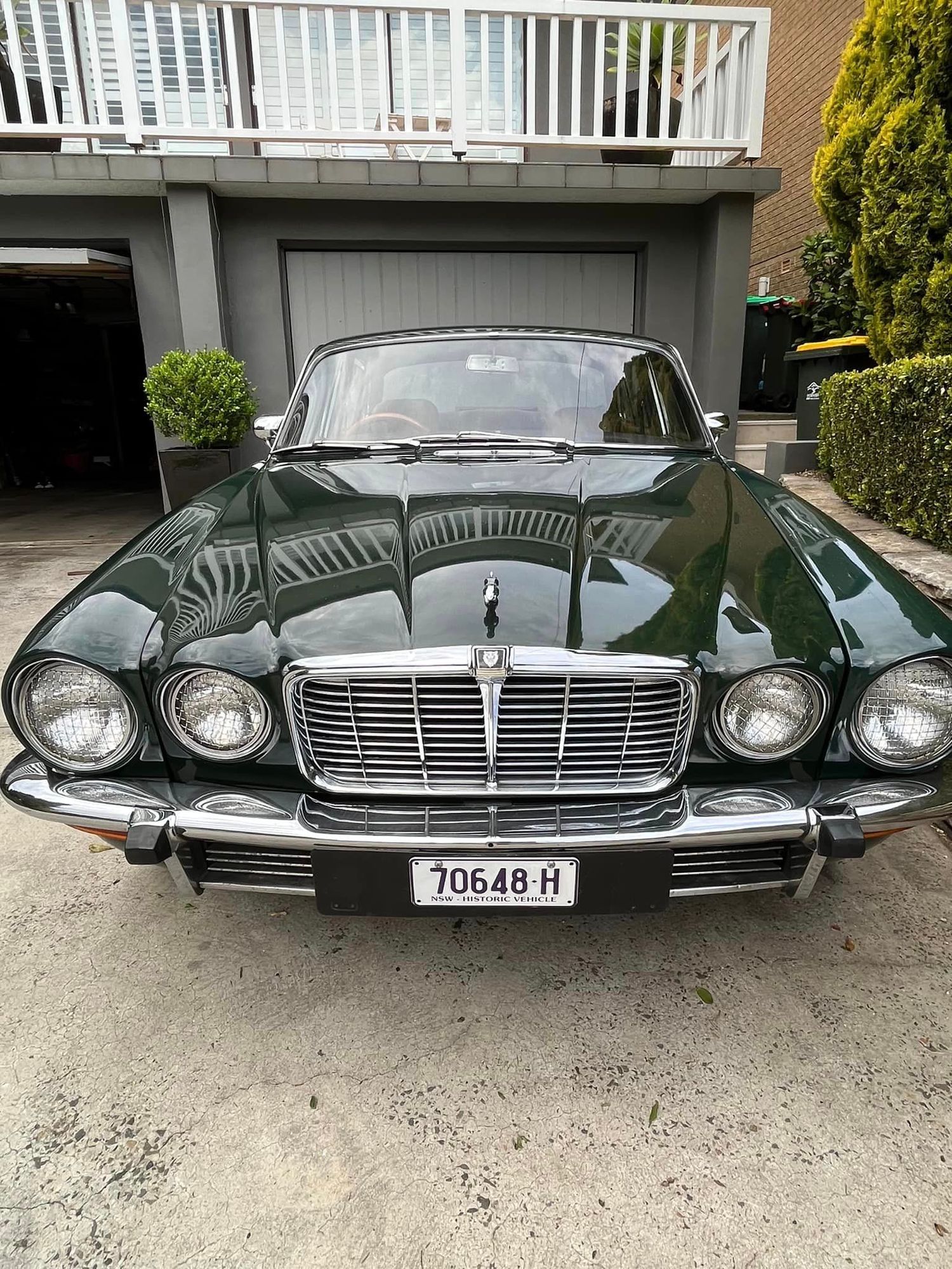

Just getting stuck into me new car british racing green series 2, 1979. Apart from noisy tappets and a smokey exhaust on throttle.....first three cylinders (from the front) dont seem to be doing much. got the air filter opff the carbs and on throttle the piston on the rear carb is much more responsive and jumpy....checked piston damper oil looks like same amount in both carbs. Is this a sign of poor adjustment on my carbs , or the front three cylinder compression is down? Pic below
