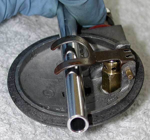

The carbs need to be updated to use today's fuel and also install check valves to shut off the gas flow to the carbs. I did this to mine and it really made a big difference. Make sure that the throttle shafts are line bored and sealed well, too. Also use starting fluid spray in the can to check for vacuum leaks on the shafts and vacuum lines. The engine will speed up if there are vacuum leaks.
Not my project but a good read.
https://xkeresto.wordpress.com/page/2/
Ball Valve Grose jets, with Viton seals.

I had the same trouble for awhile: I got so tired of pulling those carbies. You may have some fuel pump issue -- I don't know about that as my pumps are stock -- but I had to do all three classic things to stop the leaking: change valve in float chamber, change diaphragm, and put on new gaskets. Got the kits from Joe Curto in NY. If you did all that then, yes, maybe there is some pump issue

I had this exact problem with my HS8 SUs on my '73 XJ6. Replacing the Needle Valve sorted the problem. Just be careful with replacement carb parts. On the HS8 at least, the replacement Needle Valve didn't need a crush washer, where the original parts did. This meant that initial replacement didn't initially work. Once the crush washers were removed all was good.
