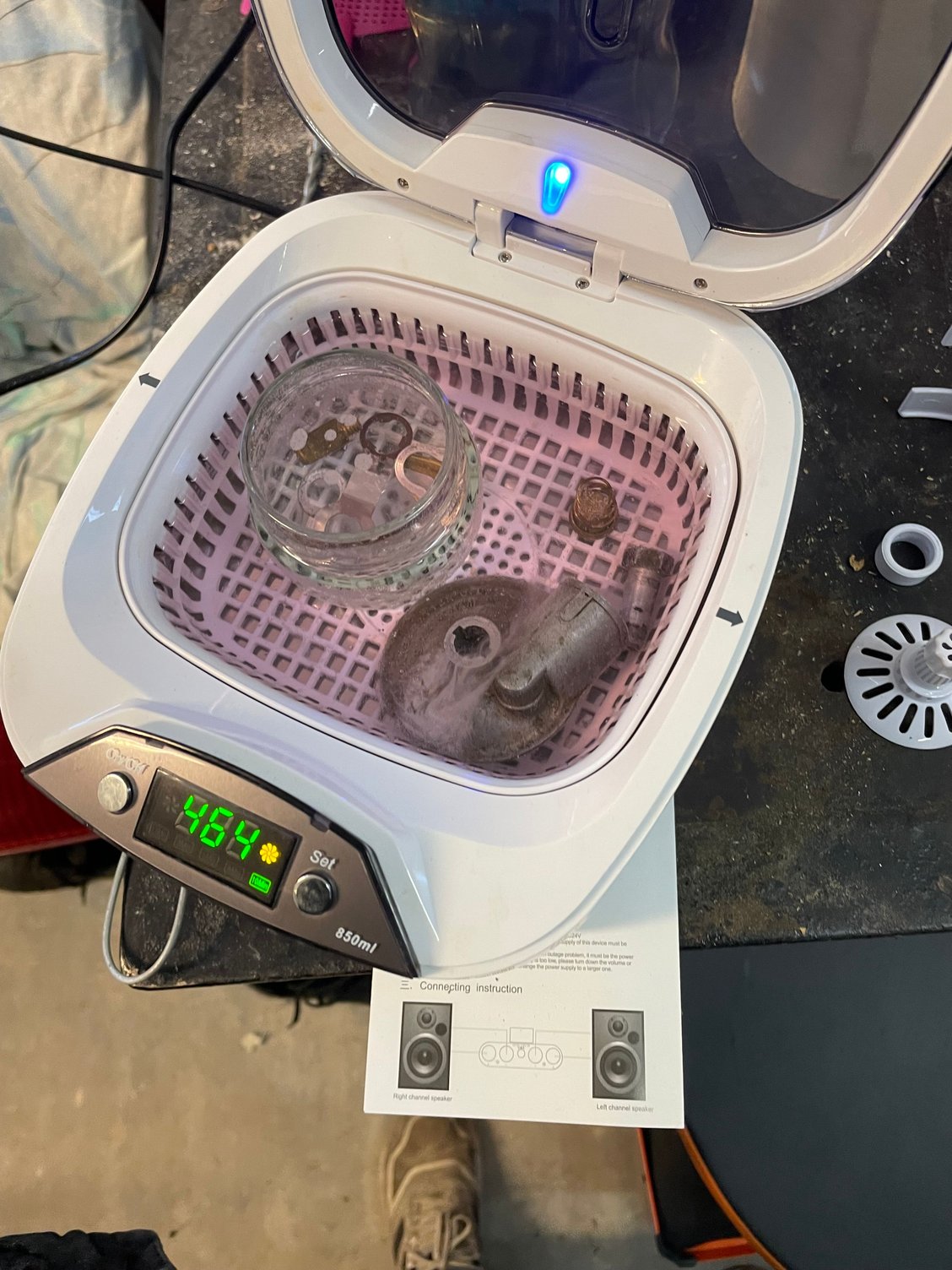

As I had my hopes up for inspection, it seems as if my car had other plans..
when trying to start it this weekend, I was met with a carburetor pissing on the floor.
when i finally got it started we went to fuel it up but it died on the way, got it started, but had to pump the gas all the way to the gas station.
after taking apart the float housing and giving it a run in the ultra sound washer and a bit of adjusting, no more pissing and the car doesn’t die on me anymore!
I also replaced the blinker seal, positive battery cable, fixed the lock to the right fuel tank, reinstalled the pipe from air filter to the engine (I don’t exactly know what it does or what part in the engine it is for) and fixed a brake-line that was rubbing.
